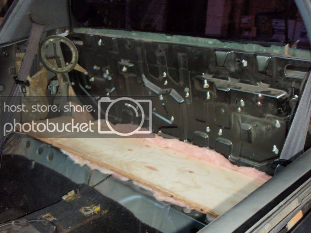

So i took some measurements to put a ported sub woofer box behind the seats in the Del sol. i stripped everything out and theres actually alot of room to put a nice box for my Fi 12.
Width up to 39"
Top depth 8"
Bottom depth 11.5"
Height 17"

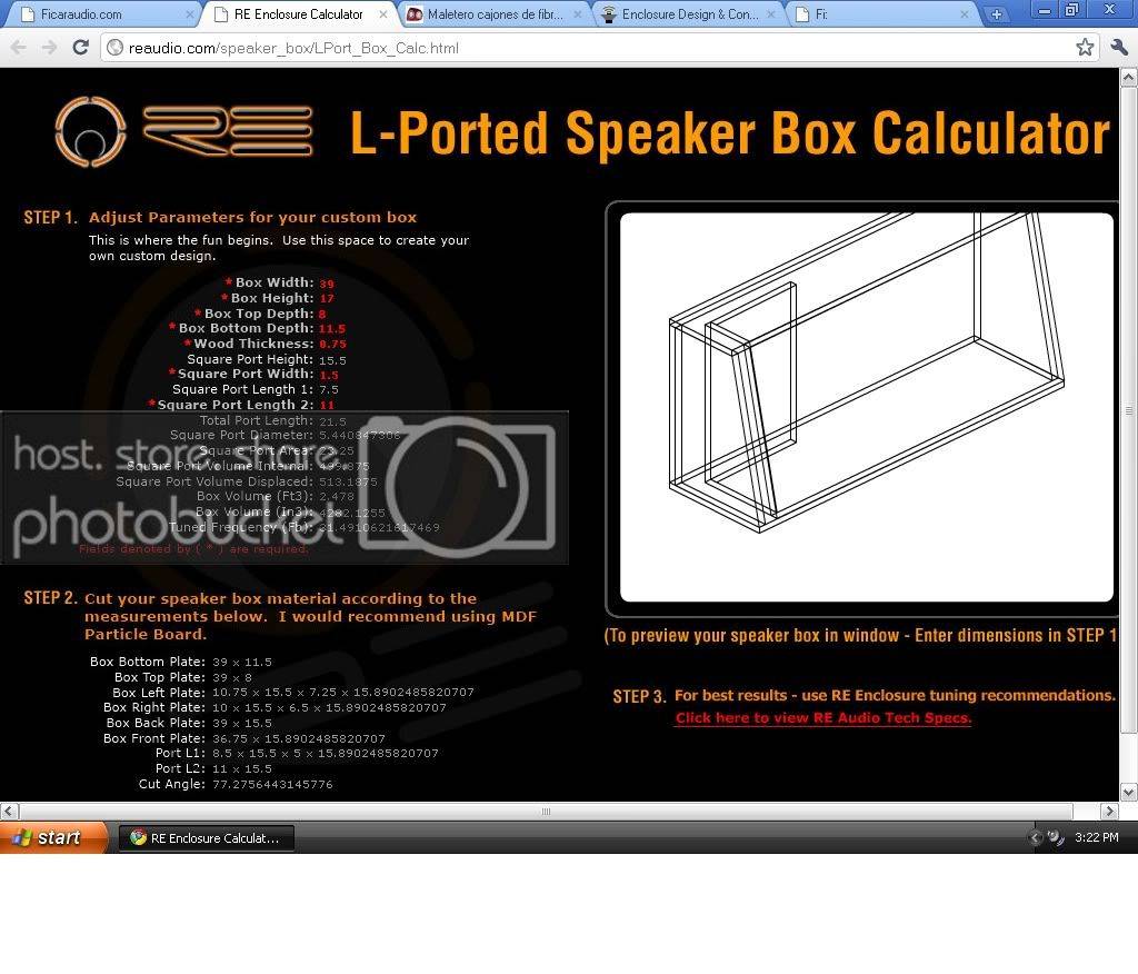

i used re cacluator to get...
1. 2.5 cubic feet (2.3 after sub displacment)
2. tuned to 31hz
Does everything look good?
Should i make a slot port or use port tubes?? what size should the width of the port be?
