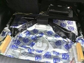

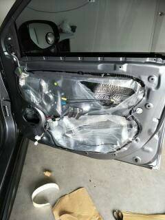

There are also different types of sound deadening,  There's a bitumen based like sticky tar ones like Dynamat then you have a new sticky foam ones you can get as well.   You can used them both, I have used the bitumen one in the inner curved panel of the car door and inside as well to seal the access holes. I then applied the foam one over the bitumen based one sparingly.
Would be a good idea to keep the stock plastic cover as it protects rain water seeping in.  Also a good idea to re-use the speaker adapters / and rear speaker plastic shielding for water damage.  Also re-use the thin foam surround they have around the stock speakers as they all help in achieving better 'mid-bass' up front.
You don't have to cover the whole door, just use it sparingly but 'knock' on the panel to check no ringing is present.   Hope this helps you out mate!

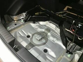

Oh, the pics I posted was doing a false floor hence the 4x2 timber that was added with 'liquid nails' and then plywood attached over it.
