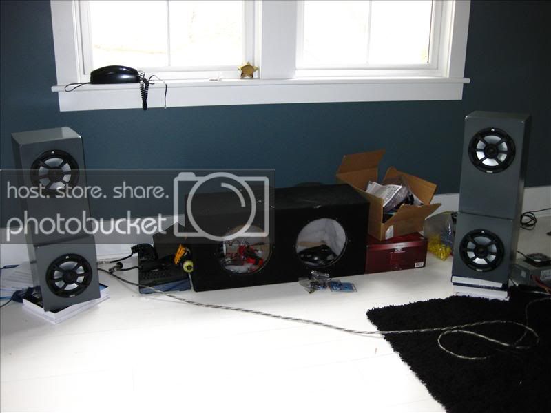

Car audio in my room..

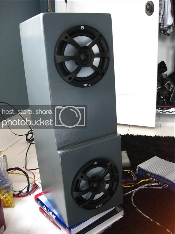

Dmm reads 11.89v, and with the gains set, i can get average of ~70ish per side out of my old pioneer amp and a 200w psu... It's been going like that for a while with the speakers on the floor. I have them in the box and they sound amazing.

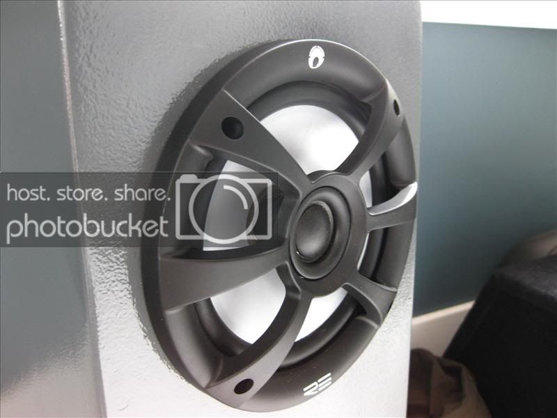

They play down to 40hz with authority, it would be a lot better if i had about 160w per side though haha... each box is ~.2cubes stuffed with poly. I'll post some pics of in a lil while of them.

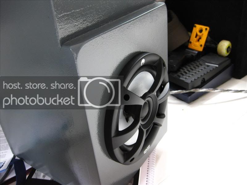

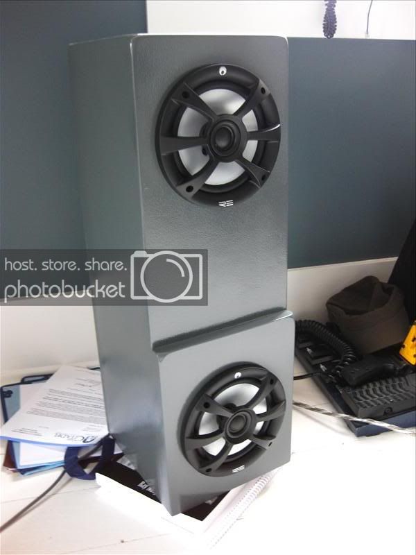

Heres an update with the speakers in. I'm gonna get some dowel rods and make legs for them, probably 2 feet tall.

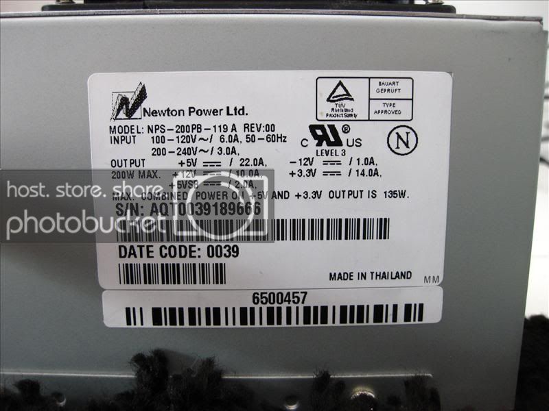

This is the psu im using right now for the highs.
How are you going to turn on/off the sound system?
As of now, just plug and unplug the psu, when i build a rack for the amps and psu's, im just going to put a switch in the psu's turn on (the green wire). I'll mount it to the outside and put both psu's on the same switch, so everything will come on and off at the same time.
