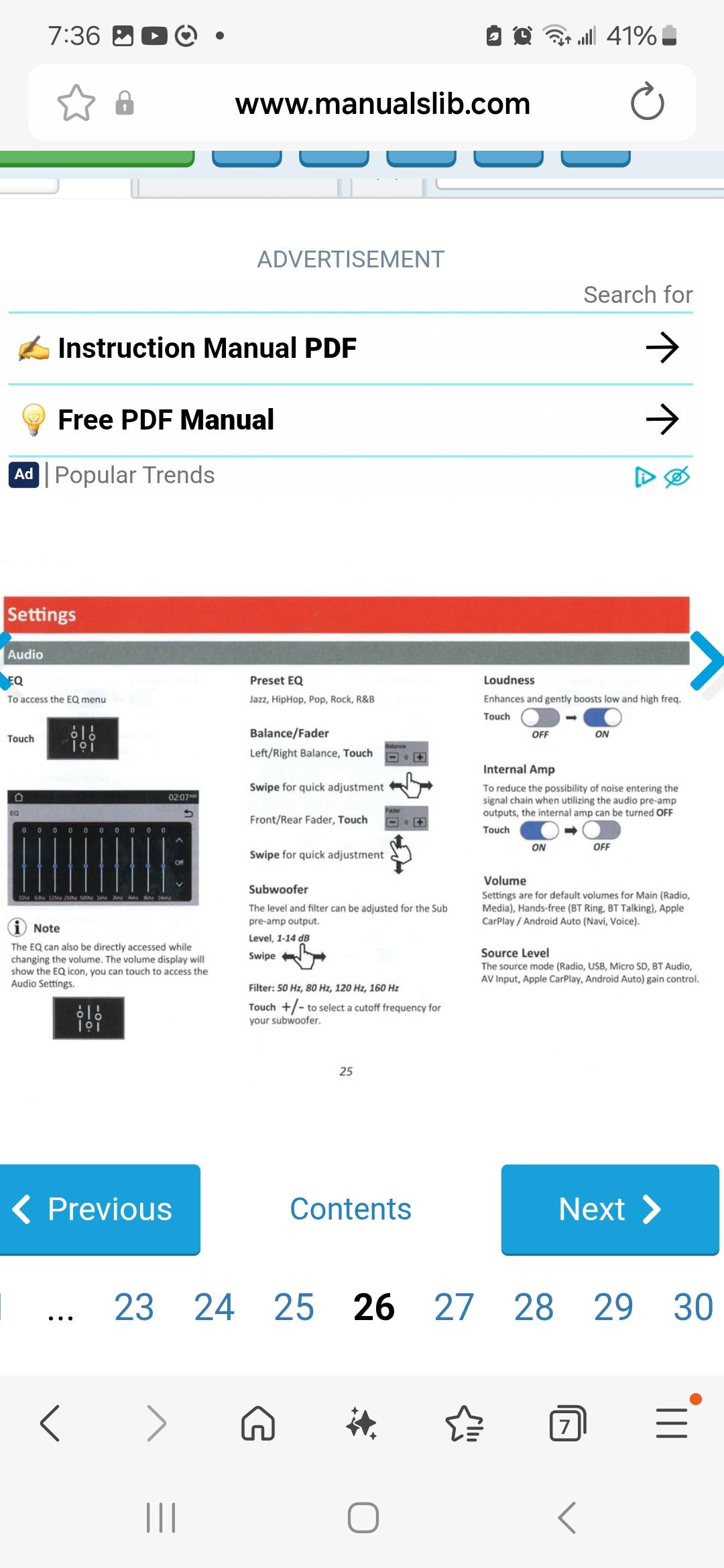

Double check in your settings that your internal amp is set to on
And double check 15 amp fuse in back of headunit it self for good measure
Although I suspect if that went you shouldn't have power to the unit as well 🤷‍♂️
I dont have the headunit plugged in, I was recommended to unplug the add a fuse that was controlling the headunit to to turn on and off with the car. Although, before I unpluged the headunit it actively turned on and off with the car just had the car had 0 audio output from chimes and the headunit.

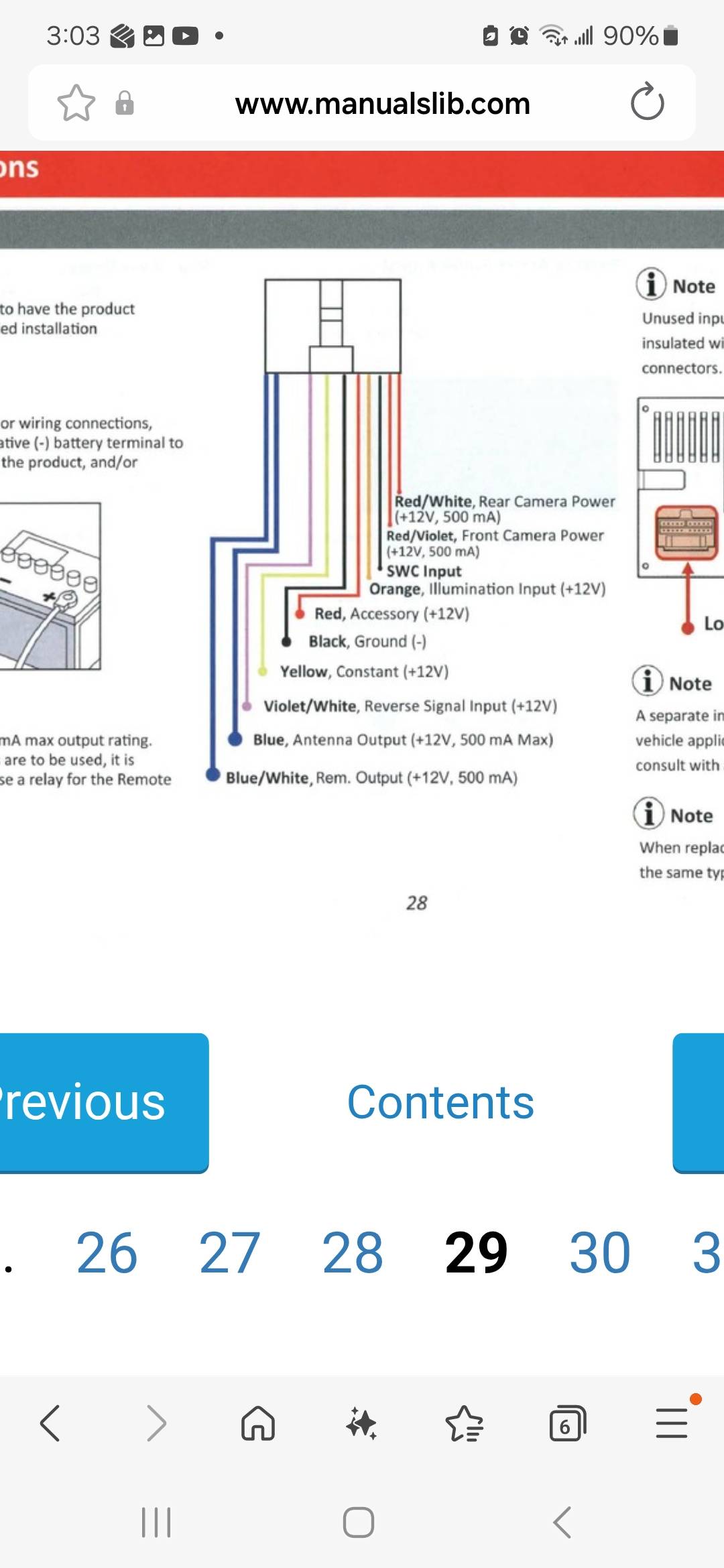

Don't you already have a remote wire that you were using for an amp?
Use that for your head unit trigger
Then find the remote out on back of headunit (blue wire)
And run that to the amplifier?

Are you saying like splice the remote wire for my sub and my headhunit together? if so that was my plan to do once I managed to regain chimes and sound. My goal has been to try and regain chimes just so I know that my system isint entirely messed up then splice together them into the same add a fuse so that I only have 1 add a fuse and I dont mess up the system. I'm just stuck on the whole regaining chimes without any extra accessories part.
Take the remote wire that's coming out of fuse panel cut it to length to reach back of head unit run it to the red wire
Accessories wire on head unit
Then connect the blue/white wire (remote out) on back of head unit to the amp
That will trigger the amp on when your head unit turns on
My sonic does not have a remote out wire, this is why I was wiring to the fuse box in the first place.
