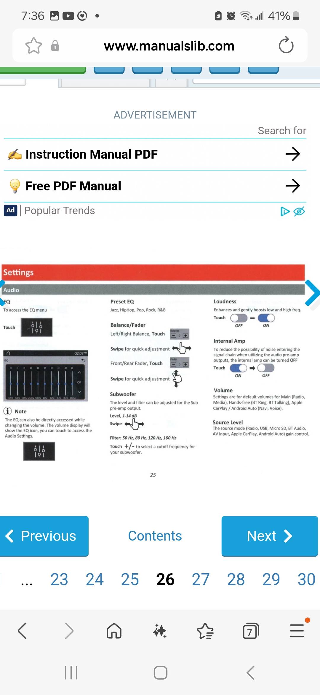

If that fuse in back of head unit is for the built in amplifier then you won't have sound cause no amplifier = no sound
Also there is a setting in your deck to turn the built in amplifier on and off
If that's off that means no amplifier no sound
Not sure why it would mysteriously just go to off
But because the feature is there and your audio went silent it's something you will need to confirm
Regardless
That's the menu you need to be in to confirm it's on
"Internal amplifier"

It powered up fine but you had no audio
Regardless
