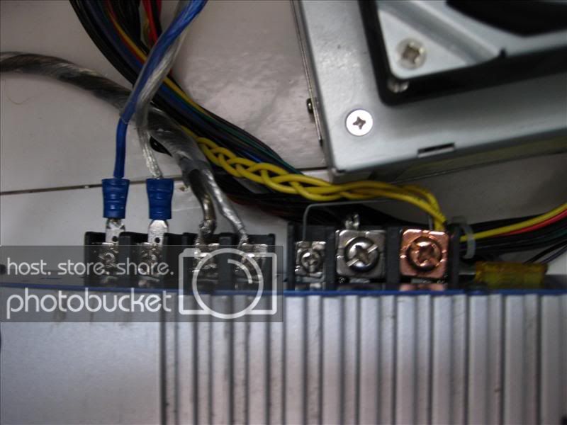

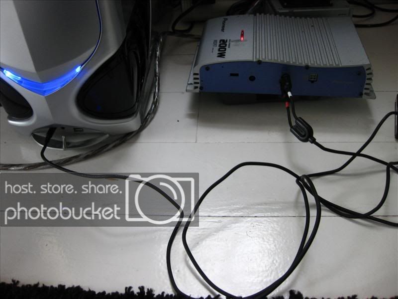

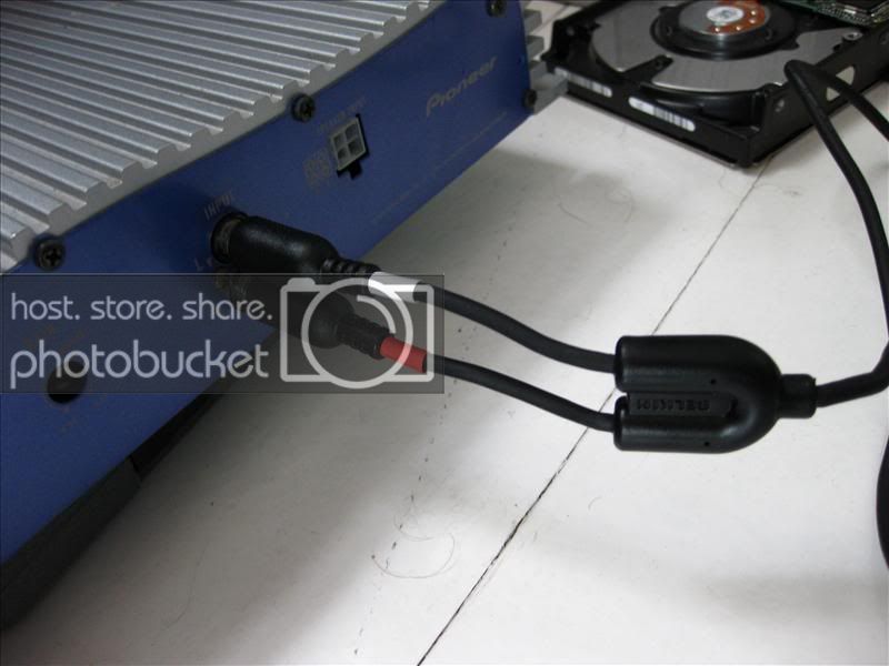

where did you hook the psu up to the amp? and how does the music get to the speakers rca to headphones? im curious i wanna try this.
Yellow wires to the + black to the - on your amp, headphone to left and right RCA for the source. I use my computer and it sounds pretty good.
this may sound stupid but could you post a pic of how you get the signal to the amp? I plan on doing somthing similar with stuff I have laying around I just haven't figured out how to get signal from the comp to the amp

Right now, just a little belkin headphone to RCA adapter. Heres some pics, and a pic of the psu to amp and anyone wanted to see.

2 more question before i give it a shot. did you use all your black wires from the psu? on my psu i have quite a few of them and in your pics it doesn't seem like you have too many. if you wanna explain how to series psu's together that would be awesome, if not its cool too. im gonna do more lookin around.
put all blacks together on both powersupplies and all postives together on both power supplies, but live 1 positive out for the remote and your good to go.

Haha nice. And to YeahToast, you could wire them up in series, but it would run everything at 24v not 12v lol... bad idea. if you wire two up, make sure they're very close in voltage ratings with a dmm and that they put out the same amperage... otherwise, one might go up in smoke lol... good luck man.
Been running mine for months now, never had a problem.
