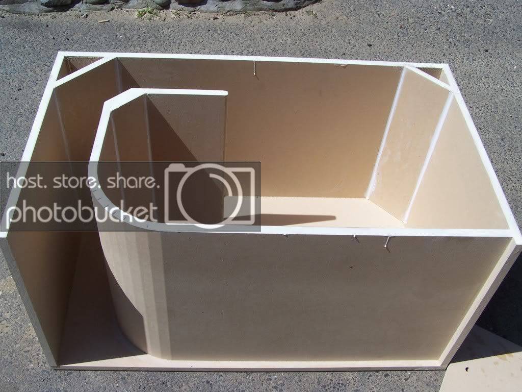

i was bored yesterday so i made this......
sinosic
Idyllic Enclosures
i spread the glue to insure max bond.

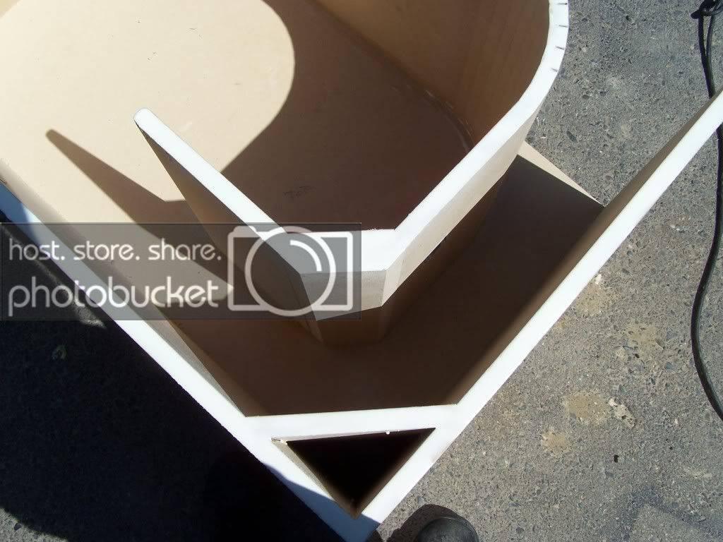

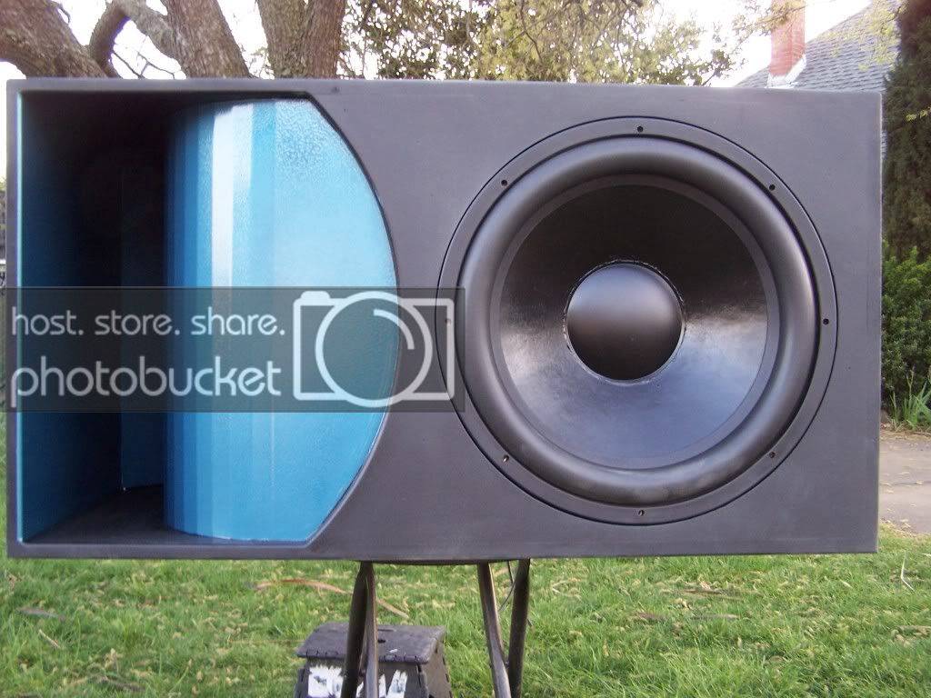

picture of the port bend

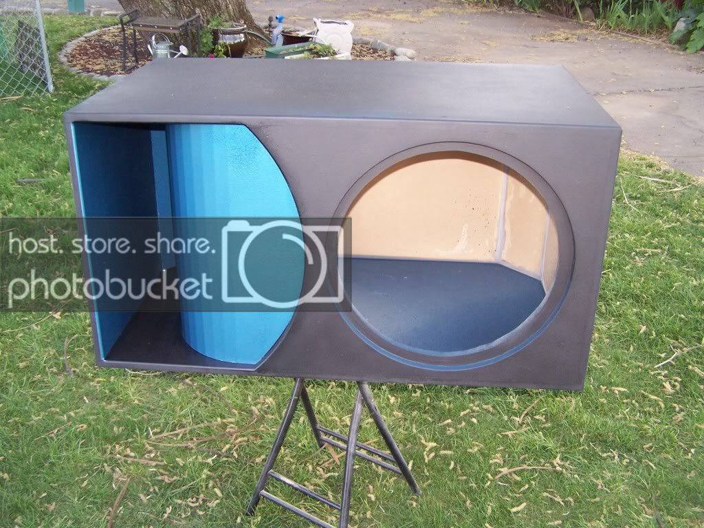

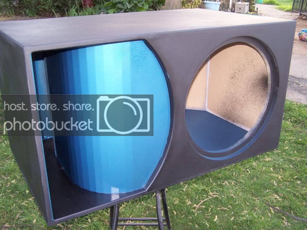

after the truckbed liner and port painted. needs a sub.....

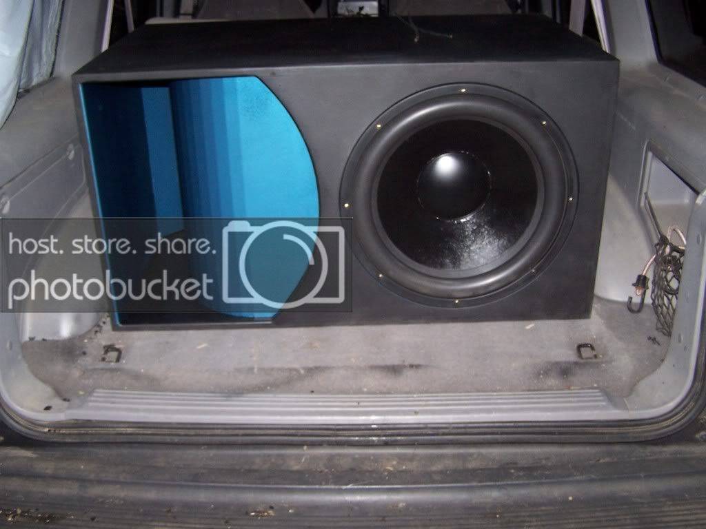

i just happen to have a 18" sub that forevrbumpn made for me that needed a home
sub and enclosure in back of my explorer.
alittle over 8 cuft after displacements tuned @ 31hz
the amp i will be using is a modded mtx 1501d @ 1ohm
whatcha think?

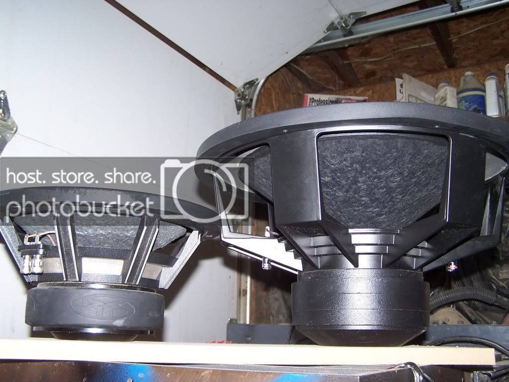

specs on the 18" sub..... it has a cadance beast master motor. 1000 watts rms dvc 2ohm
a friend made it for me.
heres a picture of the sub next to a 12" hx2
