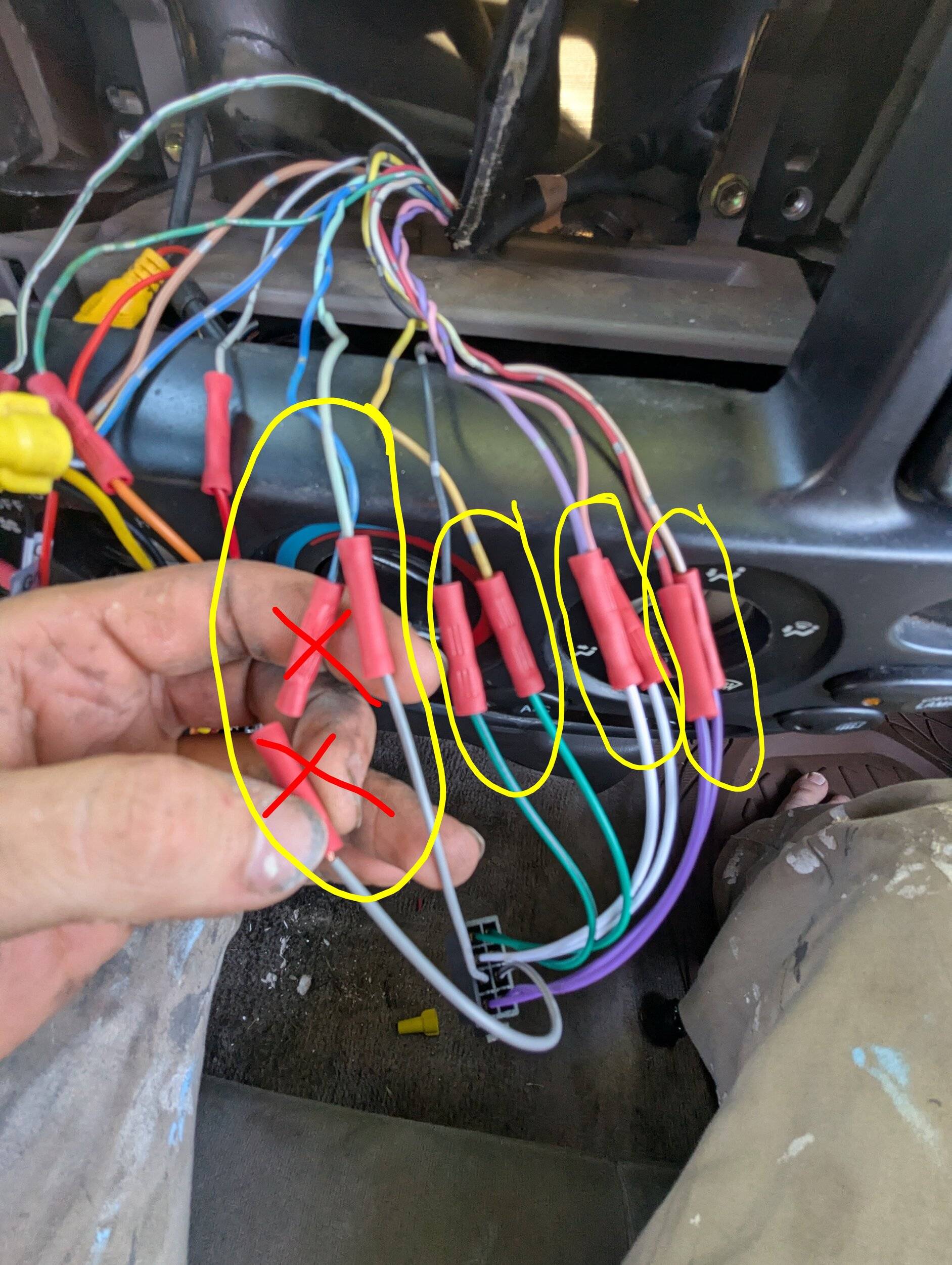

Just swapped out the head unit. I'm no expert but I don't think there's any bass
Simple answer is to bypass the OEM wiring. I wonder if the OEM stereo used a chassis ground for the speakers and that's causing you grief.
This could be it. There's a negative truck speaker wire that if you touch it to any of the radio speaker wires everything goes silent. And sound plays with only the positive wire as in you don't need both the negative and the positive to make the speaker work. And if I don't ground that negative wire the speaker creates a whining noise.
That's your issue. You need to run wires straight from your HU to the speakers.

These are the four speaker pairs. The pair that is circled worked with just one wire and the wire exed out is the one that is grounded and when touched to each other all the speakers go dead
