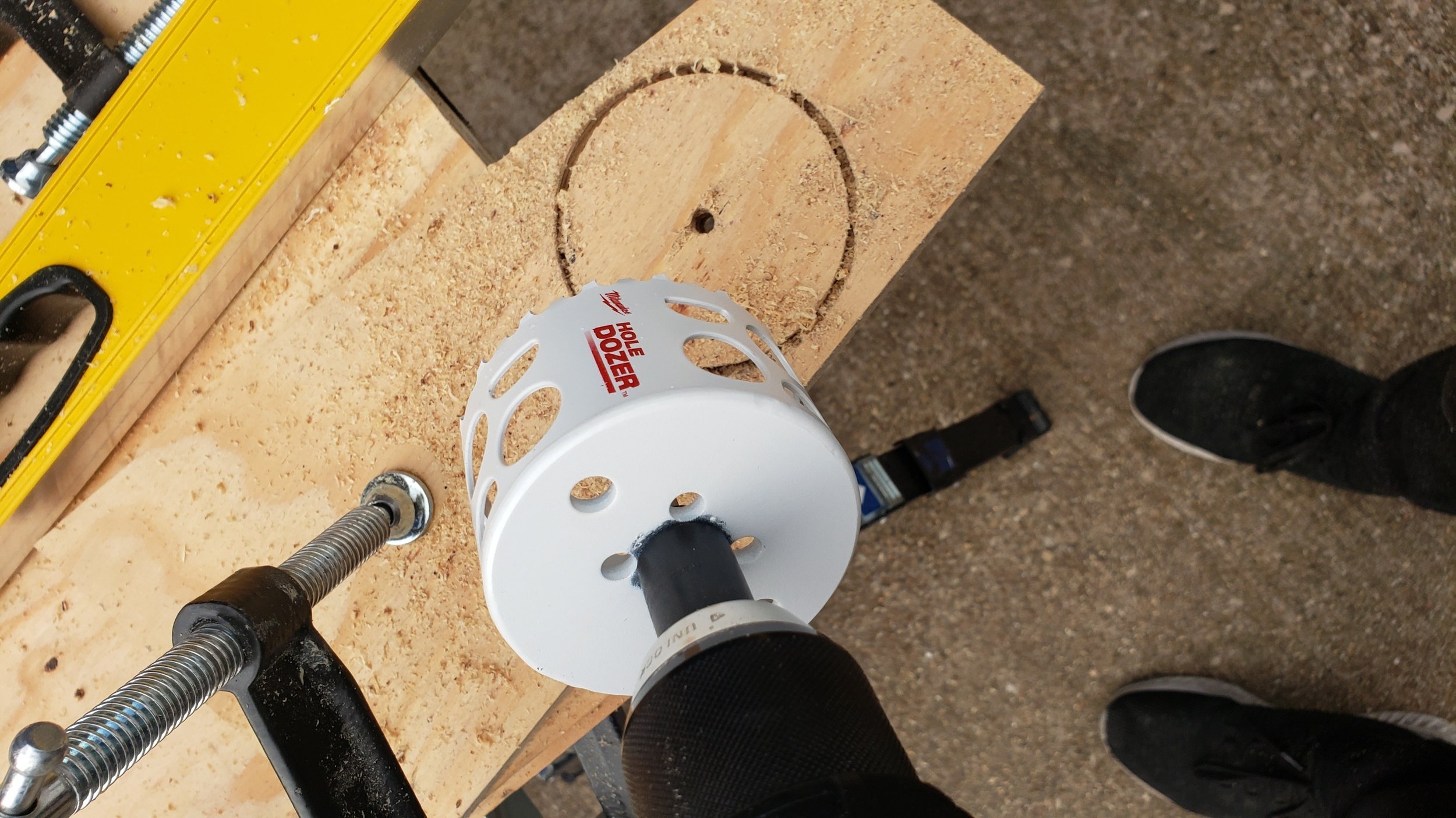

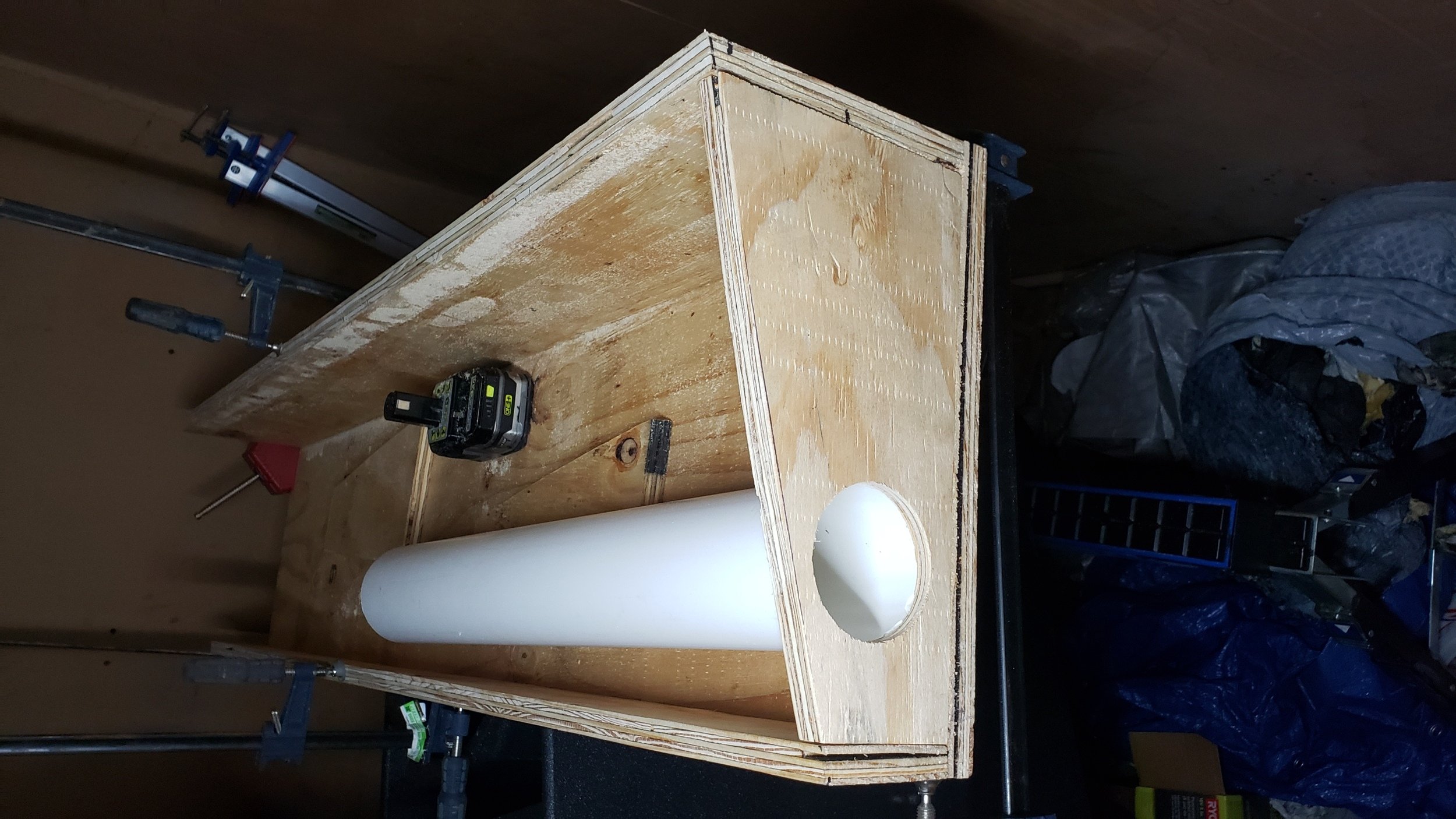

Ok, I see the bottom part wasn't cut yet for the hump. I started the box using some cheap plywood that needs attention. I'm just test fitting right now. It will be dual chamber with a port on each side. I'm no stranger to box building and can't see paying someone to do it for me. This box is for 4 6.5s. It is 8.25 in the front and 55" width.

So, what 6-½'s did you go with?

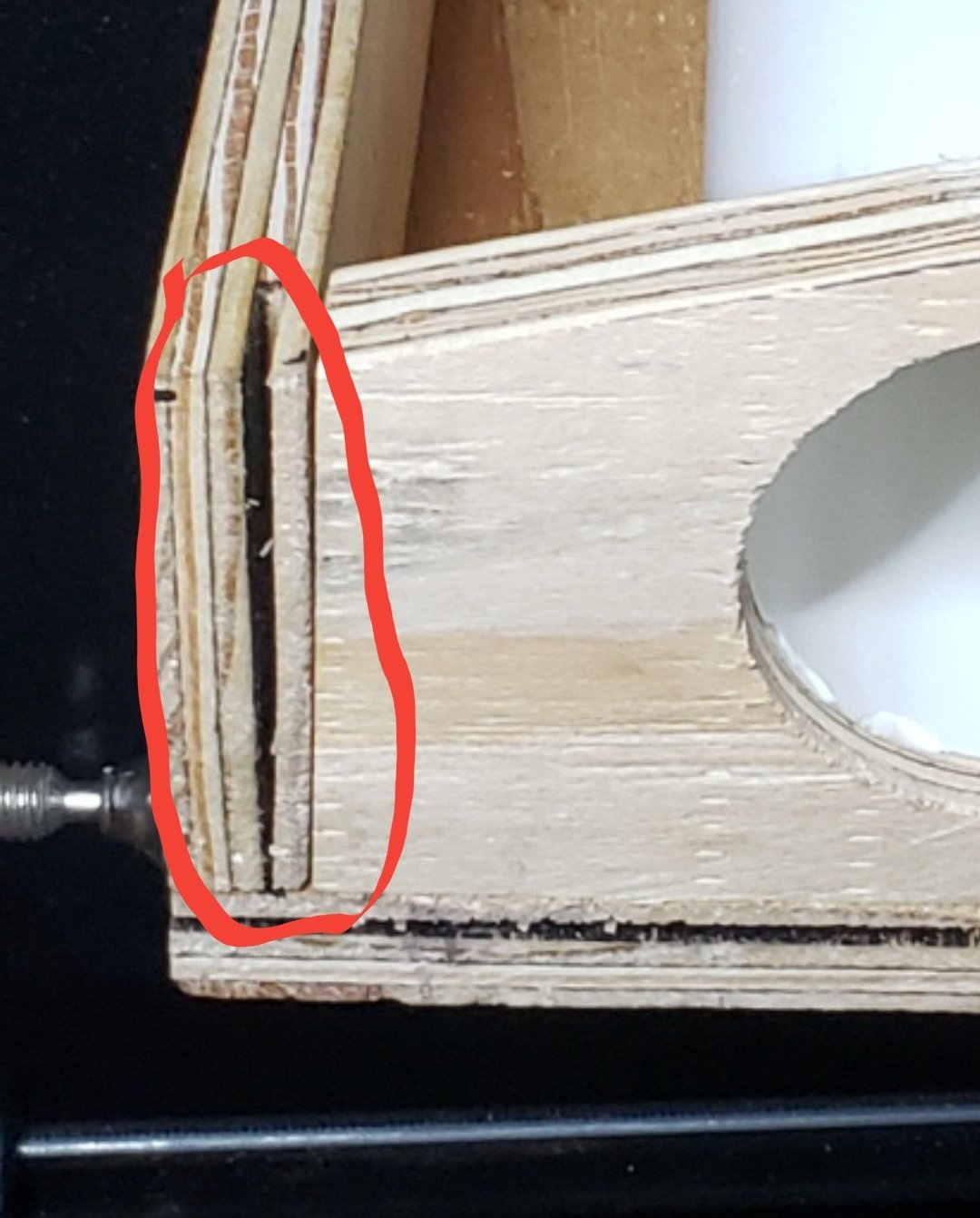

You might want to silicone the inside of that box. That "Birch" that you are using is kind of a pain in the azz to work with. Are you going to pre-drill holes and screw the box together?

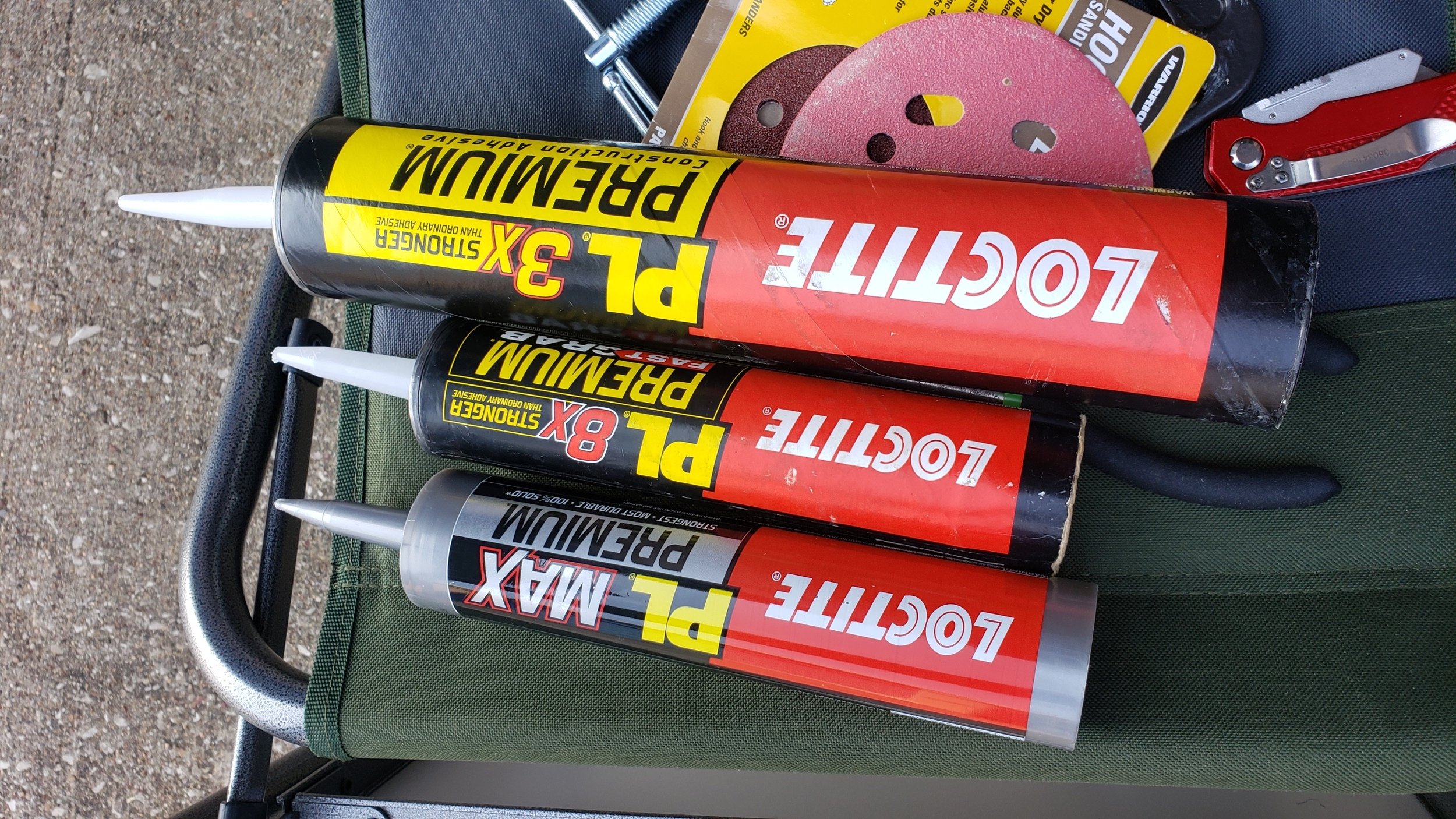

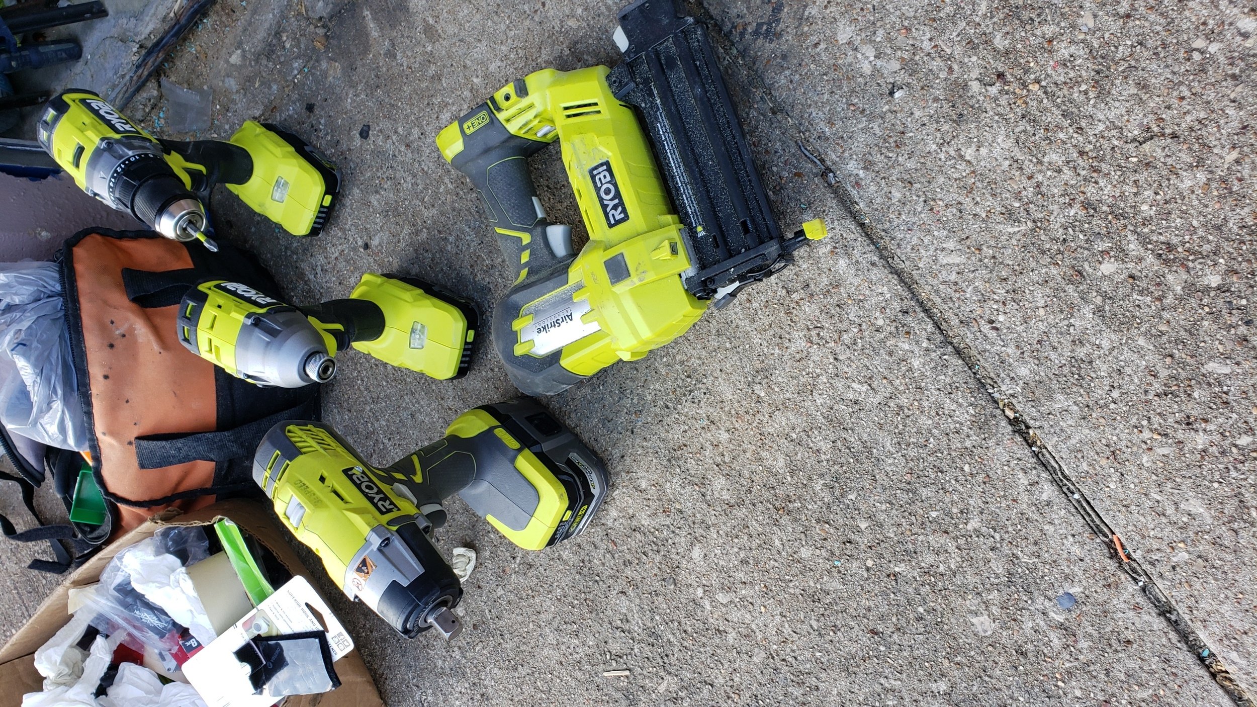

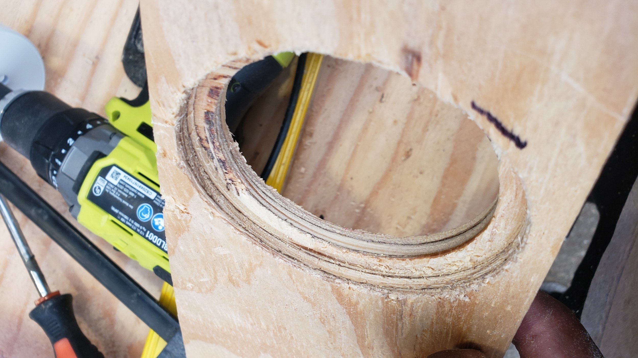

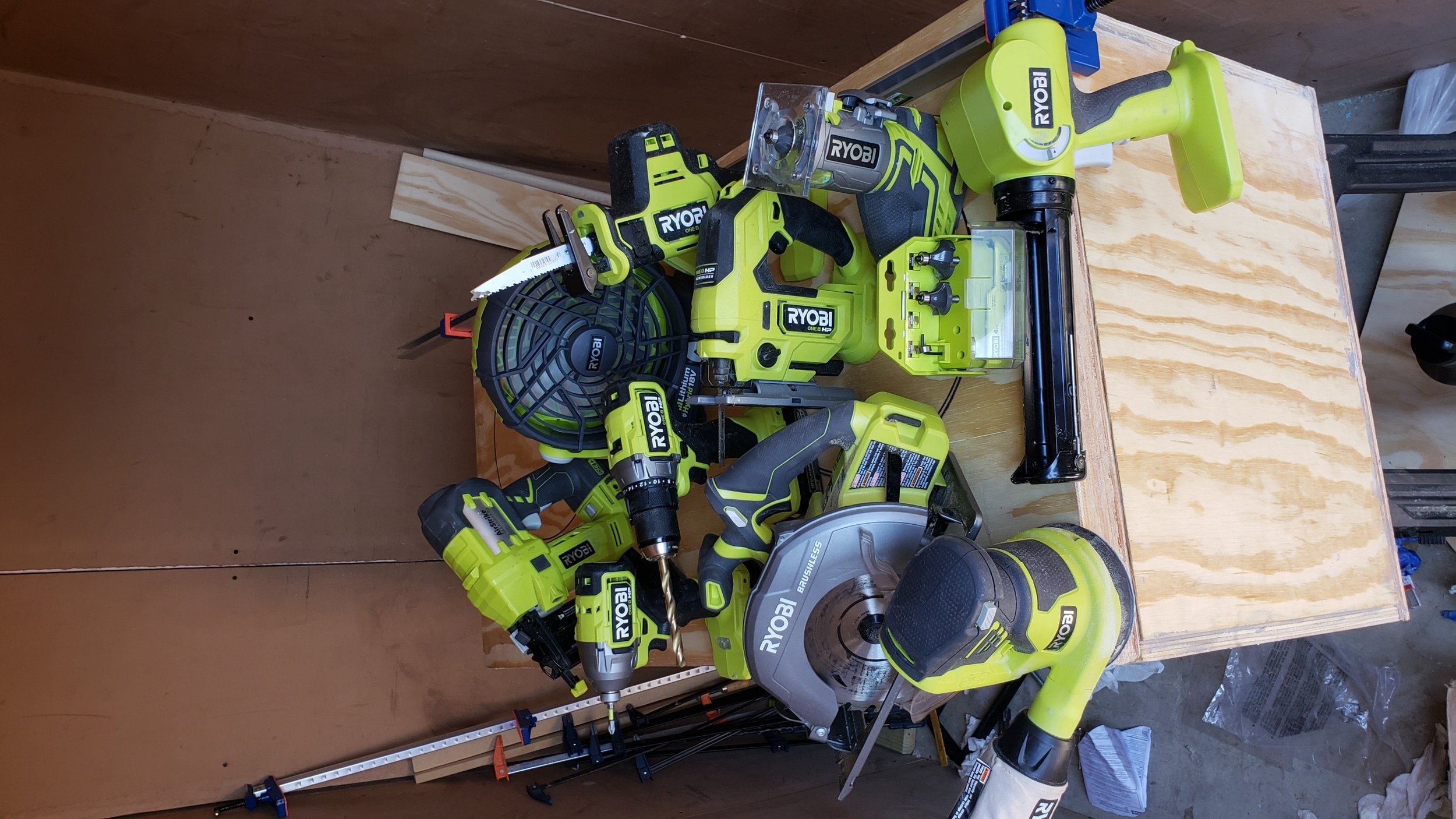

I know how to fix what you circled. I'm making the box for someone else. Audio Legion 6.5 s25. I think they are very similar to the Skar evl? I usually don't mess with screws. I glue and clamp. I like Loctite 8x or the max version. I've never had a box break apart with Loctite. I use a brad nailer on the bracing. Those are a few unnecessary pics of some of my tools, but I was trying to show the brad nailer. That's my favorite Loctite adhesive. I don't care for Titebond or liquid nails. I know there are better 6.5s, but this person I'm making it for is cheap. This isn't Birch, it is some cheap pine plywood. Birch is way better than this stuff.
I know how to fix what you circled. I'm making the box for someone else. Audio Legion 6.5 s25. I think they are very similar to the Skar evl? I usually don't mess with screws. I glue and clamp. I like Loctite 8x or the max version. I've never had a box break apart with Loctite. I use a brad nailer on the bracing. Those are a few unnecessary pics of some of my tools, but I was trying to show the brad nailer. That's my favorite Loctite adhesive. I don't care for Titebond or liquid nails. I know there are better 6.5s, but this person I'm making it for is cheap. This isn't Birch, it is some cheap pine plywood. Birch is way better than this stuff. View attachment 31586View attachment 31584View attachment 31585

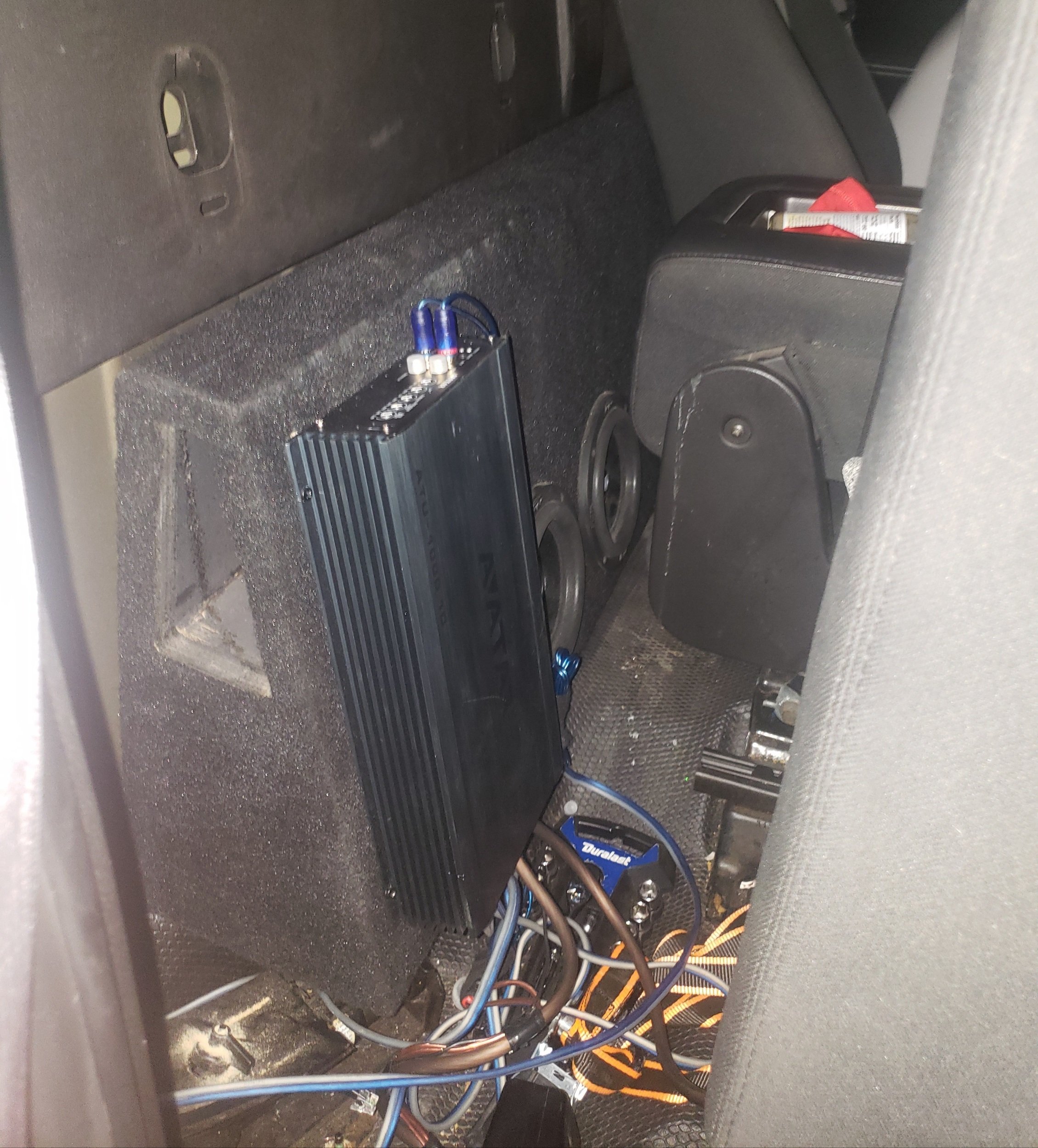

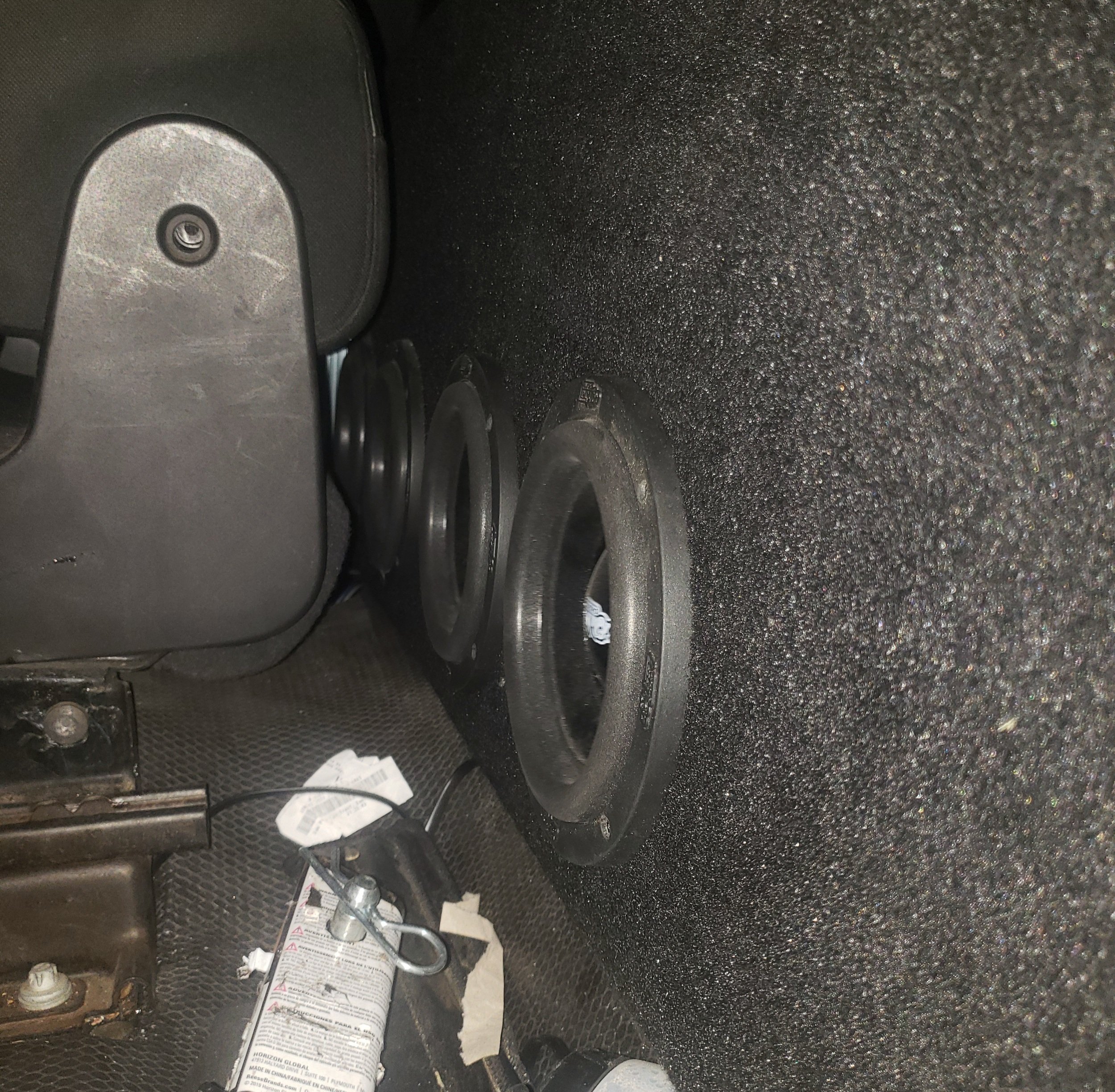

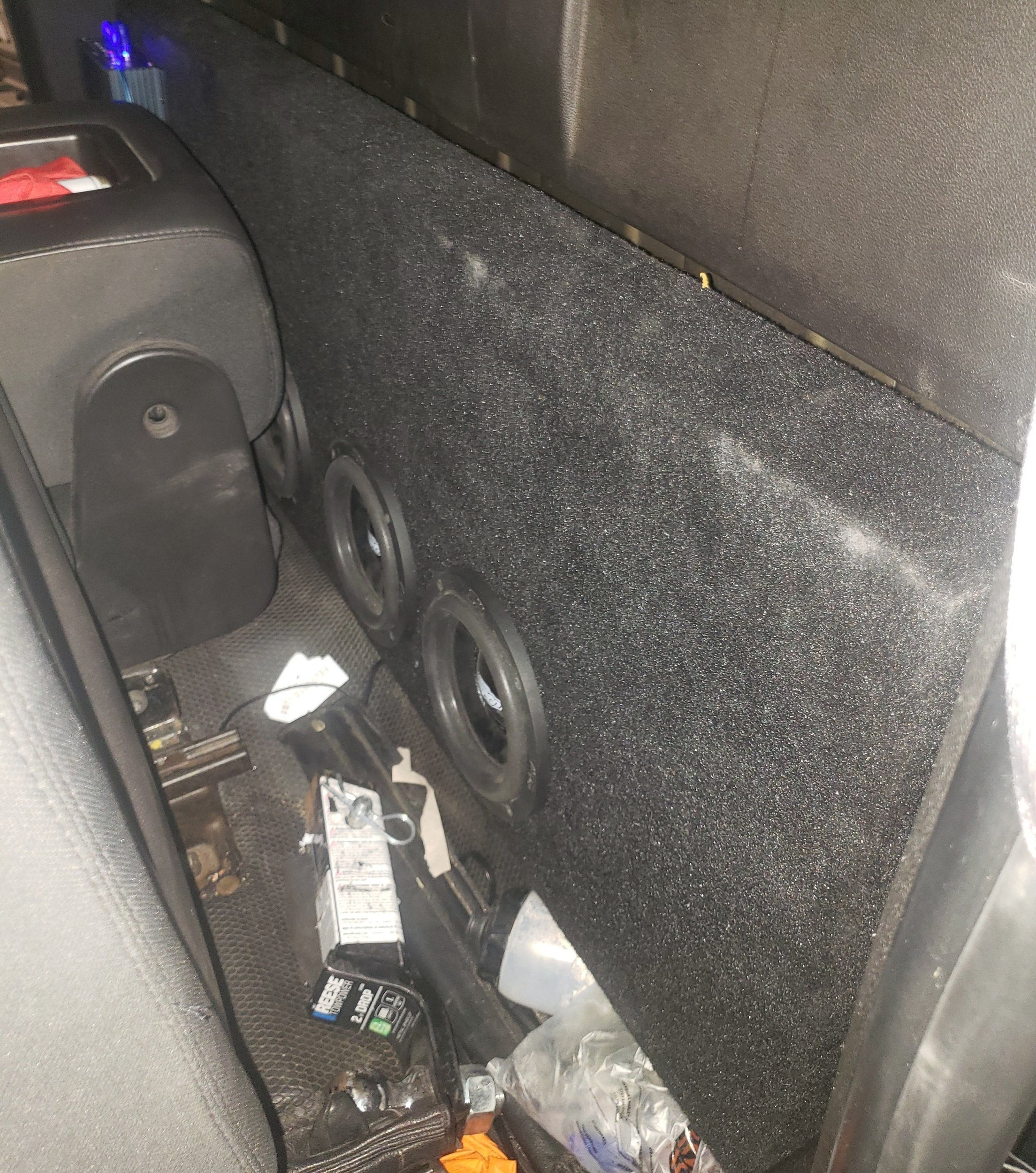

4 - 6-½" Audio Legion subs behind the seat of a 2008 Chevy standard cab truck on a 1,000 watt Avatar amp. They are in a ported box and I'm not sure on the frequency, but I'm sure that it's around 33 hz.

Ive never seen this amplifier before. Can you take a pick of the back? Interesting amplifier.
