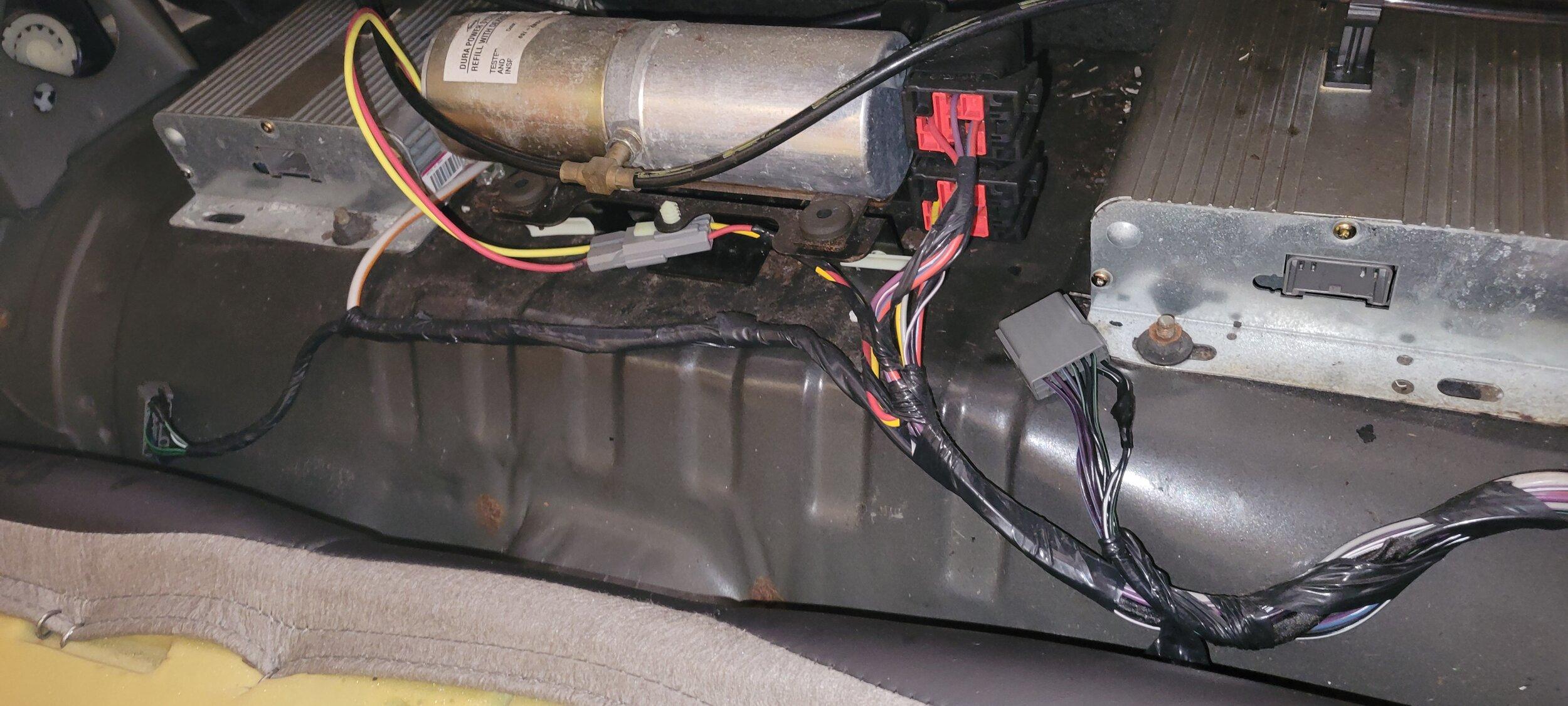

Incidentally found 2 AMPS unplugged under back seats. Plugged them back in with factory harnesses. Now ZERO sound to speakers. (unplugged, sound back)

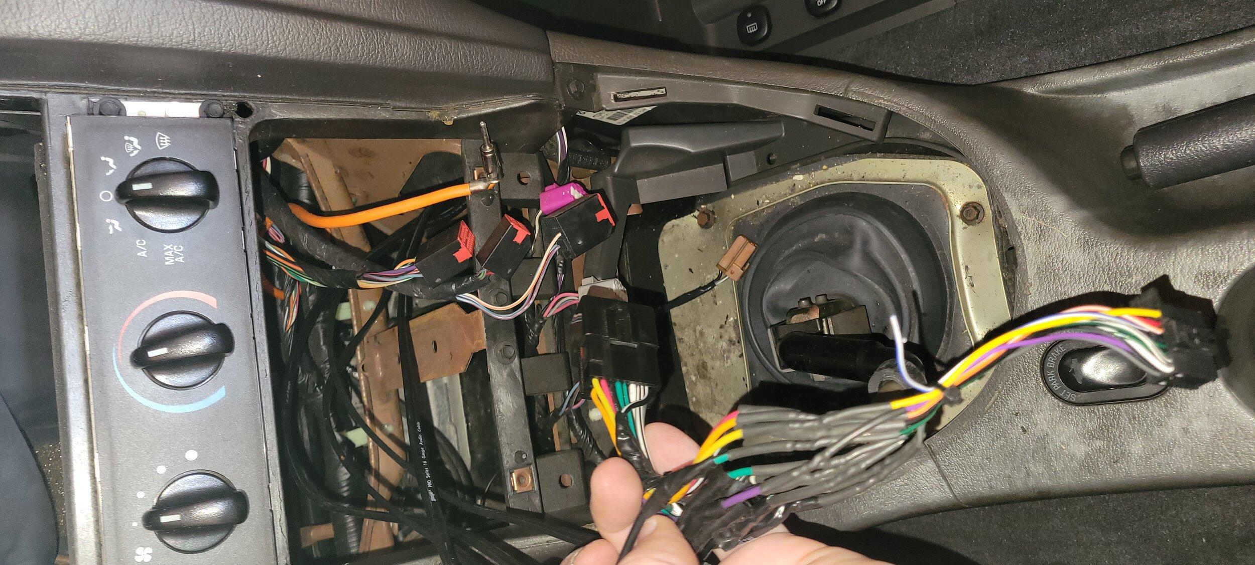

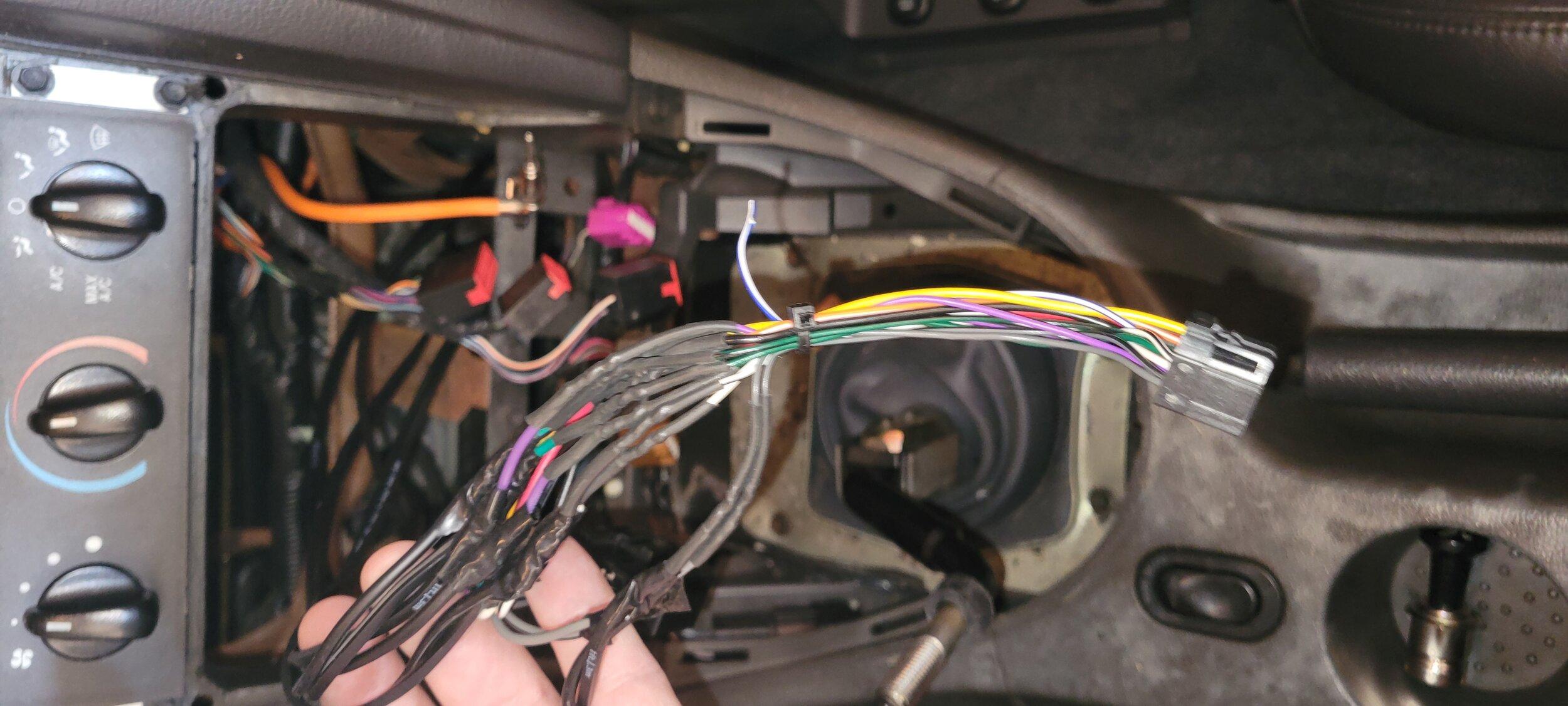

Was ready to add the secondary harness (Metra linked above + RCA), got the dash off and found 4 speaker wires spliced into a Metra harness to the Pioneers unit harness. No secondary RCA harness.
UNIT --> Pioneer Unit harness--> Metra + 4 speaker wires --> Vehicle Lines (Pics attached)

Working on convertible top here last week, I took back seat out to get to the convertible motor and cylinders, I notice 2 amps that were unplugged.
Racking my brain I remembered the only time seat was off was during speaker install. "They must have forgot to plug them in, and that's why it sounds crappy"
Plugged them in and checked.... no sound. Unplugged them.... sound, but as before (crappy)

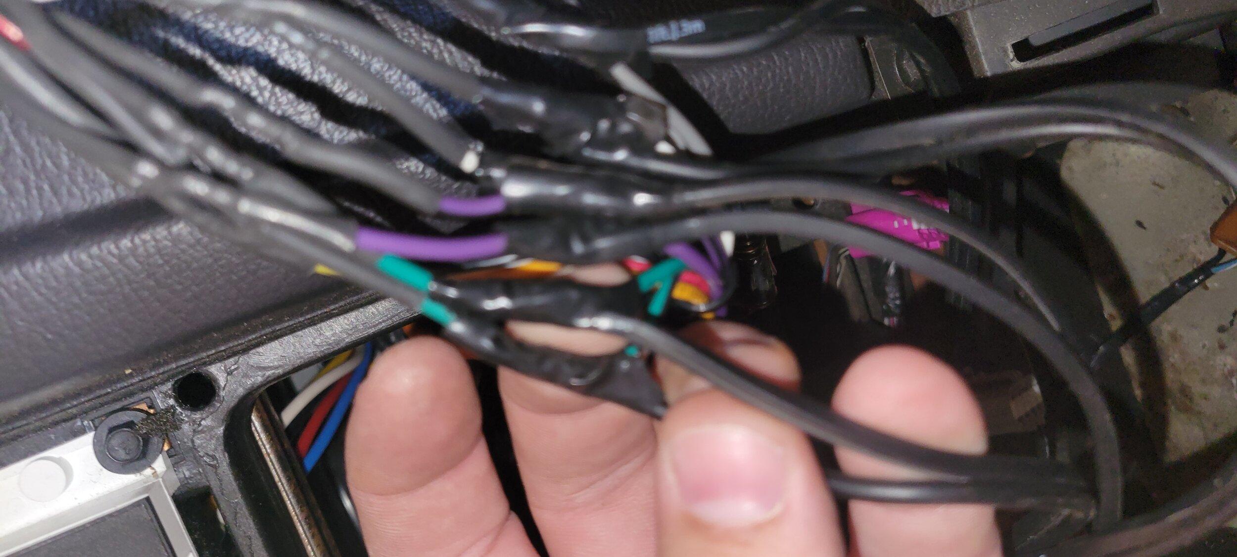

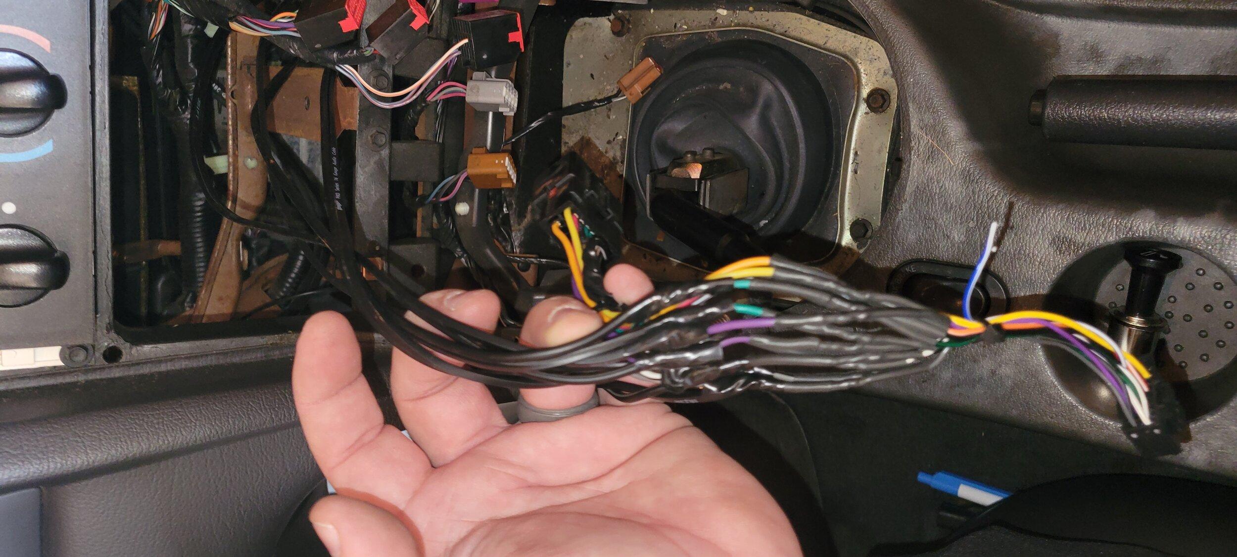

That is a lot of tape and heat shrink lol! All these black wires are very suspicious. Looks like they ran new wires from the Pioneer harness directly to the speakers so they probably disconnected the speakers from the amps in the doors. Not a very good shop indeed. They were supposed to use a Ford amp pin connector to rca adapter to send signals to the amps. With that, they'd only need 12v, ground, accessory, dim and remote (five wires) from the car to the pioneer harness and of course, the antenna.

Not at all. The White, Gray, Green, Purple pairs are all speaker wire sets. As marc2112 said, they are probably wired direct to the speaker locations. If you find those black wires at the speaker locations you will be set.

If the black wires go to the speaker locations, you can use the radio as the power source for them. No amp needed. You can just wire the speakers into them and plug the radio back in and start enjoying.
If the black wires are not there, do find out where before the weekend so we can plan the next move.

Pretty sure the black wires gotta go. He doesn't need speaker wires at the head unit, the rca adapter sends signal to the amps and they take care of the speakers.
The thing is that we do not know exactly what those wires are being used for. If they do go to the speaker locations and OP wants to use a full range amp, then using a speed 9 wire to the radio harness will be the best move. Since OP also said the sound is flat, it would be interesting to see how the tech got this wired up.
