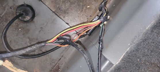

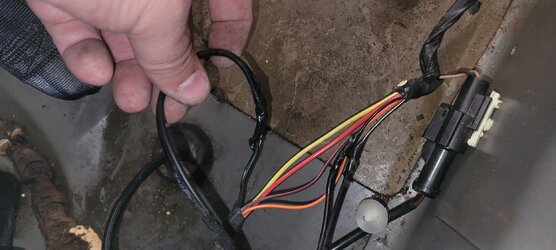

Featured Was wondering if someone could help me make sense of an issue I stumbled upon?

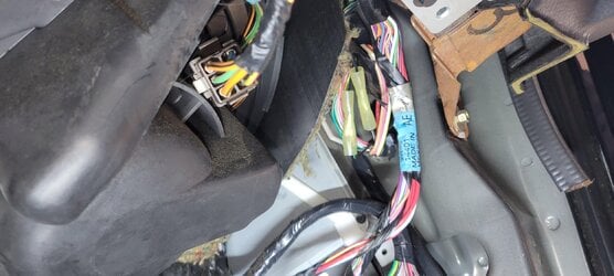

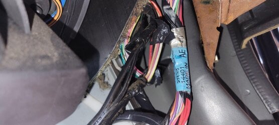

Got in the back today and found 2 of the black speaker wires run under a panel from the front, under passenger door runner, to back under the seats
They have seemed to cut the factory harness black/white and black/green, and spliced the speaker wire to it.
You can see here 1 wire to back left. One to back right.
Assuming I can splice the black/white and black/green back together, and be done with those 2 wires?
What do you guys think

Those splices do not make sense. If each pair of the black wires comes straight from the radio output, would not one pair be spliced only to the side going to the speakers? It seems like one of the black wires is going back to the OEM amp.
Right.
I was like wtfffff is happening here.

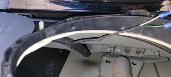

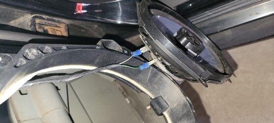

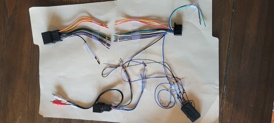

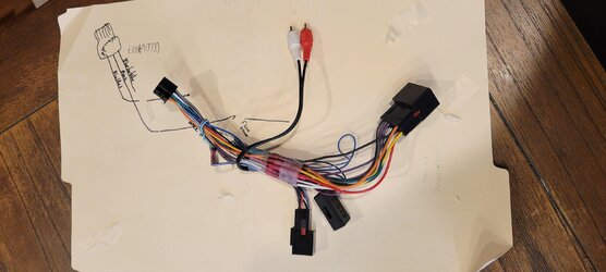

Here we go gang... After a month of wrangling the kids, I had a minute to breathe.
I'm about 75% done this job.... I would say 95% done, but I still have some stuff to do up front.
I got the new harnesses in the mail and all wired up with that voltage reduce I stumbled upon in another thread about this issue.
Now so far I had the back seats out for my convertible top and found 2 of the black speaker wires spiced to the back speakers.
I undid those and reconnected with the heat shrink connectors
I have yet to do the front door yet, but that's why I'm saying 75%, not 95% done.
I got these harnesses ready to go (pics below), and went out and plugged everything in, started the car.... no pop, full bass from the speakers I have done and the tweeters. So.... It worked.
I just have to do the front door speakers and I'm done.
Can't believe the headache this "professional" shop caused, only for me.... a novice... to fix it with some time and you guys helping.
I will final update what I find in the doors... hopefully no BS... and give the final result...
So far very promising and I'd actually be ok with it "as is", but I'm already this far and will have the 1 door off anyway for a window fix, so might as well, haha
CHEERS

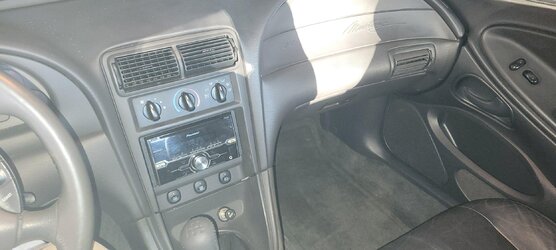

Hi everyone, Thanks in advance if you're here looking at this as I am new to the forum.
I am probably 3/10 knowledgeable on car audio set ups, but recently stumbled upon some weird stuff in my first car I bought/newly found project car.
I'll put the "short run down" first and explain details later as to not discourage anyone from helping (don't want to bore anyone).
Car: 2002 Mustang GT (convertible - Not Sure if its relevant)
Audio: Mach 460 with the 2 factory amps under the seat
Aftermarket unit: Pioneer FH-X720BT (Pioneer Unit Link)
Aftermarket Speakers: Unsure (I remember just picking them)
Parts Purchased So Far: Metra Wiring Harness
Short Run Down
Issue
Sound to speakers works but sounds VERY diminished. Like an old radio with no bass.
Incidentally found 2 AMPS unplugged under back seats. Plugged them back in with factory harnesses. Now ZERO sound to speakers. (unplugged, sound back)
After researching, I found my car needs a special secondary RCA harness to integrate the amps, to allow the aftermarket speakers to function.
Was ready to add the secondary harness (Metra linked above + RCA), got the dash off and found 4 speaker wires spliced into a Metra harness to the Pioneers unit harness. No secondary RCA harness.
UNIT --> Pioneer Unit harness--> Metra + 4 speaker wires --> Vehicle Lines (Pics attached)
