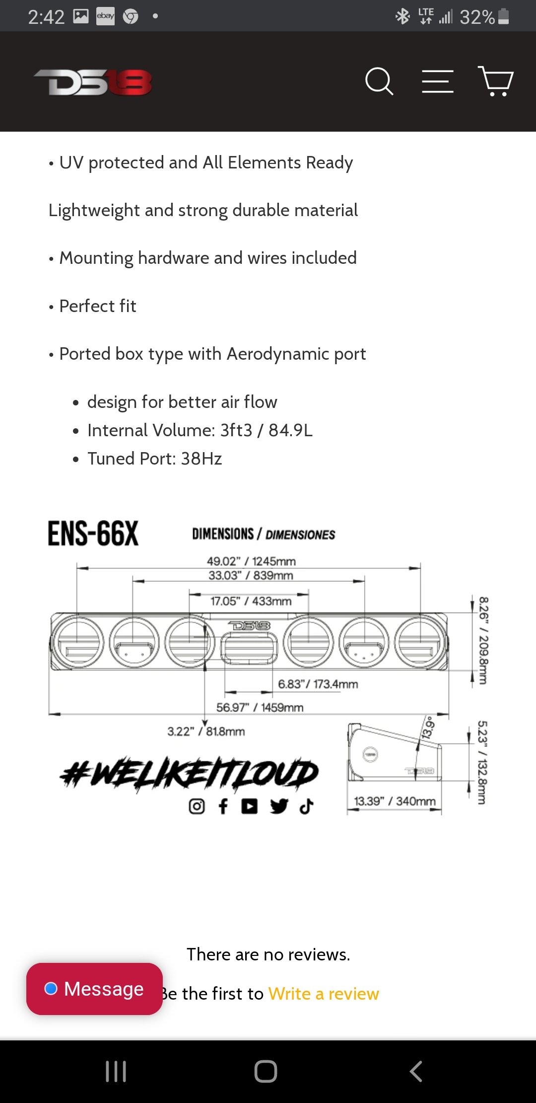

This is an under seat box for a F-150, but I don't understand how they are coming up with 3.3 internal? You can't even get 3.3 using half inch wood. I'm not able to get 3.3 sealed without port? Maybe the calculator I'm using is off but I highly doubt it? If someone can verify the 3.3 please explain how you came up with it?

Those outside dimensions are only roughly 2.97 cubes. Using ½" material drops it all the way down to 2.31 cubes net before subs and port displacement.
Yep, that is similar to the number I came up with. I think the max is about 2.4 cubes ported without a seat lift. I've seen some boxes sticking out 2-3 inches from under the seat, but it looks ugly like that.

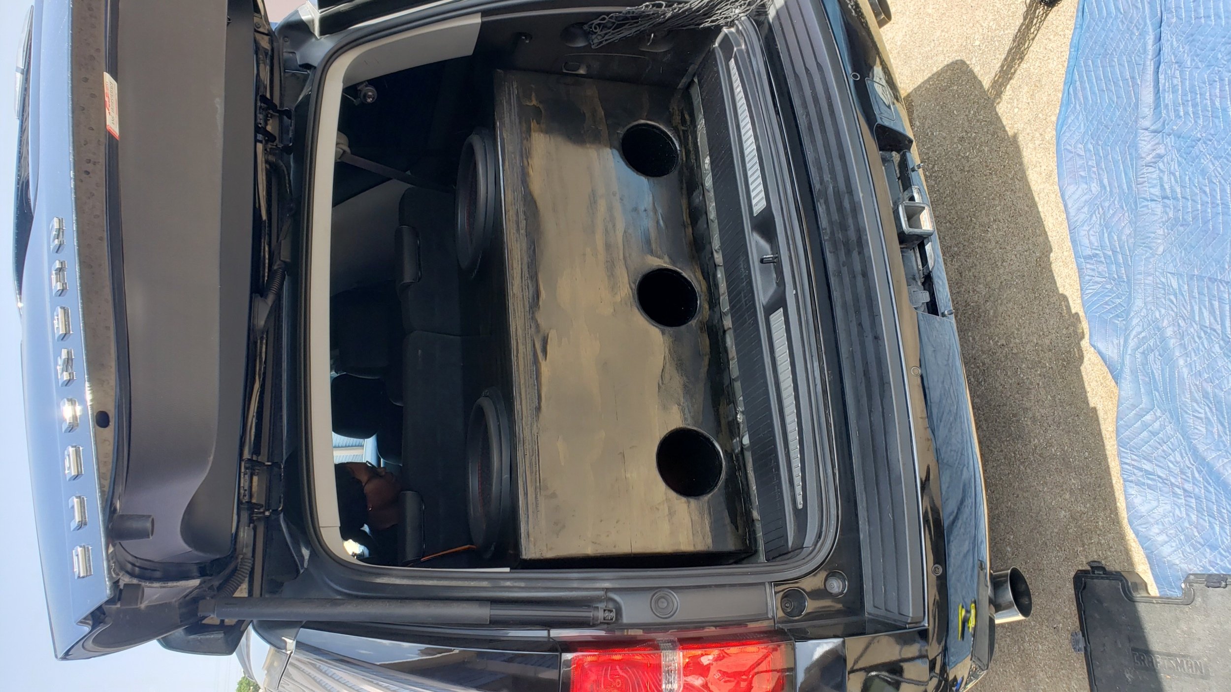

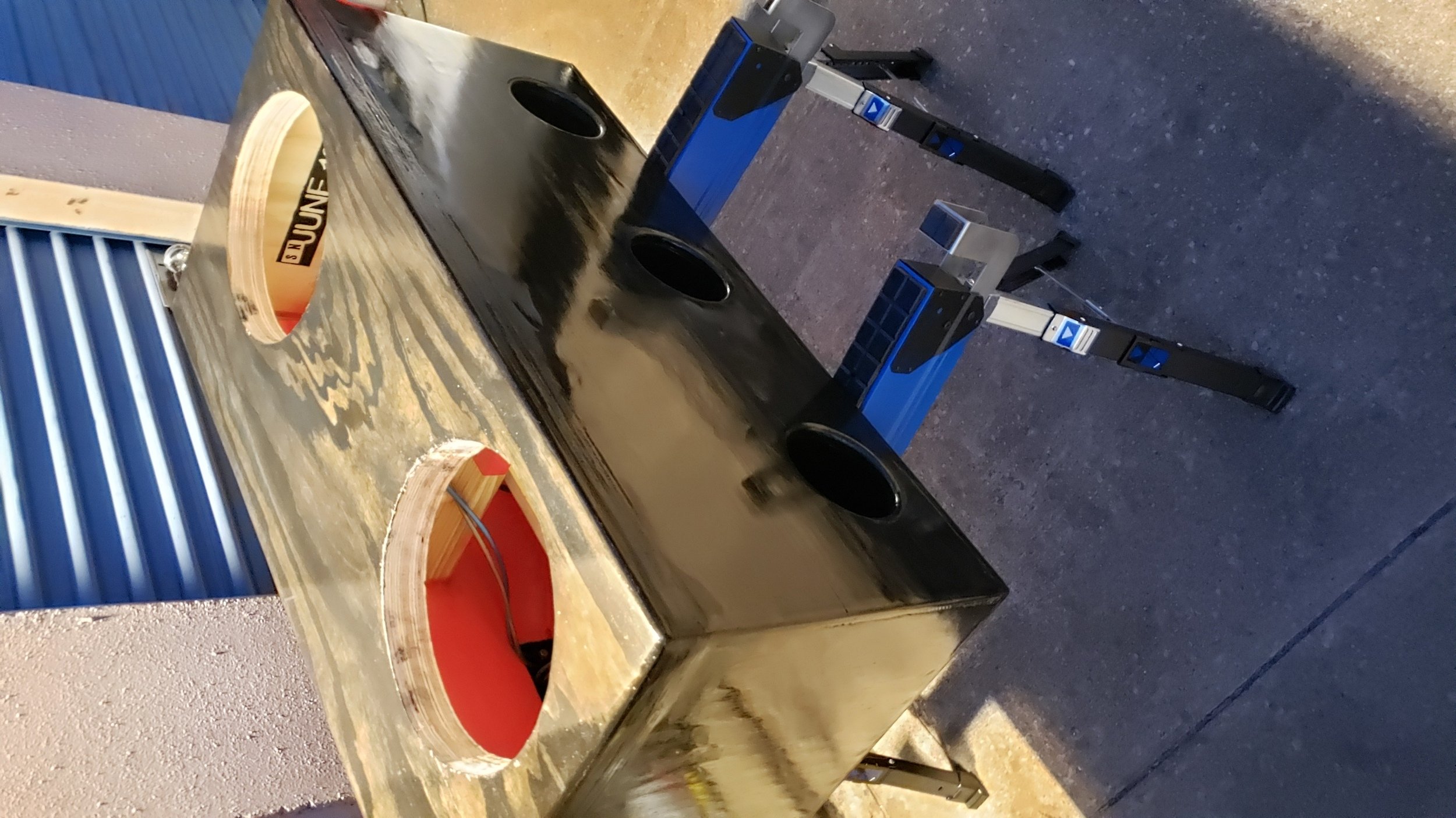

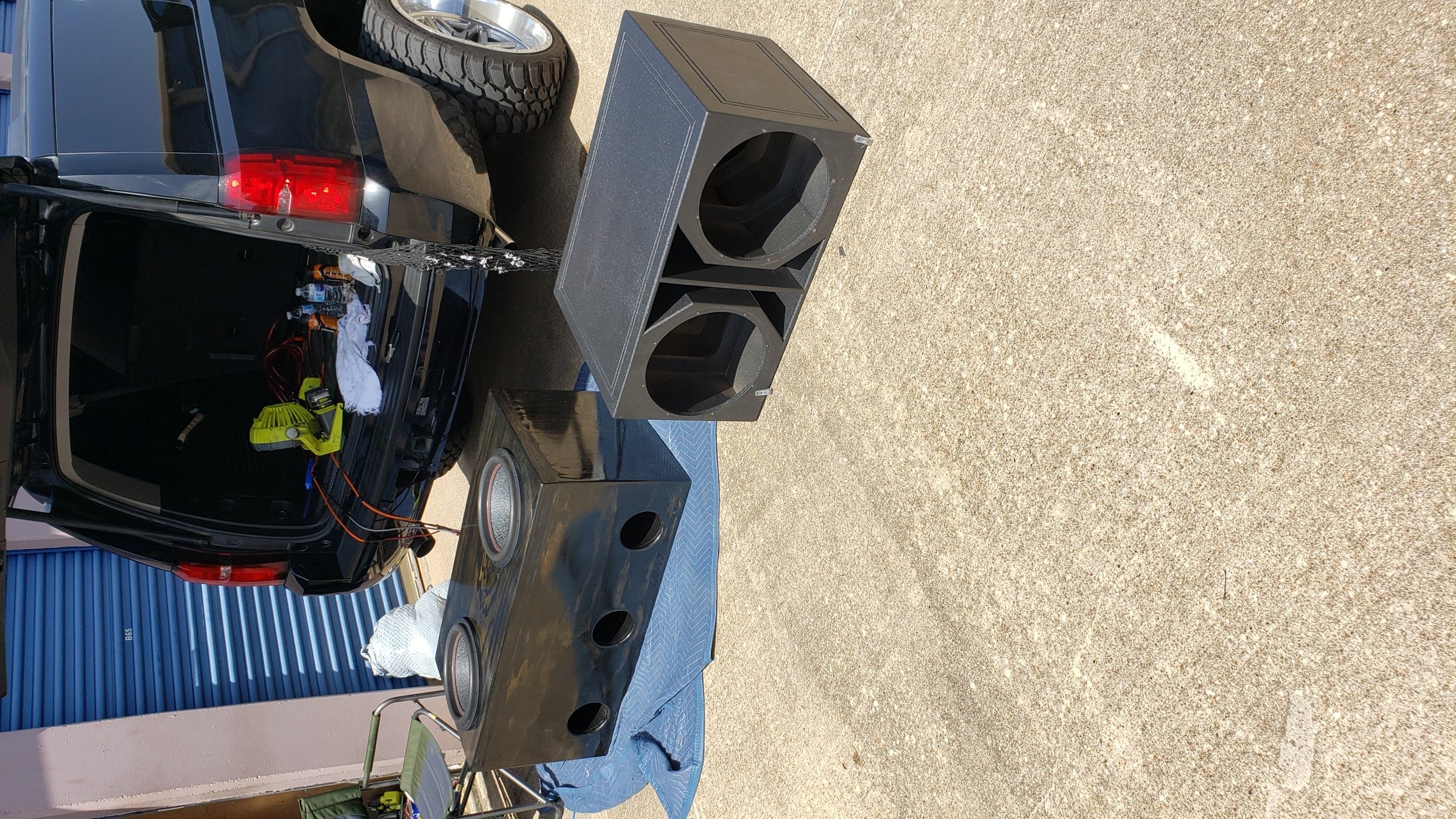

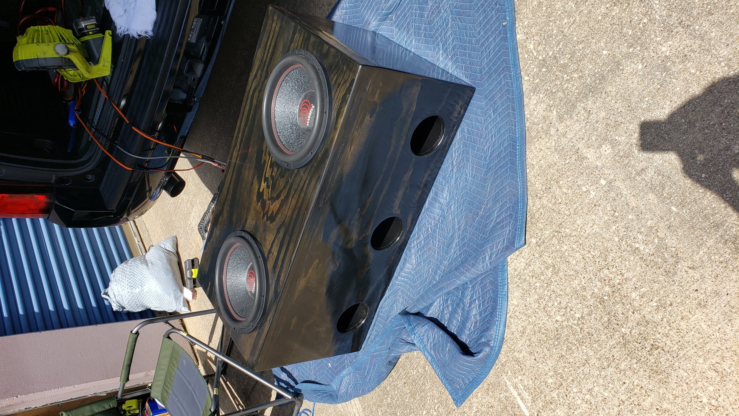

I'm professional as it gets. I will show you the box when I'm finished. I'm no joke at building boxes. I'm kinda new to the under seat thing, but there isn't any special skill set required. I started this post because when I researched F150 boxes, just from eyeballing it I could tell that the cubic feet was wrong. Some guy even told me his front height was 10 inches for 3 8s, and he said "with no seat lift required". You only have 8.25 max, maybe 8.5 in the front with no seat lift. I was just wondering how these guys were coming up with all these inflated numbers? Bobby, I just made a box for 2 15s for a Suburban. Pics below with 3rd row in, and you let me know if I still need a professional? He didn't like the black box on the right because it wasn't hitting any lows, and it was installed improperly by a professional. They didn't even use the speaker terminals on the box, instead they drilled 2 big holes in the box under each terminal cup and ran the speaker wire like that. The box was leaking air in about 5 different places.

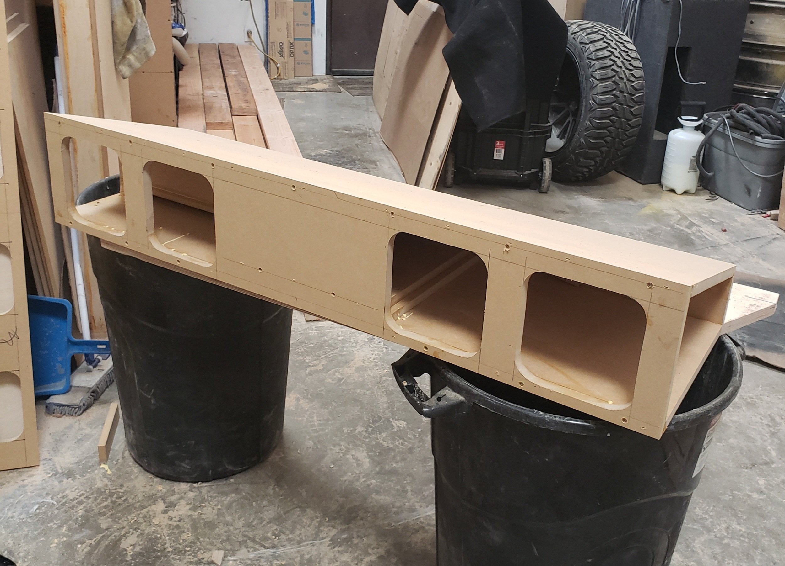

I would like to know the dimensions on the first box because it looks too tall in the front for an f150? It looks to be angled a little for a better fit, but I think it will still raise the seat up.
Those pics are of the same box. You should be able to fit an 8" sub in a 9" - 9-¼" tall box. The cut-out for my VFL8" is just under 7-½".

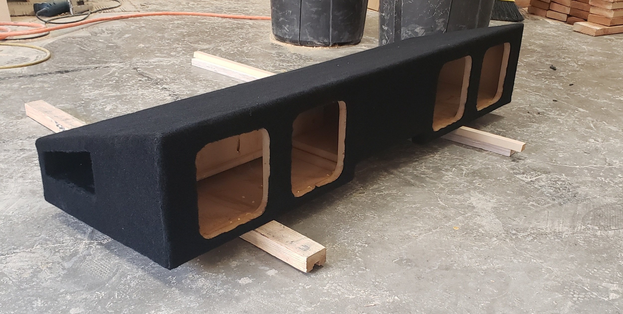

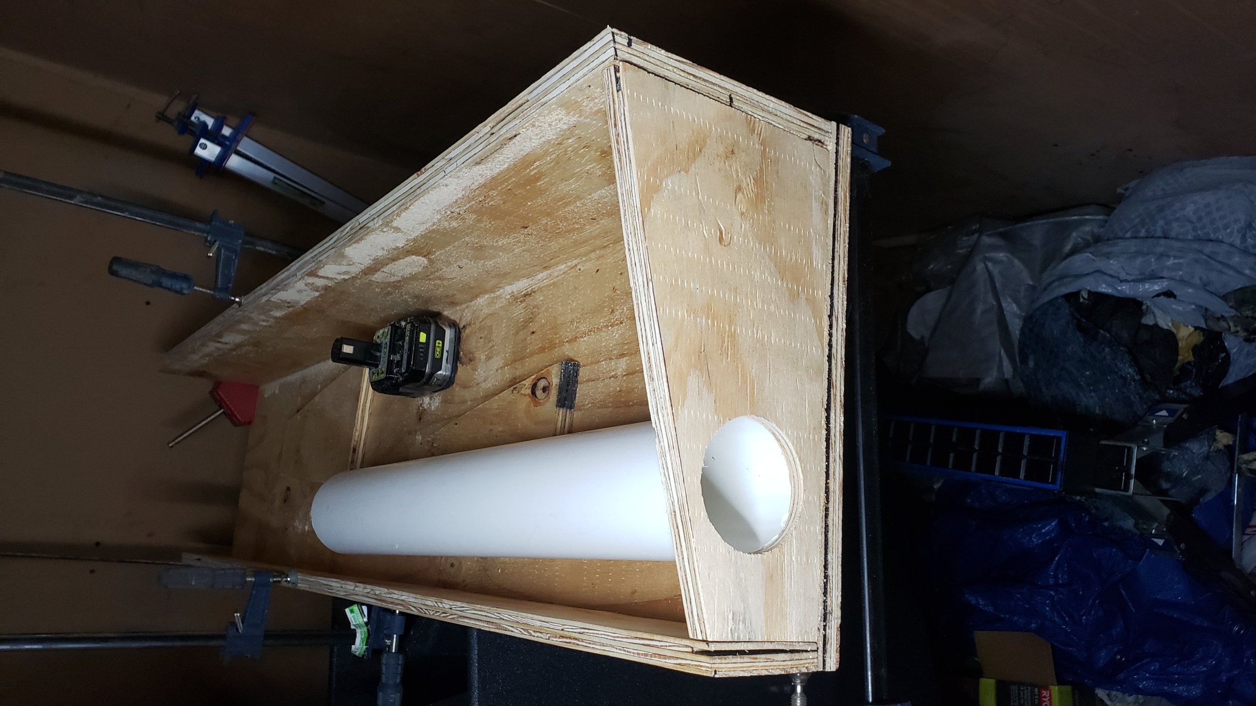

Ok, I see the bottom part wasn't cut yet for the hump. I started the box using some cheap plywood that needs attention. I'm just test fitting right now. It will be dual chamber with a port on each side. I'm no stranger to box building and can't see paying someone to do it for me. This box is for 4 6.5s. It is 8.25 in the front and 55" width.
