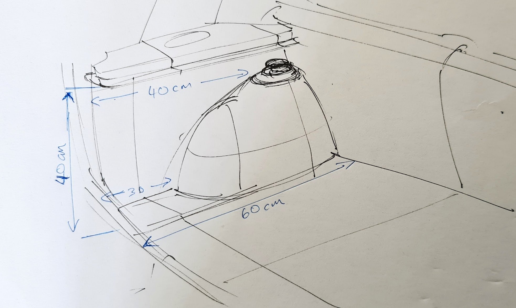

Okay so ive done a rough measurement of the side of the boot area in the car
The deepest area is about 30cm along the bottom 40cm along the top as it curves over the wheel arch. Height wise in that area is about 40cm.
Depth - I guess I can come outboard as much as needed but obviously not half way over the boot space lol. Plan would be to make it small as possible for a good sounding ported box.
The measurement from the edge of the door opening to the bottom of the back of the seats is 60cm and tapers as it comes up to about 50cm
Hope that makes sense. If not, please let me know and I can draw it out
Sub wise ive seen either a Hertz Mille Legend 2000.3 or the cheaper alternative is the Gladen Audio SQX 8"
Please let me know what you think and if a ported box design is possible
Thanks :)
Definitely draw it. That's always the best way to transfer box dimensional data.
Ive attached a rough drawing of the area and measurements. Is this something you can help me design then?
Thanks :)
