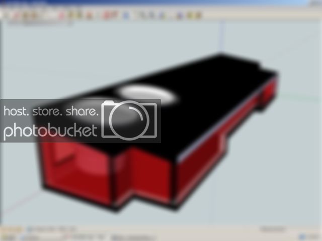

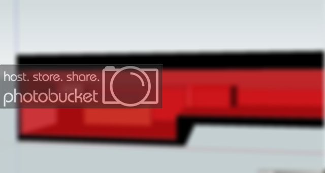

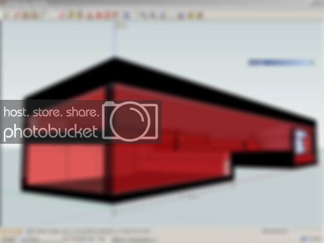

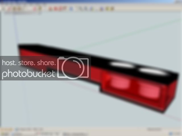

Ok, I just got done designing a new box for (2) DD1508's. I have the MDF and just finished the cut sheet. Now there's 2 ways I could run these subs/ports. It wouldnt effect the cut sheet at all either way, but right now I have it set up with the 2 subs on one end of the box, 7 7/8" x 3" x 12" port on the other end.
I could however seperate the subs on opposite ends of the box, in seperate chambers, with 3or4" aeroports. Right now total volume for box is 1.889 cuft after sub displacement but before vent(s).

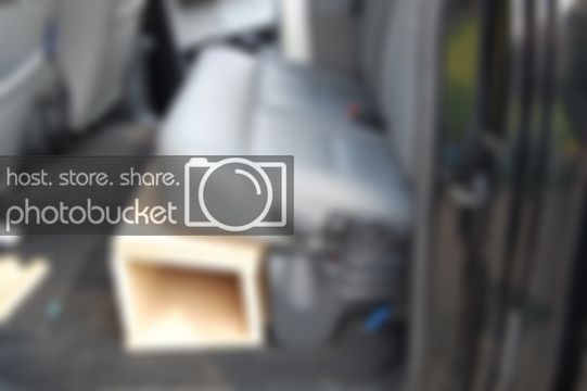

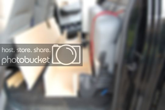

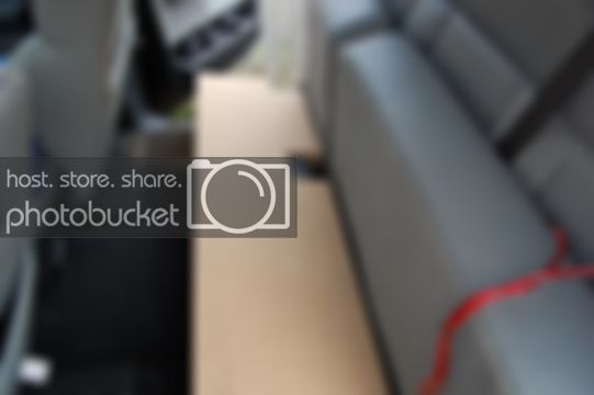

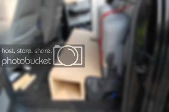

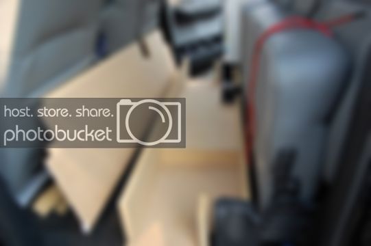

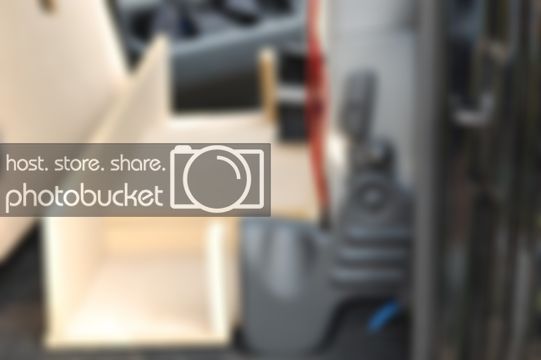

I ordered my subs and they should be here tues. I finished cutting my box today and just pieced it together, will screw and glue everything on mon. Here's some pics:
I think I might paint it and carpet the top and bottom. Either that or Black carpet and some diamond plate. Not too sure. I'm waiting on some stuff to get here from parts express as well. I will be making a plexiglass loading wall that will pretty much serve to protect the subs from the seat. Seems like I have a lot of work ahead.
