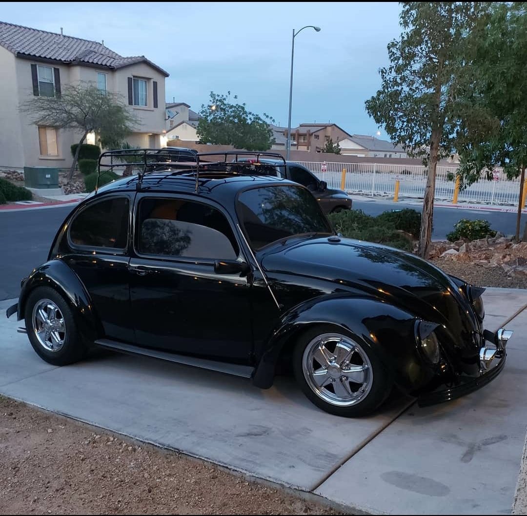

I bet she rattles like a sumbitch. Looks nice though. Did you do the restoration? Factory engine? There's an old bug in my area that has a scubaroo boxer in it.
A piano black finish on MDF takes a lot of steps. Basically, have to put filler on the whole pod to start with. Then, sand, primer, filler, primer, sand, primer, sand (600 grit). Paint, wet sand (600) paint, wet sand (1,000), paint, wet sand (1200), paint, wet sand (1500). Then, clear, wet sand (1000), clear, wet sand (1200), clear, wet sand (1500) then two coats of clear to finish. The process is no joke. At least, the midbass and tweets are in little enclosures. Only a hole big enough for the speakers wires to come through the back of the door panel.
Probably as much work as fiberglass....

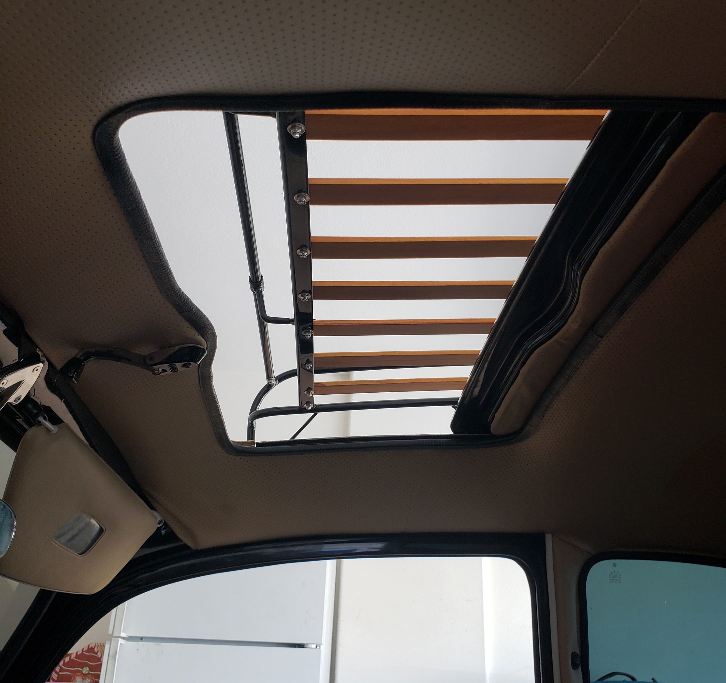

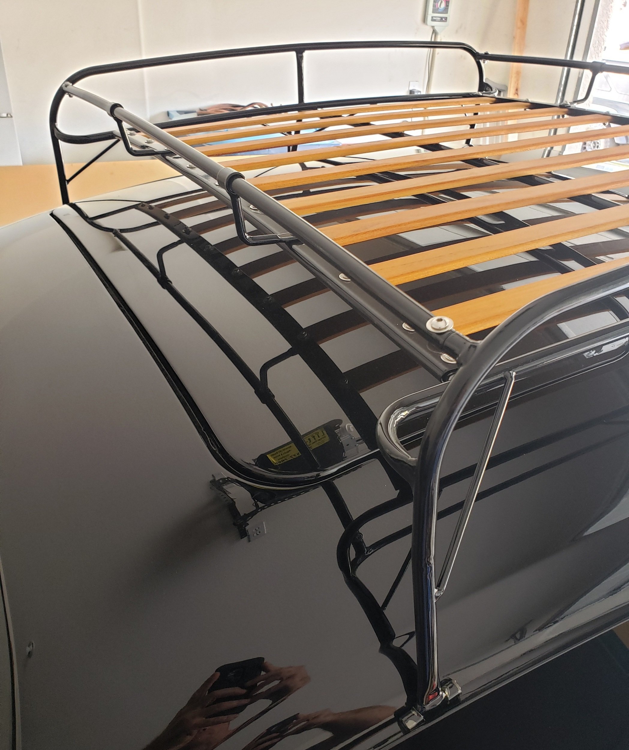

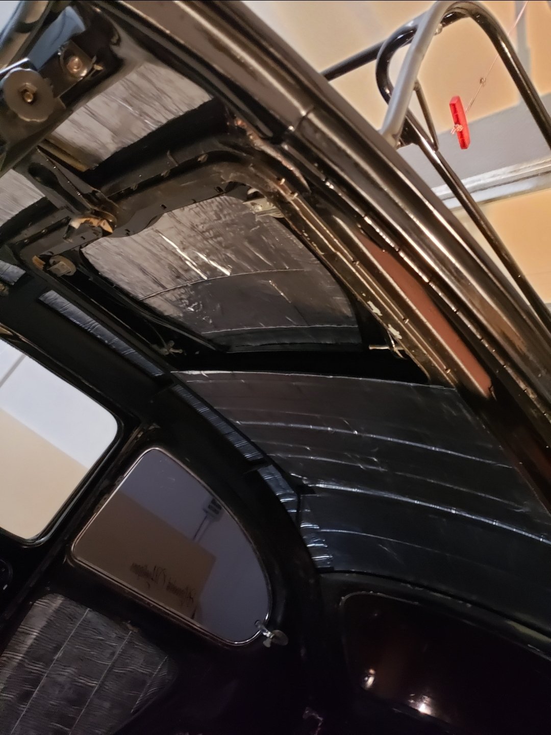

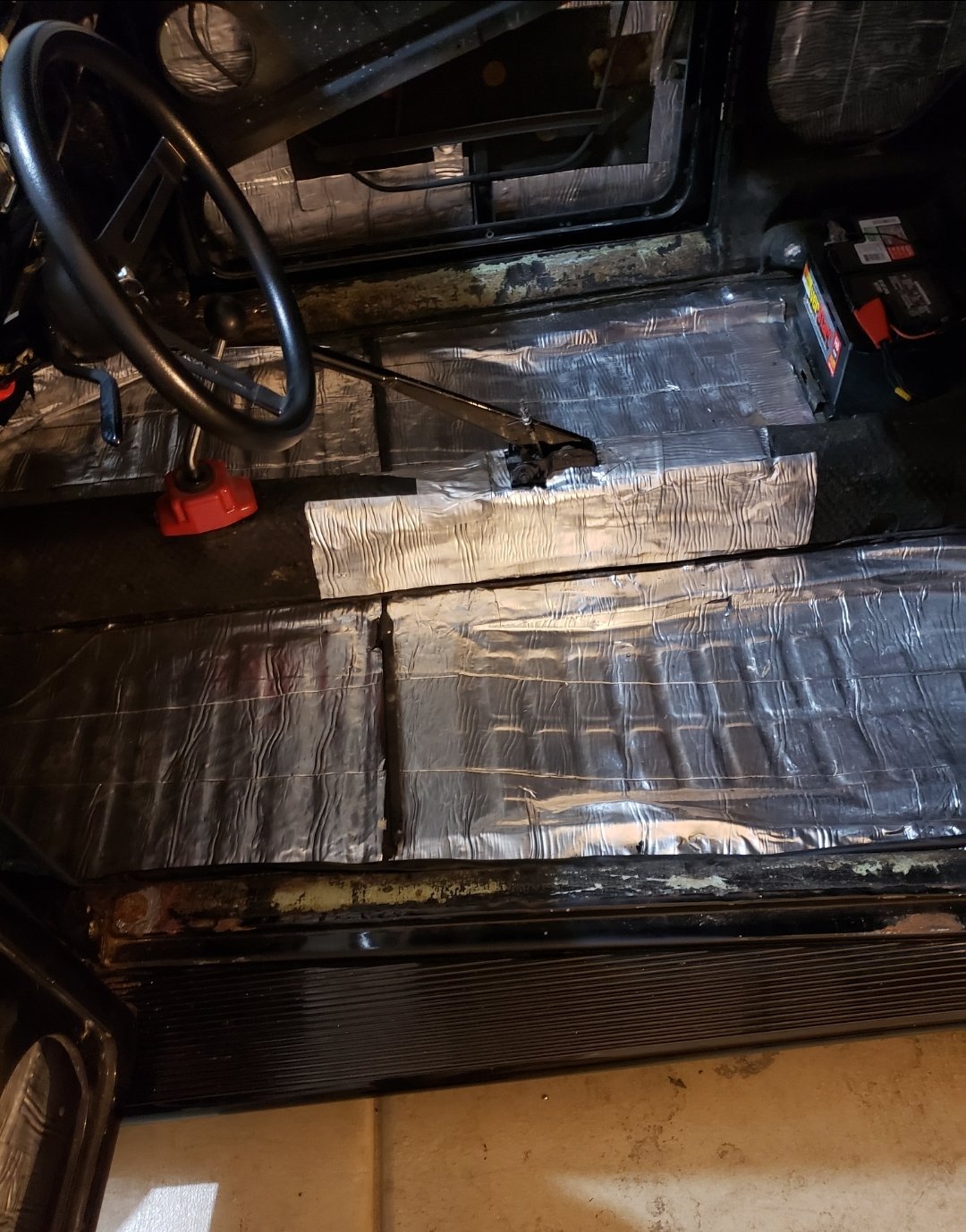

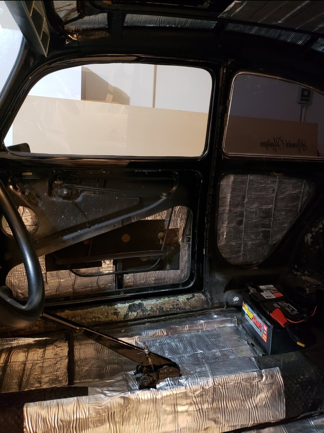

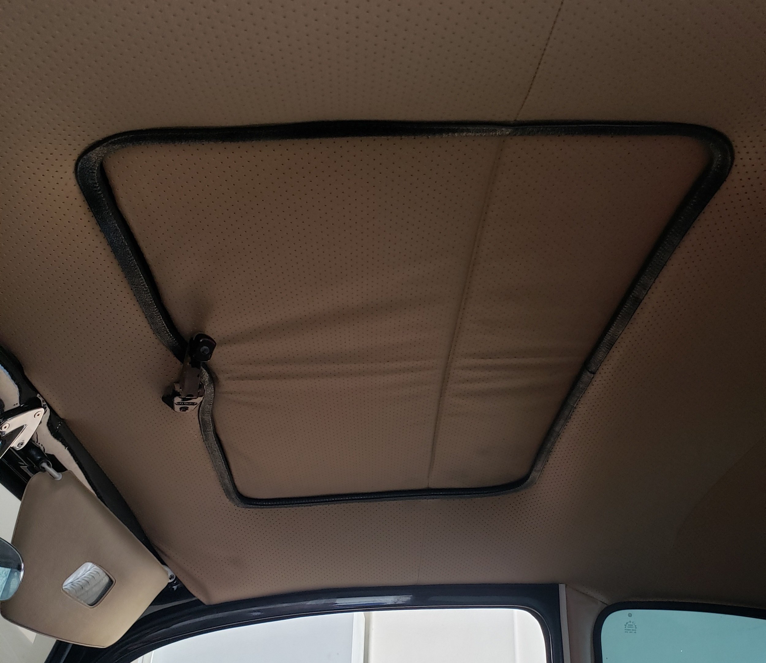

Doesn't rattle at all. The entire car is sound deadened. Under the hood, under the dash, and even the wood roof slats are padded.
