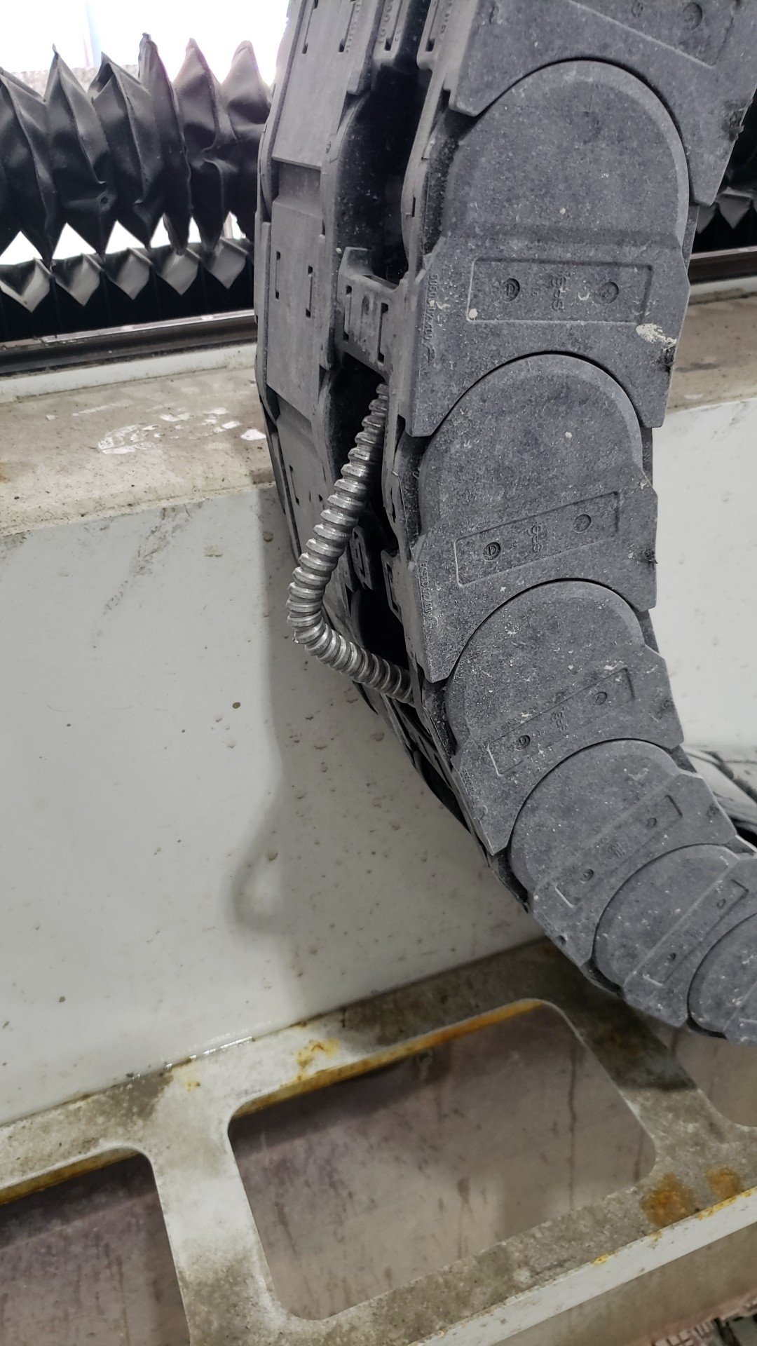

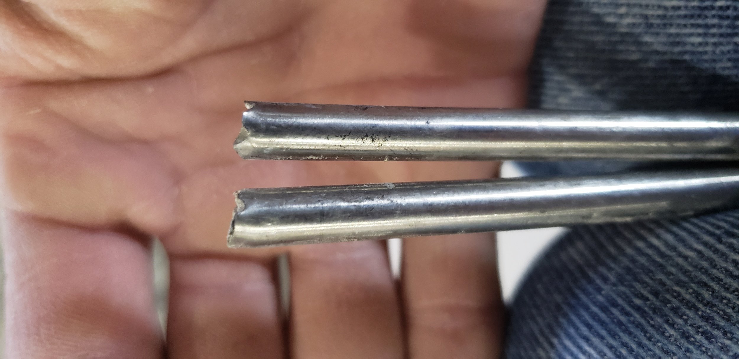

This is what a fatigue failure looks like:
That's a 1/4 inch stainless high pressure line for a water Jet.
That line is designed to move with the track and flex while carrying a 60 THOUSAND PSI stream of water inside of it. You can coil a 20 foot section of the line into a 30 inch circle without much trouble. Hell, you can tow a car with a section of this stuff, it isn't fragile.
The simple fact of all of this bullshit is some subs do need a break in period. It may not be absolutely critical, and you may get away without doing it just fine, but that doesn't change the facts.
