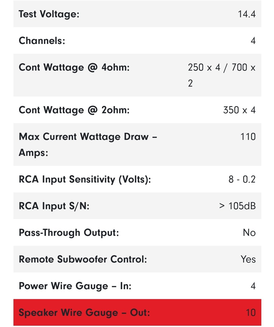

Don’tknow if that will be a good setup tho. Still noobing out here
I think that your amp is more powerful than you think.

To powerfull that it wont work? What would be better as a setup? Different brand speakers on one channel wont work as ive seen
Ah great, Guess i need to be verry carefull with thE gain.

Pioneer lists the wattage different than sonic. Pioneer says That amp listed will do great with these speakers. You can play em at 125w no...
