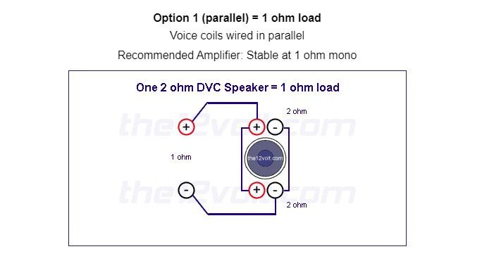

Well I went ahead and purchased the items you suggested. My question is wiring the sub. It's got dual voice coils. Dual 2 ohm. None of the paperwork shows how to wire that. Do I have to jump from terminal to terminal or just use one set of them or what? Thanks for your help :)

I would wire it to a 1ohm and according to the NVX information on Amazon it is capable of 1ohm stability. Just adjust the gains correctly. But as pop pointed out 4ohm is ok on that as well since it does 350 and the sub is 350 rms.
26521
I have seen that diagram however the amplifier is not forum it's too home. Or am I running the dual 2 to accept the 4 ohm from amp?
Thanks everyone I appreciate it :)
It took me so long to figure out what you were trying to ask here lol.
Your amp doesn't determine the impedance (2 ohm vs 4 ohm), your subwoofer does. Your woofer has 2 two ohm voice coils. Wiring them the method shown in the diagram pop showed will create four ohms of resistance resulting in the subwoofer receiving 350 watts RMS from the amp. This is wiring in series. If you wired it in parallel your subwoofer impedance would be one ohm. Your amplifier does state one ohm stable, but doesn't state power output at one ohm that I saw. Regulardless, one ohm wiring would likely result in over double the rated power of that subwoofer.
The information on Sonicelectronix says 350 rms and 700 max on the subwoofer. But also says 600x1 at 2ohms on the amplifier. So yeah 2ohms would be perfect for it. Says 1ohm stable on Amazon but not on Sonicelectronix so idk if I would now trust the Amazon information yet they "supposedly" get it from NVX. Amazon has been wrong before on this stuff. I think I would do the 2ohms after going through all that information on Sonics site since they were the ones who had them built for them as a in-house Car Audio company.
