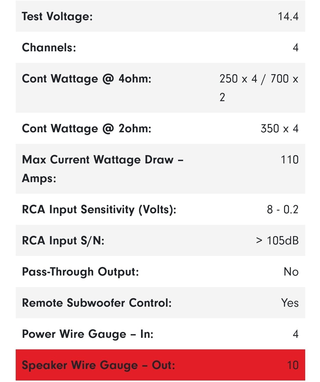

Am I missing something about this amp? It seems quite a bit more powerful than the OP thinks it is.

Pioneer lists the wattage different than sonic. Pioneer says That amp listed will do great with these speakers. You can play em at 125w no...
4
1K
I think you will be just fine to be honest. Id run it and check it after hammering on it quite a bit and check the temp on the wire by hand to see...
