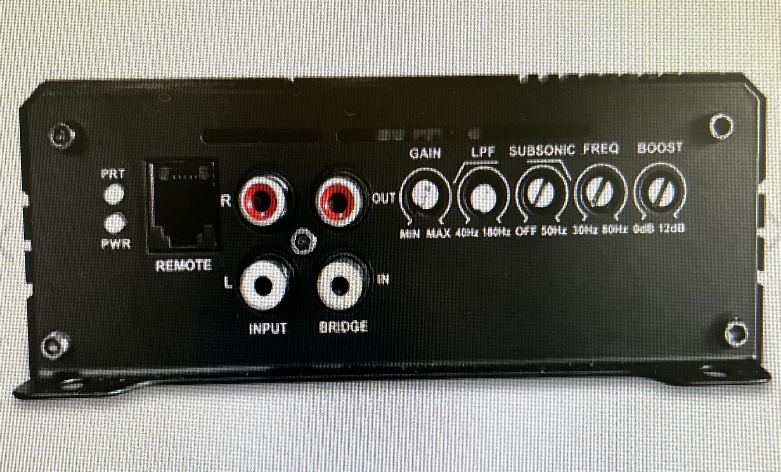

This is my amp, Ct Sounds 2000.1
I am using the crossover in my h/u.
where should I set the Dials on the lpf and the frequency?
If I’m not mistaken, do I turn the lpf all the way to 180hz so it acts as “full pass”?
the LP filter is cutoff for the frequencies. I run mine to 80ish normally some sub/box combos will sound good running it up a little more... if you want your head to do the work, you can run it up more and use the HU for xover point
I run mine off the hu since it's got a much better crossover...my subsonic is set around 25hz and my lpf is wide open on the amp...off my hu the lpf is set to 80 with a 24db slope...my bass boost is off and my gain is a touch over half
