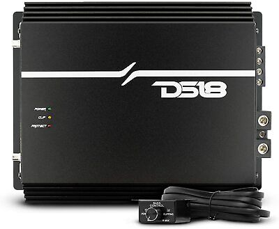

Korean designed amp options that have better controls and higher output, just to name a few are:
Brand new at $330
Refurbished at $200
They both have subsonic filters but would be best used with the LCI2 pro model. That refurb unit is sold by a VERY reputable dealer and along with the LCi2 pro would be a better option.
