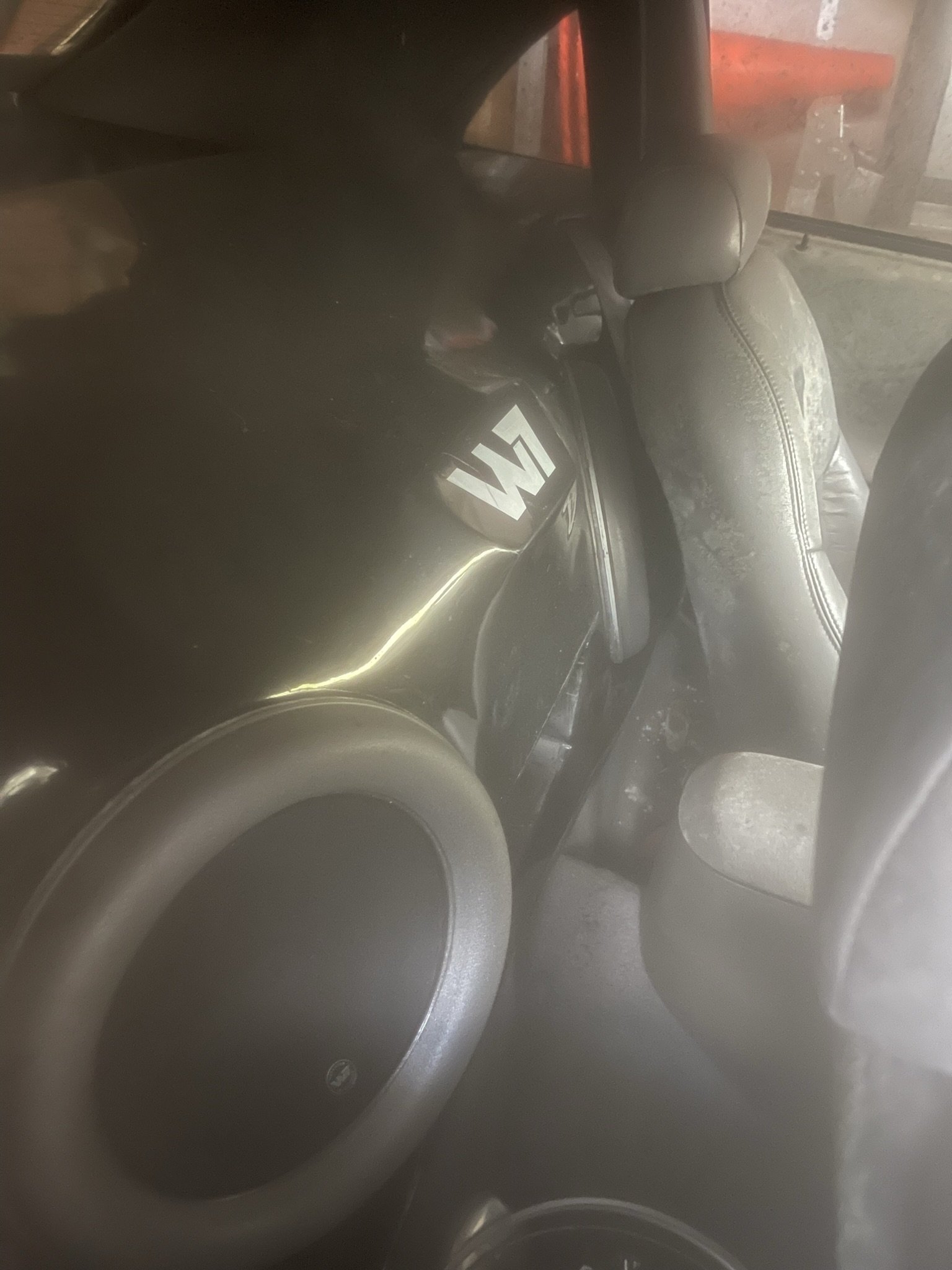

So I did some digging in the trunk and 4 of the wire sets are labeled. 1000/1, 1000/1, 300/2, 300/2, and the last one is not legible. Here is a pic in the trunk. It’s kind of a mess. My dad has dementia and can’t remember much. I was trying to get some info from him.

I would worry that the fronts may run into trouble though. Soft parts do wear with age and if the tweeters are ferro-fluid filled that **** dries out and they will fail. I'm sure the shop can visually inspect them to make sure everything is physically intact but I'd expect they're nearing the end of their expected life if they're 20 years old. The only thing I'd really worry about on the W7s would be the surrounds but those look good from your pic. Looks like a really cool car. Post some pics and impressions whenever you get some new power in there.

If that is a mouse nest or something I see to the far left, I’d get that stuff cleaned out and inspect all the wiring thoroughly before reinstalling any amps. And check all connectors / fuse holders to make sure any urine hasn't corroded anything. That unit in the middle with all the RCA cables plugged in looks like it needs inspected for sure. After a little cleaning / wiping down the wiring, most of it should be good, nothing looks bad at first glance, but I would definitely look over it.
