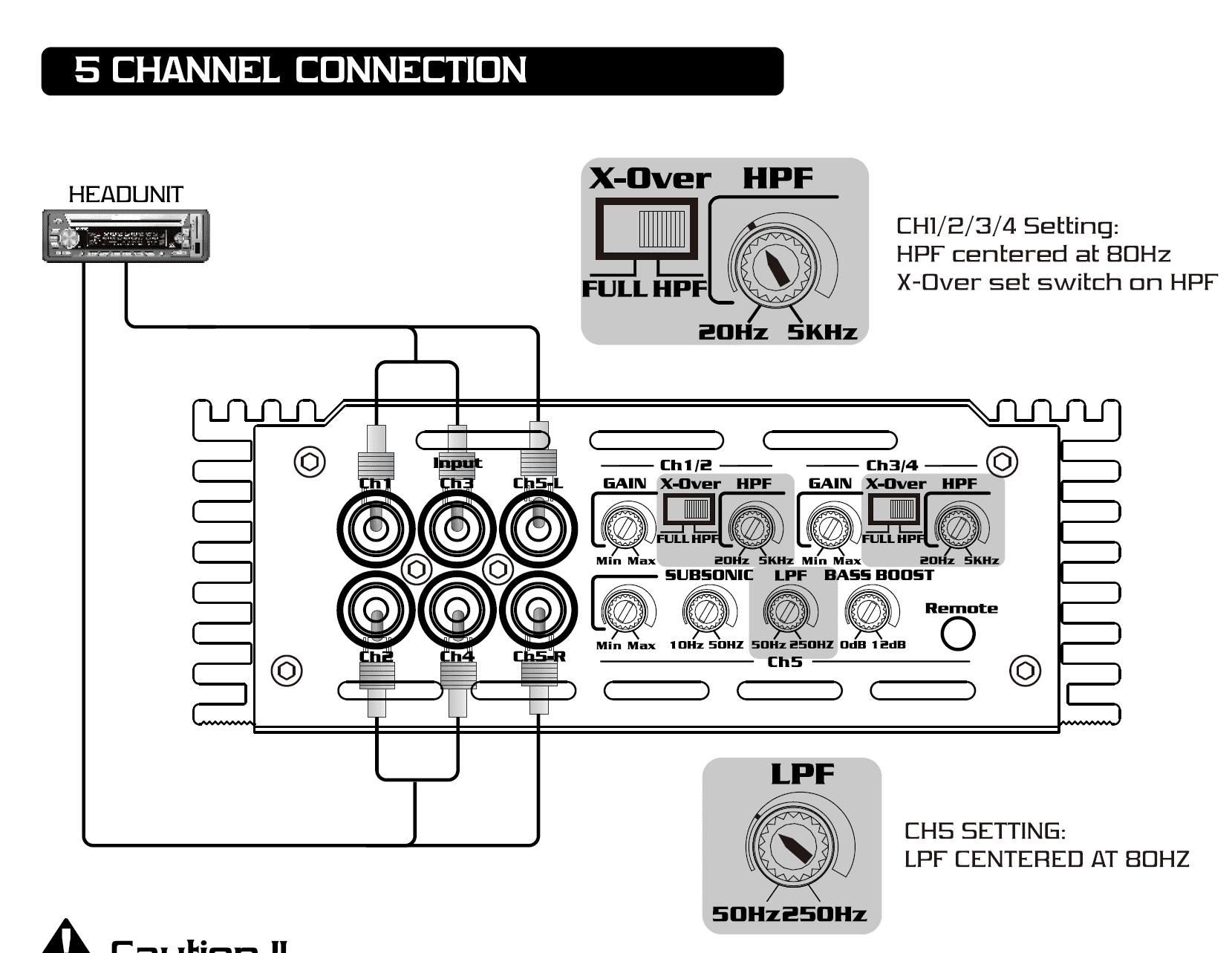

So, this diagram is from the user manual. Are they saying that front speakers left/right rca go into channels 1/3? And rear go to 2/4?
That doesn't make sense to me, because you adjust the crossover for 1/2 and 3/4. Anyone familiar with this RP 600.5 from Skar?
That must be in instructions for a cheap Chinese amp.
1 and 2 is the front channel. 3 and 4 is the rear. You can tell by looking at the x-over settings and this is also the standard setup.
