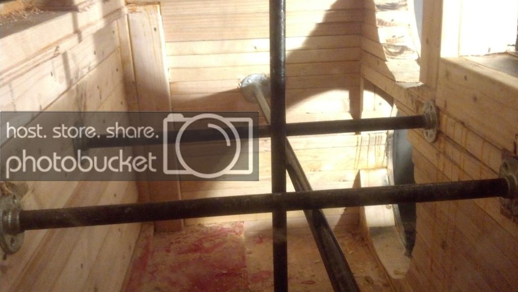

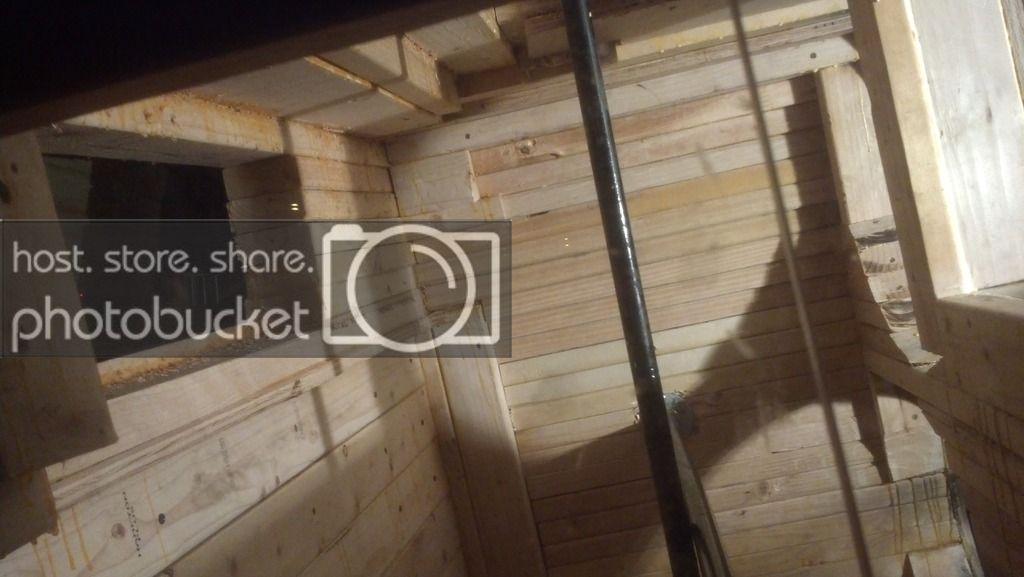

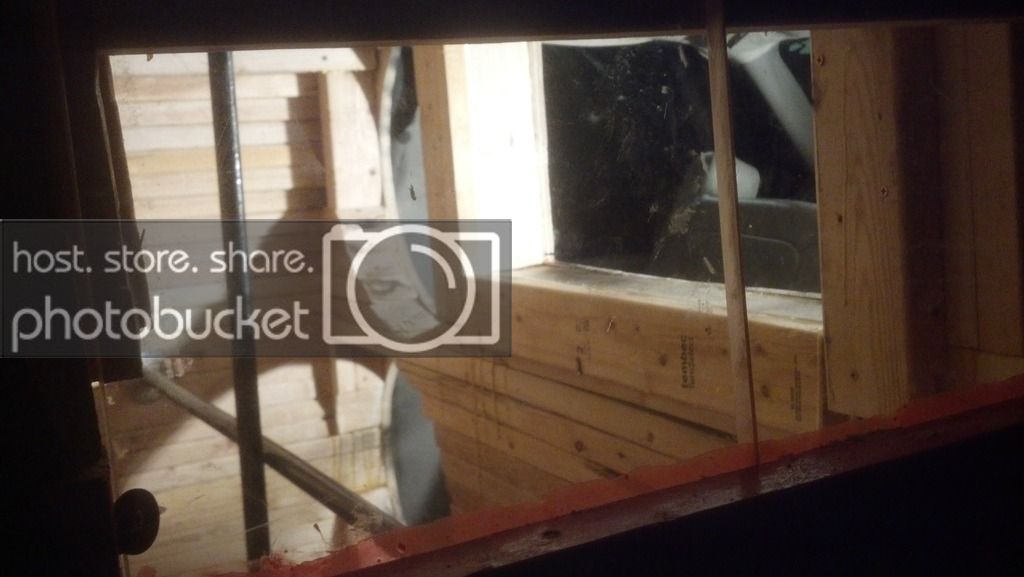

All the wood pieces of the enclosure are cut, glued, and screwed.
Tomorrow, I hope to add the last couple more steel pipes that will brace the baffle with the back wall, then resin everything.
Box came out to be about 32 cubes net tuned to 30-ish after all the 2x4's and bracing

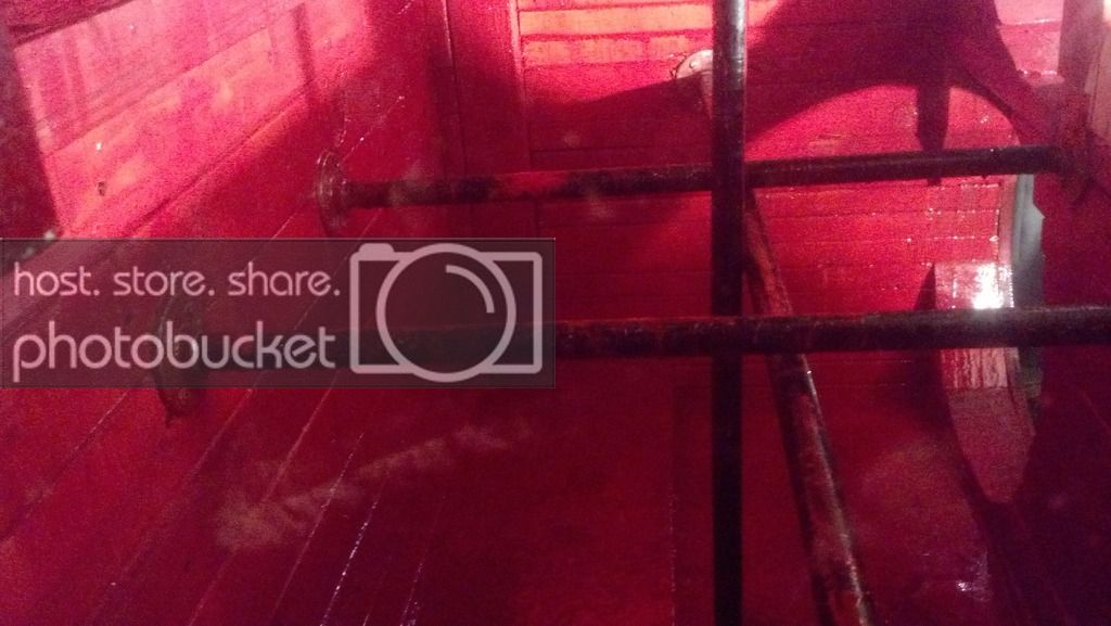

Still working with the same 50 2X4's or have you bought more? Since you have the volume to spare, why not add layers to the top and bottom?
I still have 12 2x4's and a sheet of 3/4" 4'x8' birch left. I only used 38 out of the 50 2x4's, surprisingly.
I was thinking about adding another layer to the top. The bottom is hard as shit, because all the resin drips down the walls and collects there
Ever feel a fiberglass canoe? You have to build that stuff really thick before it's really adding rigidity. You have the materials and space, why not reinforce everything?
I have felt a fiberglass kayak. There's about 1/4 inch of resin on the bottom. I think that's pretty thick. I might add another layer to the top
Fiberglass matt is cheap as ****. I would throw down a couple layers to help strengthen it up. The resin gets hard but at the sane tune it's brittle as ****. I had some on my garage floor that flaked up and broke to pieces rather easy.

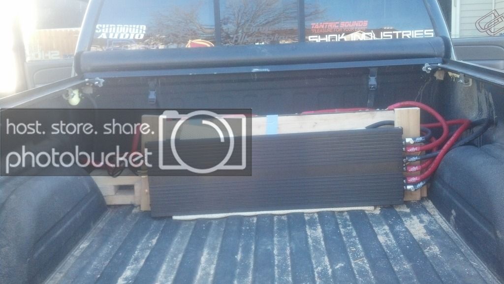

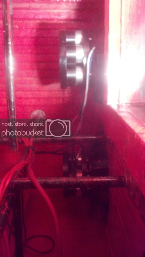

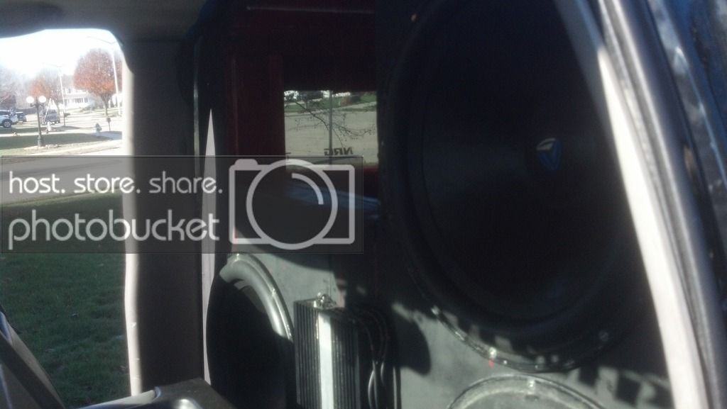

Sorry, pics aren't fantastic and I haven't shot a video yet.
Pictures don't really show how big this is, lol
Not super pretty, so I'm thinking about making a beauty panel inside the bed
