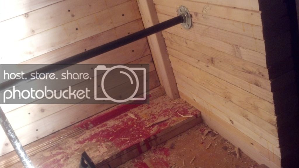

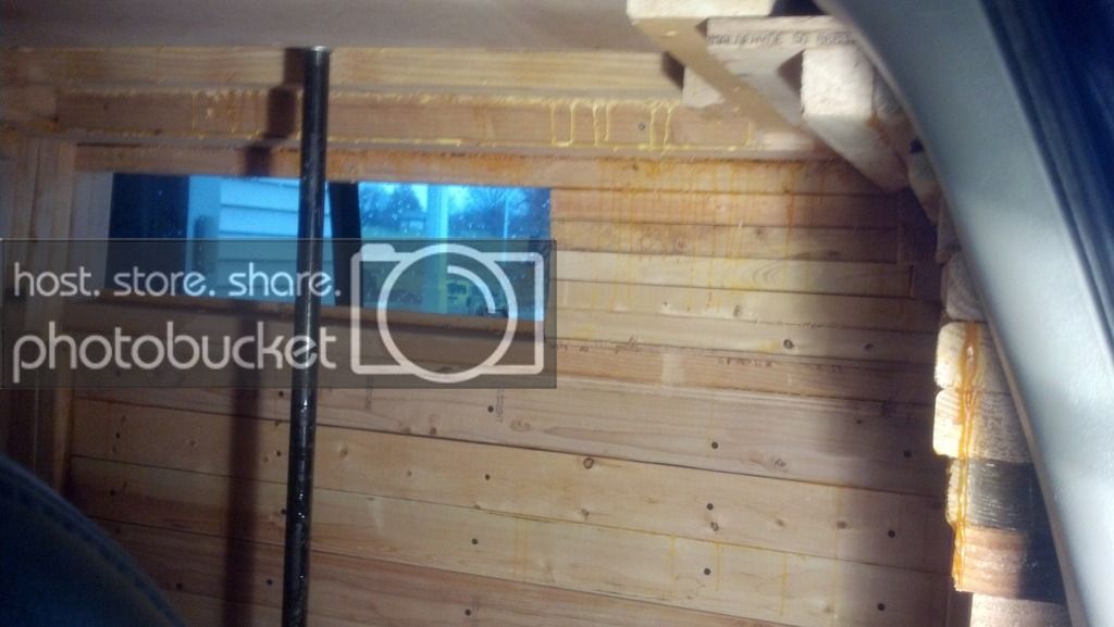

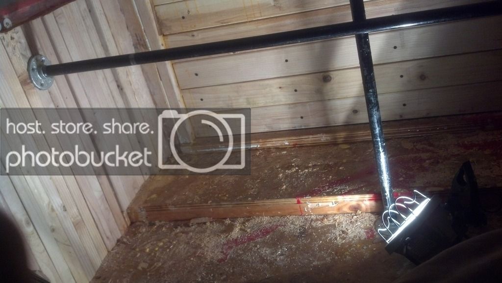

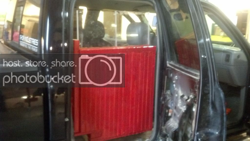

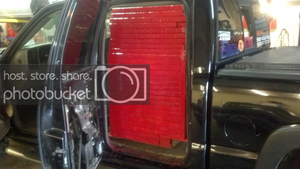

Got the sides/ceiling and covered with resin on the outside
Tomorrow I'm hoping to do the baffle. This is the part I am least looking forward to. I wish someone else could do it for me.
After the baffle is done, here's all I have left:
1. Coat the inside of the wall with resin
2. Screw in the rear plexiglass and seal around it
3. Cut a bigger hole in my bed
4. Run RCA's and other small miscellaneous wires into the bed
5. Finish my new bus bar
6. Mount the TFE
7. Wire up the TFE to the subs
8. Mount my 125.4 and wire it up
9. Finish re-doing my door pods and figure out what to do with the tweeters
I really can't wait to be done with this. Lots of shit going on, and haven't been posting on the forums this last week or so

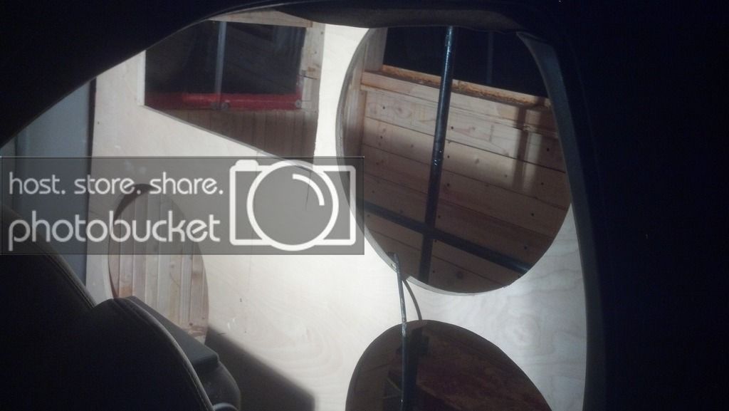

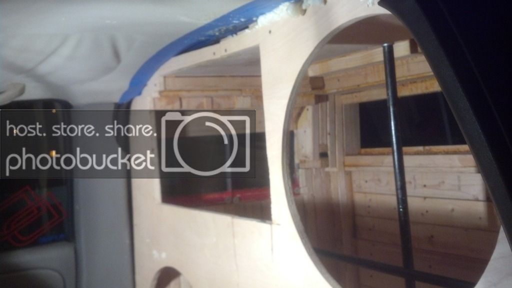

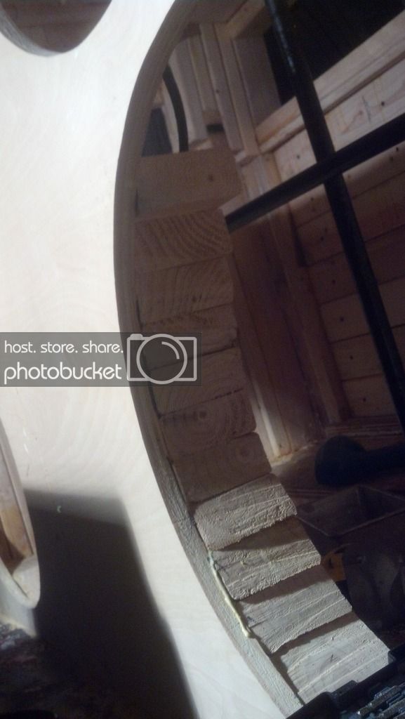

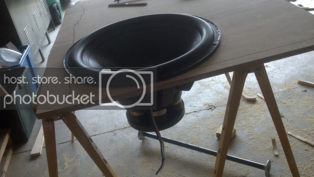

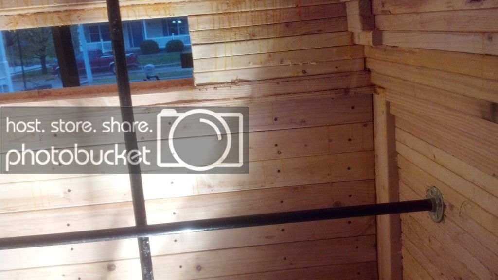

I cut the baffle in one piece, then couldn't get it to fit, so I had to cut it in half.
Then I got inside and traced the edges of the side walls so the cutouts fit

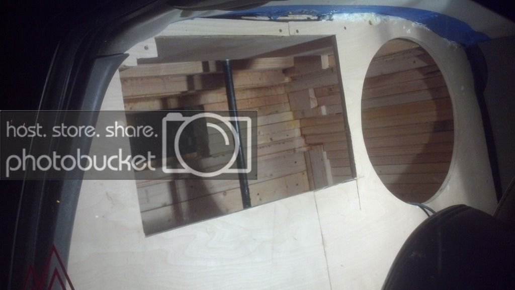

Then came actually mounting it after the sub holes and port were cut out

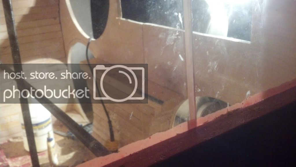

I'm almost to the top of the bottom cutouts with the inner 2x4's //content.invisioncic.com/y282845/emoticons/smile.gif.1ebc41e1811405b213edfc4622c41e27.gif
^That's a really slow way to do it, just letting everyone know

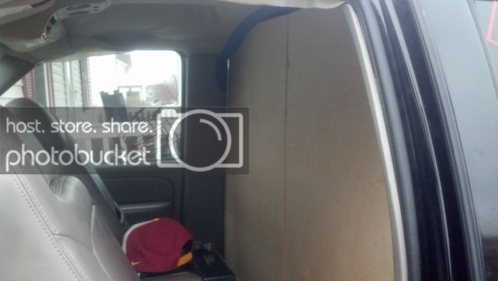

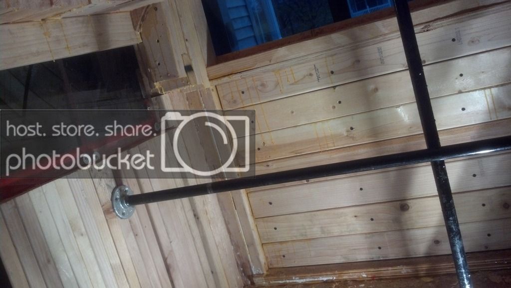

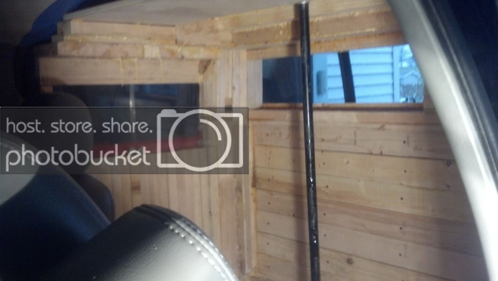

All the wood pieces of the enclosure are cut, glued, and screwed.
Tomorrow, I hope to add the last couple more steel pipes that will brace the baffle with the back wall, then resin everything.
Box came out to be about 32 cubes net tuned to 30-ish after all the 2x4's and bracing
