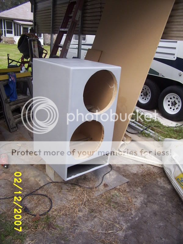

to take the screws out and solely depend upon the glue...i wouldn't pay for that. yes, i know the majority of the strength comes from the physical bonding of the glue, but if you generate enough pressure....and yep, i've seen it a few times over. my advice? keep the screws in, and countersink them. if your bondoing the box anyway, it's not going to take any longer to fill with then it would without. and if you countersink, you can always router with the base on the screw side to avoid indentions as well.

agian, you do understand that carbide bits at 15000 RPM and screws dont mix right?
I've build boxes using strictly clamps and glue and they are just as structurally strong as boxes with the screws left in. This isnt going to be a 170dB set up that has the ability to shear wood. In order for the screws in the ends to add any stuctural integrity to the enclosure the forces on it would have to be so great that the wood would tear.
I understand your concerns but agian, this thread isn't about the mechanics of my enclosure construction process. Beleive it or not I've built and installed an enclosure or two in the past few years. I'm sorry for the hostility but screws on the edges of the wood simply are not going to add anything to this box. If you can show me defenetive results where screws kept a joint togather that was bonded correctly with wood glue I will tear the box down and start over.

Just saying that you are taking to many steps by taking screws out...Unless you are doing like a huge roundover I hav never had a problem with hitting a screw.

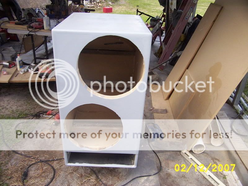

Primer is rolled on 5 of the 6 sides. 2 costs out of the 3 anyway. I'll get pics up in a bit. //content.invisioncic.com/y282845/emoticons/smile.gif.1ebc41e1811405b213edfc4622c41e27.gif
The paint I'm using will cover any imperfections. It's high build so I need to sand it one last time with 150-200 before I do the final coat anyway. //content.invisioncic.com/y282845/emoticons/smile.gif.1ebc41e1811405b213edfc4622c41e27.gif
