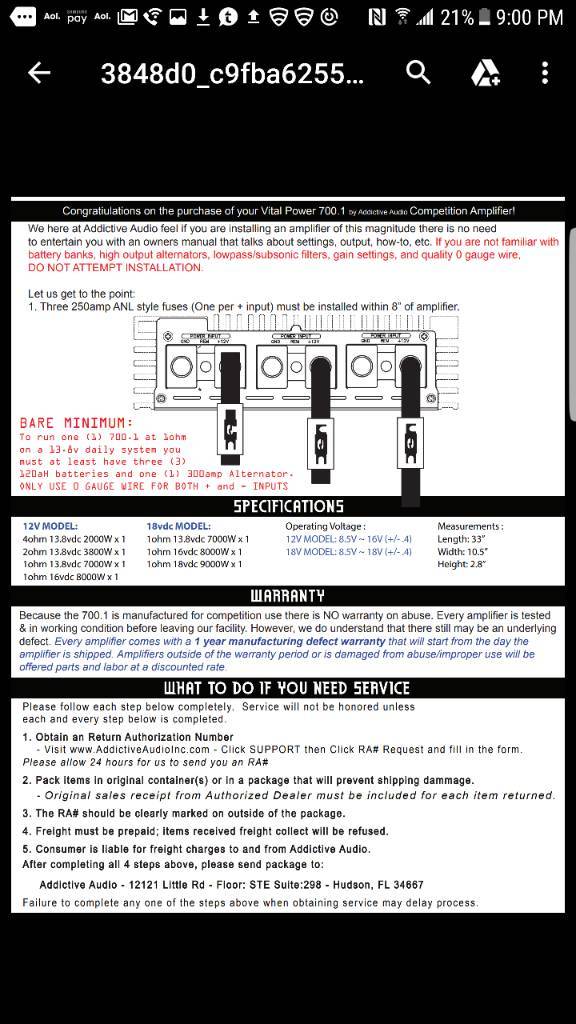

buddy that owned both the alphard 12k and this vital 700.1 metered louder on the vital and was overall louder.

Nice proof. Saw a lot of forum talk on here about it. Can't find where to purchase it at online? The website is terrible and doesn't even come with a description of the amp. I am convinced.. but I don't understand it. Don't hate on this statement but when I was looking into the Orion HCCA 5k amp, it's listed 7k @ 1 ohm. It's less than $999 too...so I don't understand what the Vital 700.1 gives me that the Orion HCCA 5k doesn't when I am even saving money on that amp.

Build quality the vital power is built like a tank and way underrated the Orion 5K is nowhere near in the same league if you tried to wire that Orion amp up at .35 like they did that vital that was just posted in the picture above it would be an instant death sentence these guys are 100% right about that amp for the price it is unbeatable right now
I get what you mean then.
