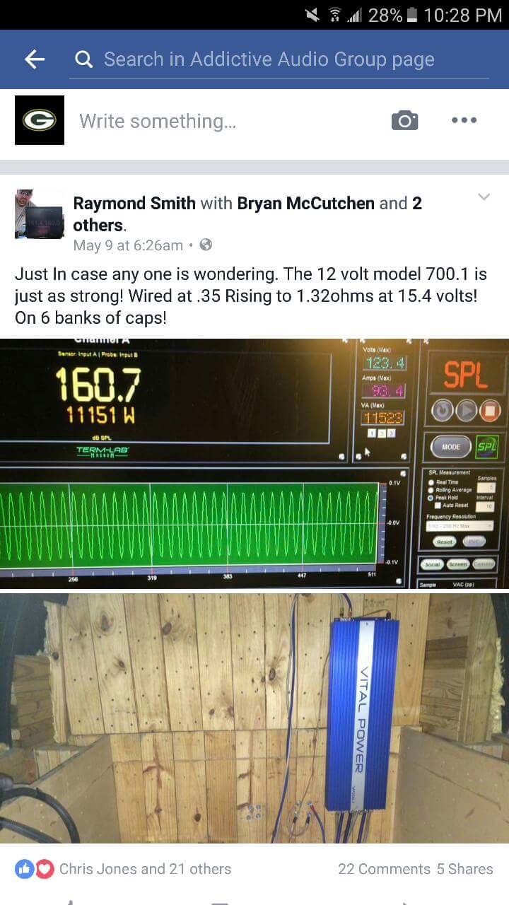

BigDWiz is a amp dyno guru lol. he did one here:
buddy that owned both the alphard 12k and this vital 700.1 metered louder on the vital and was overall louder.
