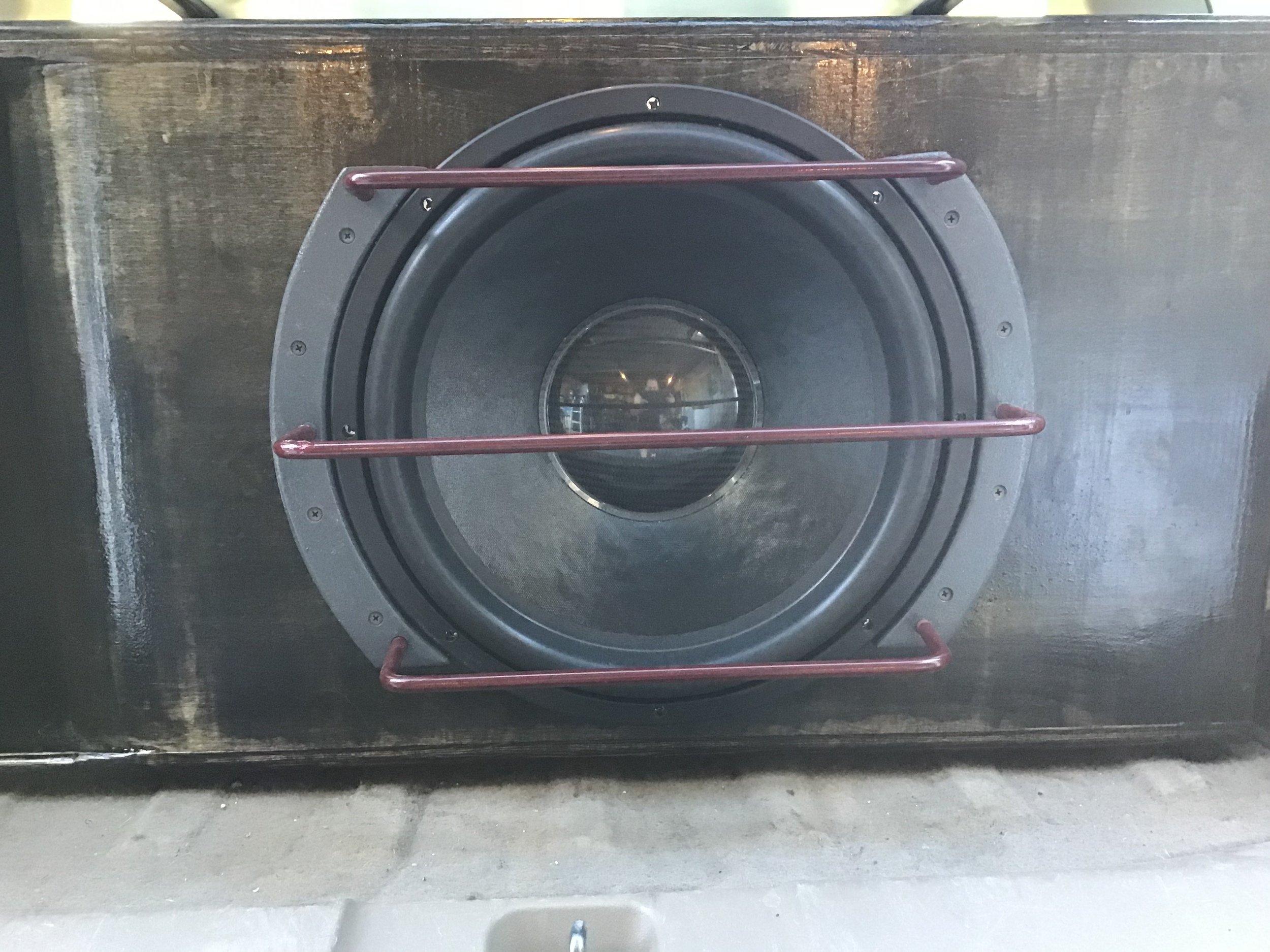

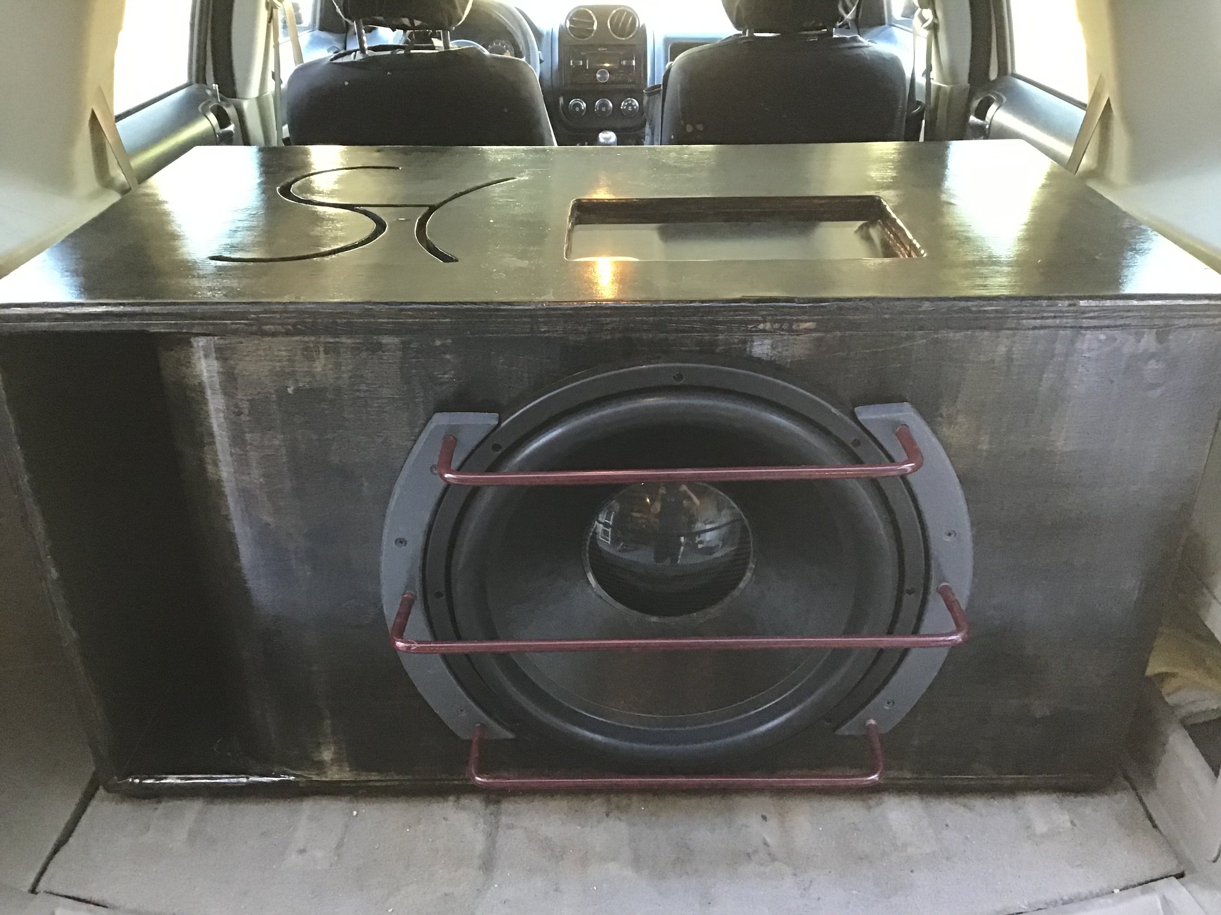

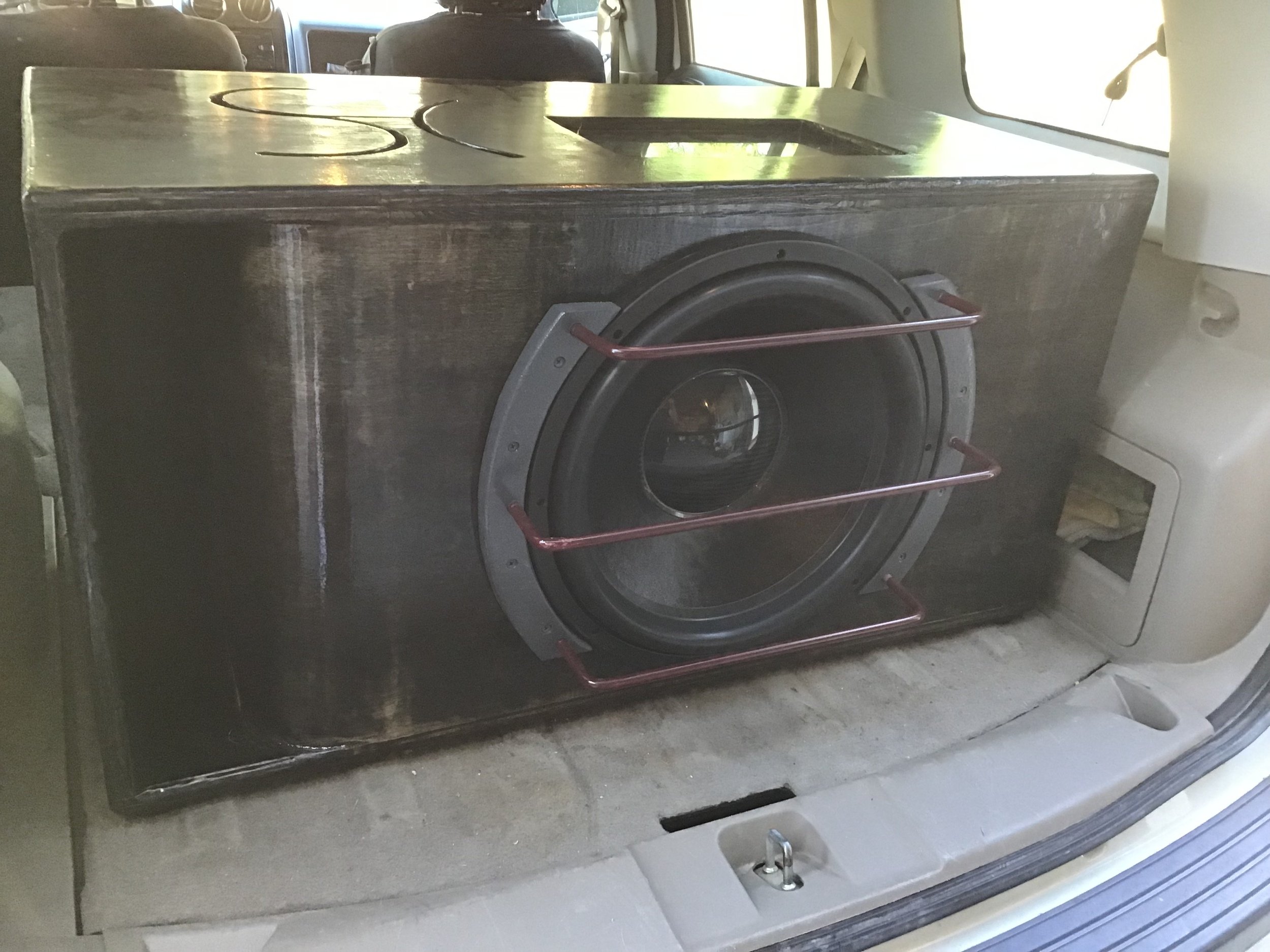

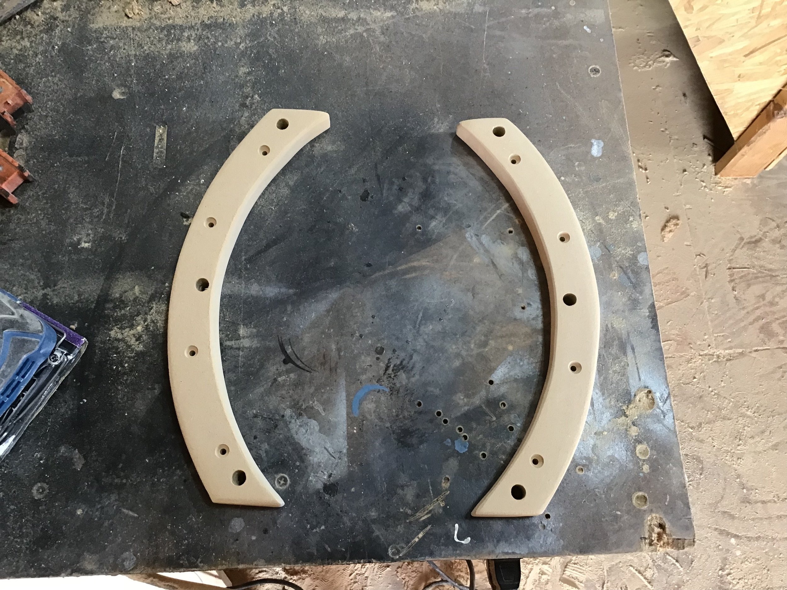

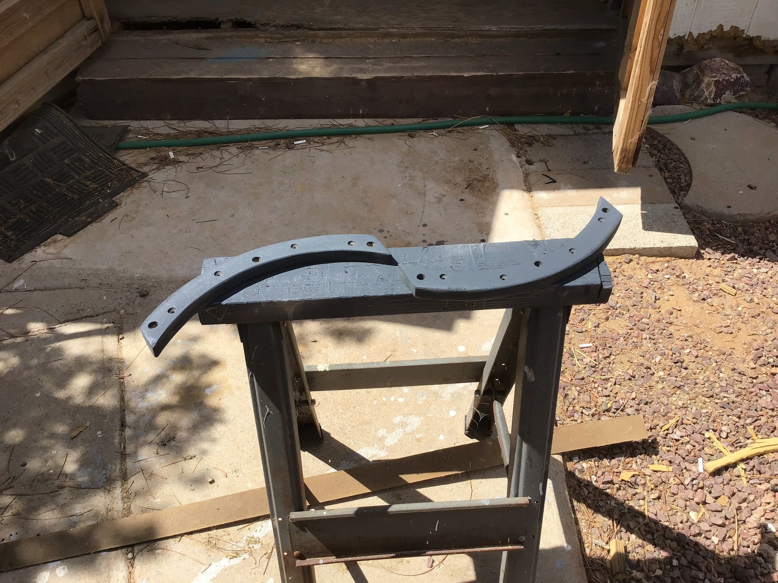

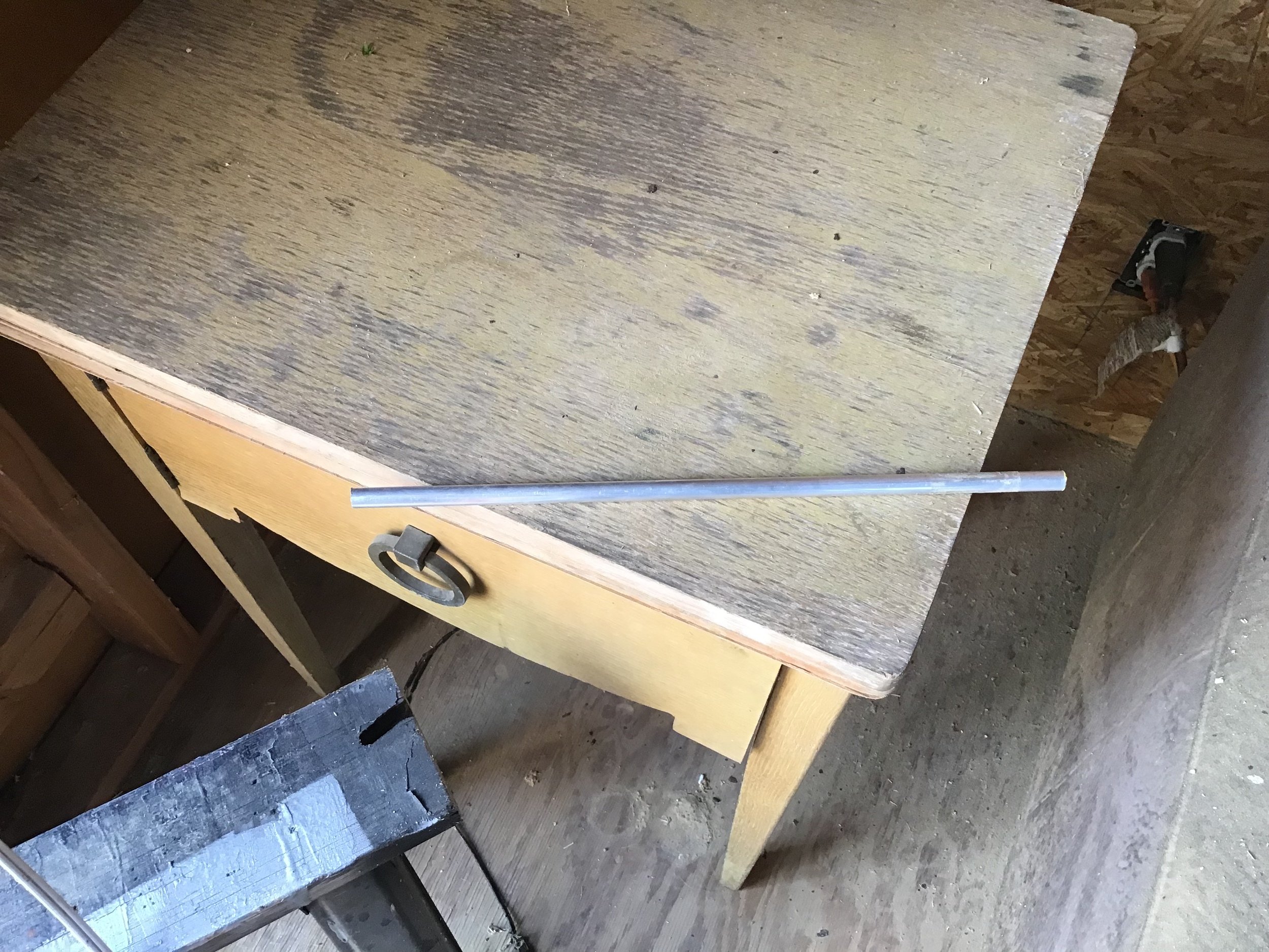

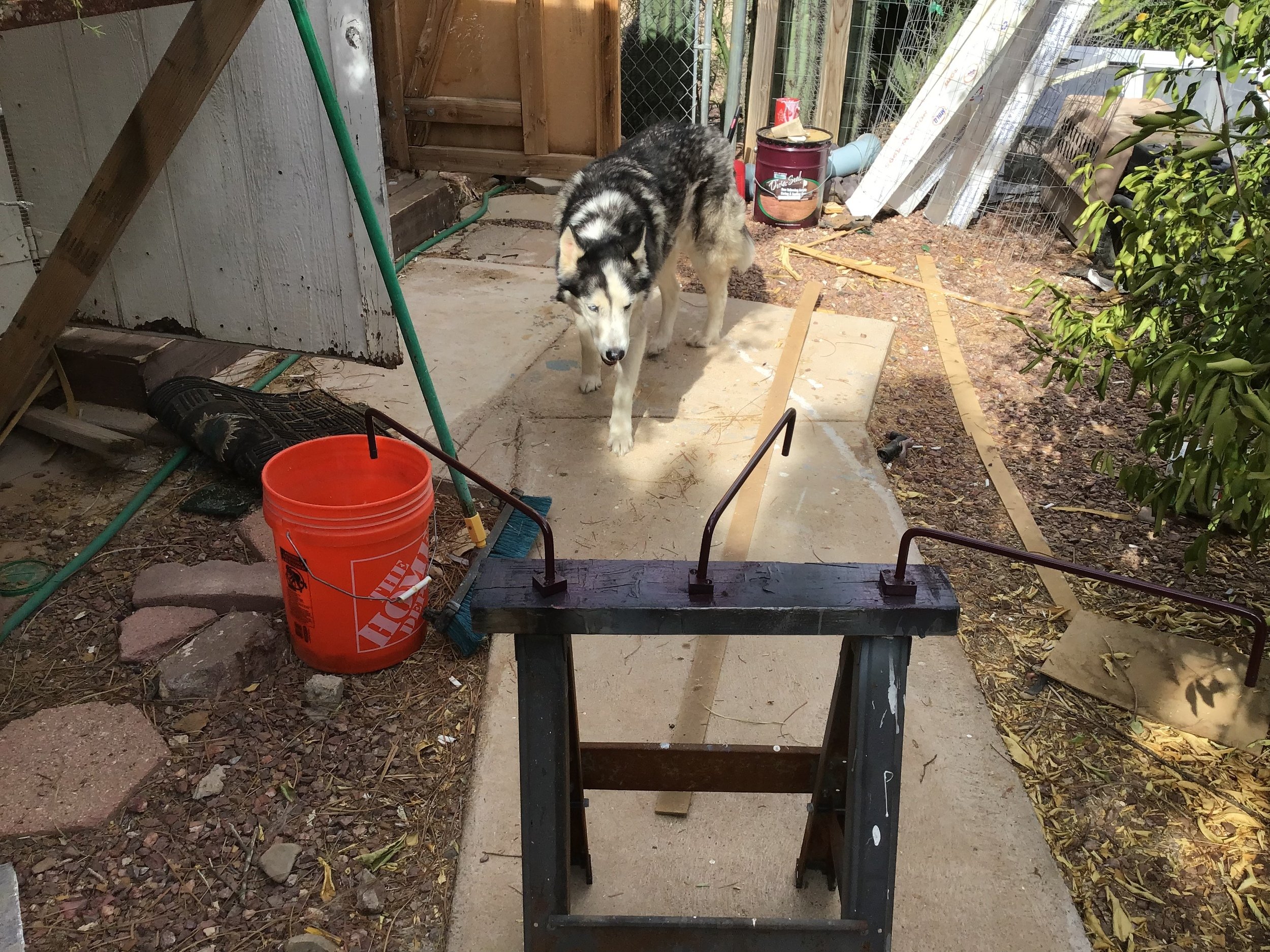

Making some speaker protection today. Got busy and havent had time to do it. Just bought some 3/8 inch aluminum rod, drilled a 3/8 inch hole on a 2x4, then bent them to 90 degrees…..or close anyway.
