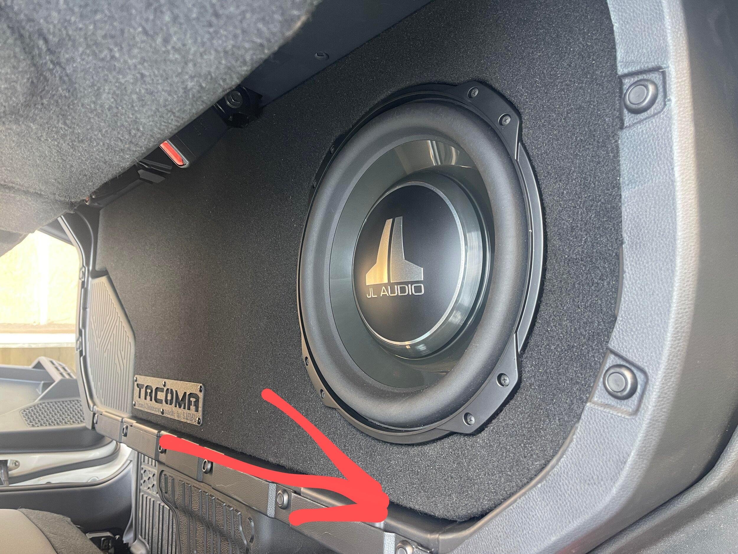

So the underseat storage area where the box is sitting-in....
Have a consistent rattle when bass hits on a rap song...
I lift the box just a bit & rattle gone, box is wrapped in carpet so can't be the box resting on the plastic contributing to the buzz / rattle...
Its a plastic underseat liner, & there's a separate outer perimeter trim piece...
Going to have to quickly pull the box out & give the liner & trim piece a good deadening..
Just curious what some thoughts are to better approach?
Since its 2 similar plastic materials touching & overlapping one another.
Best to use the hybrid closed cell foam stuff similar to sound skins?
or just use the 80mil amazon basics butyl / foil deadener & the weight / mass addition will resolve my issue..
Yes, overthinking as usual, just want to go in once..
This is pluzzling. You lift the box a bit closer to the seat's liner and the buzzing stops; yet the seat liner is the one that is buzzing? Could it be not the junction of the liner with the trim piece but a bare wire of the seat's wire grid hitting on the liner?
I roll around with the seat bottoms in the up position.
Still also does lowered.
Lifting part of the box up off the liner just a fuzz, lessens the violence......
hence the rattle gone!
I just need to deaden the plastics & questioning if there would be any benefit using the soft hybrid stuff since its plastic to plastic.
Im guessing not, just use the butyl / foil.....???

Getting some rattles from the underseat plastics..
Would deadening it with the butyl / foil deadener be sufficient or due to plastic to plastic overlap / contact of the liner, its best to use a closed cell foam hybrid like sound skins pro in this situation?
Thanks...

Going to give this a bump, could use so advise as just want to do this once.
Thanks...
If you're getting plastic rattling against something, then try putting foam between the parts. If it's a panel resonating, then you use a butyl deadener to weight it down and lower the frequency and amplitude of the resonance.
