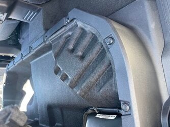

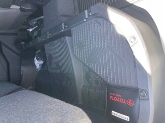

Not many options out there for sub enclosures for the new 24 redesigned tacoma.
Enclosure behind the seat is nolonger really an option, limited space, seatbelts, power window motor assy, etc...
So under the rear seat is the only option.

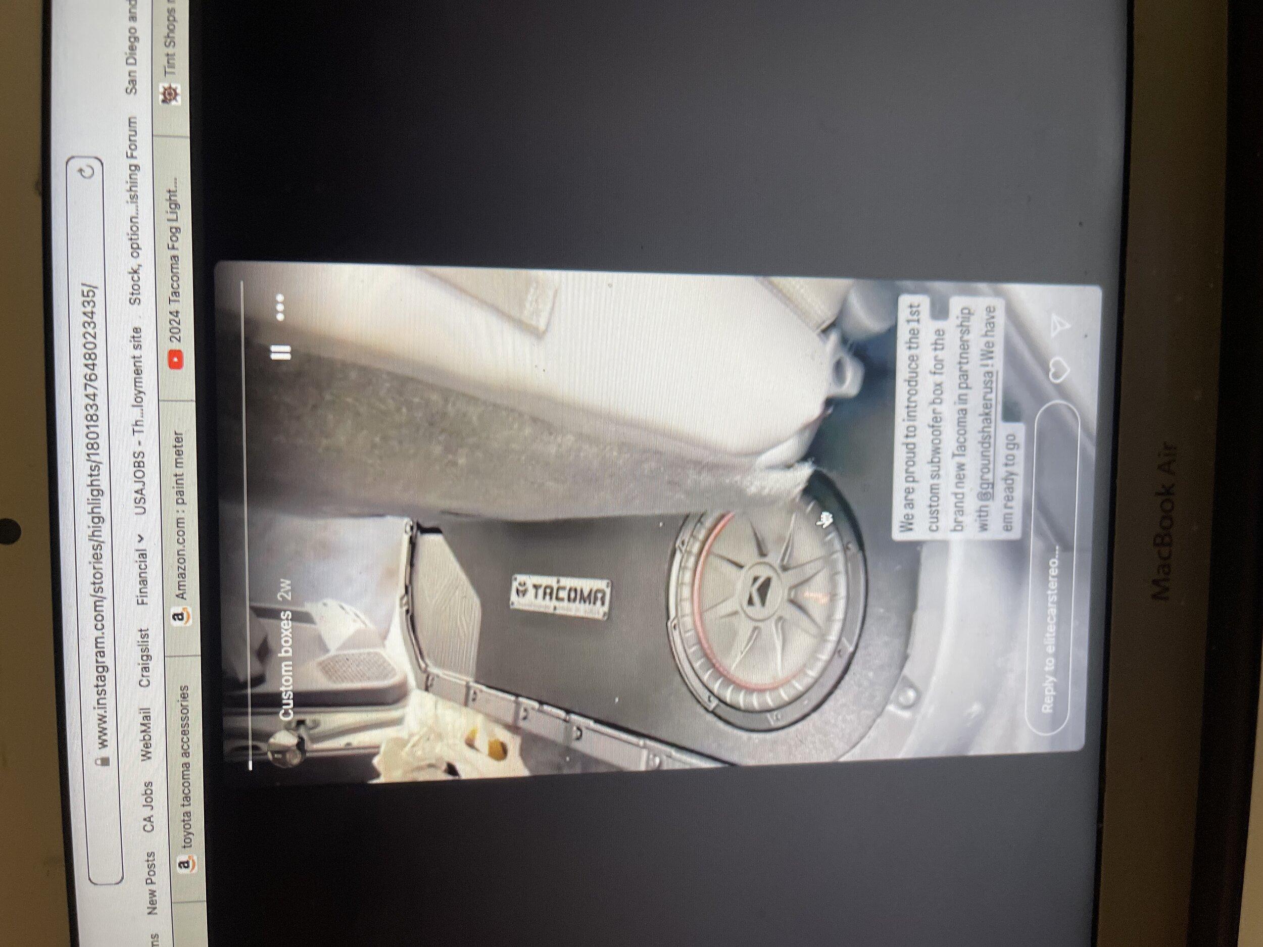

Ground shaker fabbed a decent enclosure & from the few folks / shops I spoke with seems like for the enclosure volume & truck cab config the 10" enclosure would be better than the 12" enclosure.
Both boxes have same volume, just larger speaker cut-out...

That doesn't look easy to work with. Porting allows you to get "free" bass and contour the response curve a bit. Ported tends to work better for Rap & Hip Hop.
Wouldnt be the end of the world cutting a clean round port in the plastics to accommodate a port but dont think I want to start hacking a new $40k truck...

I get it. Looking at what you have going on under the seat (WTF Toyota), I'd probably go with the that ground shaker enclosure and the biggest sub you can fit. Looks like there is a 12" version of that box. If you can find a 12" that will fit in there and is comfortable with ~.95 cuft that's a simple solution. I think porting would be PITA for your situation.

I recently heard the GS box with a 10tw3, wast very impressed but I question if the gain was turned down cuz mids & tweeters didnt have an amp source yet as controllers arent available.
So between the groundshaker box option for under my rear seat would most go for the sound quality of a 10tw3, or go all in & get the 12tw3 box option.
The box has plenty of airspace for the 12, .95 cf...
