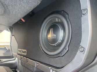

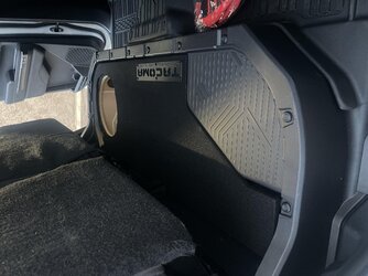

https://tacotunes.com/product-categ...de-products/2024-tacoma-subwoofer-enclosures/
No pricing yet but here’s some pictures and options for the Taco Tunes enclosure behind the seat. Single 10 ported, single 12 ported, dual 10 ported, all boxes are 1.35 ft.³ of airspace.
The dual 10 peaks my interest ….
But no specs really given other than one .35 ft.³ of airspace, the claim, and you can install a subwoofer that is not a shallow mount.

just text TT, he's claiming 5.6" mounting depth.
Can do a 1 fullbody 10 or 12...
if you do 2 10's, need to go 2 shallow mounts, no partition, 1 port.
"more info coming soon"

If you really like that rear seat enclosure, then I'd probably go dual 10s and plug the port. Look at pole vented subs (hole in the bottom of the magnet/motor) that are ~5" or less in depth. Or look at subs that don't have vented motor up to 5.5" deep (ie Sundown shallow mounts). Alpine Type S comes to mind. I think Anthony has a pair of them for sale on here. The Alpines also have the multi-roll surround which creates a little more space in front of the sub. Sundown has a few shallow mounts that would work too.
