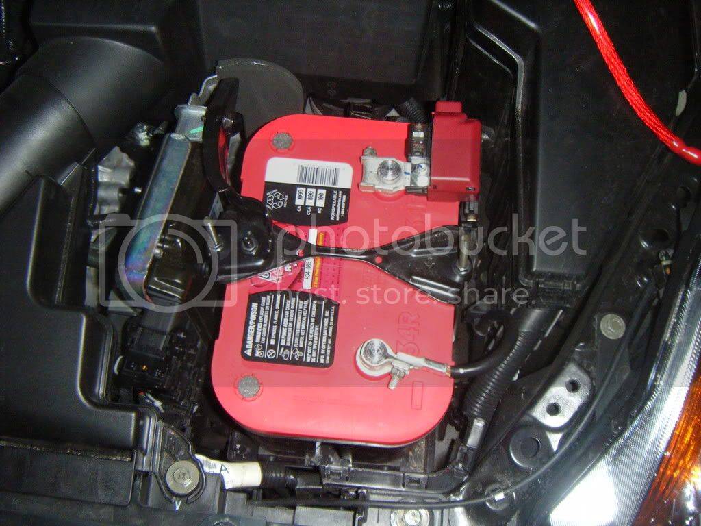

Got all new equipment in for my altima, getting ready for Maryland meet next weekend. First got red optima under hood and yellow for in the trunk.

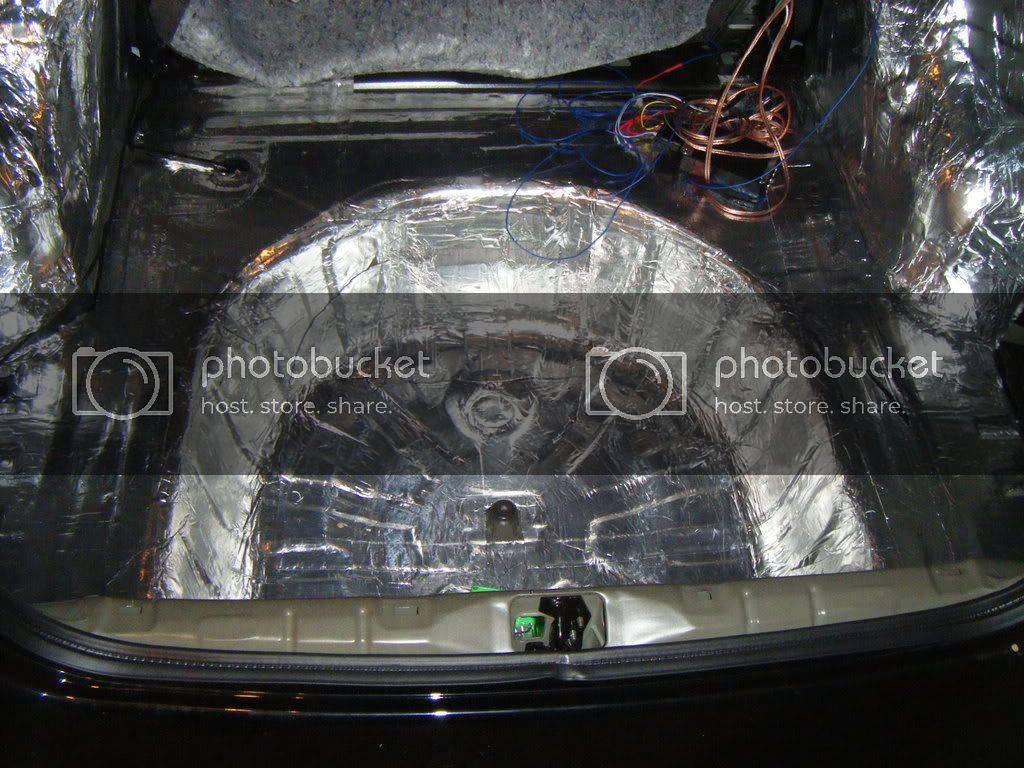

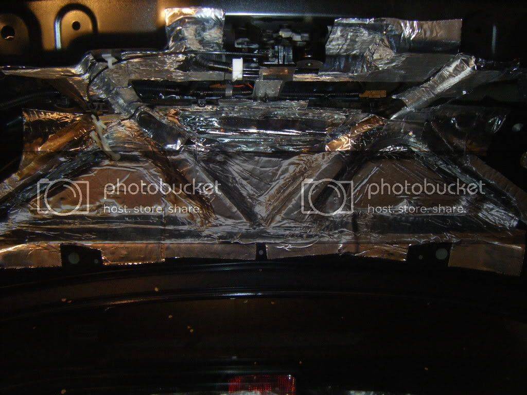

Next I installed 40 square foot of second skin damplifier pro in trunk.

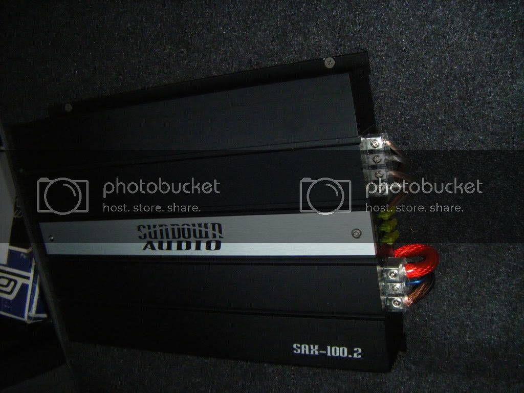

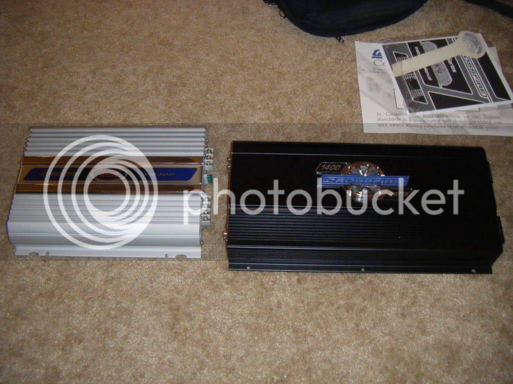

Amps going in tomorrow.

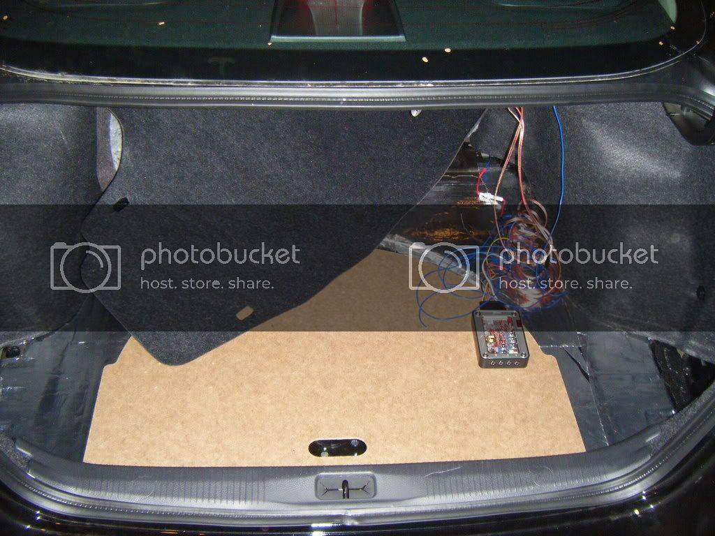

Ran out of time to finish will wrap everything up tomorrow.

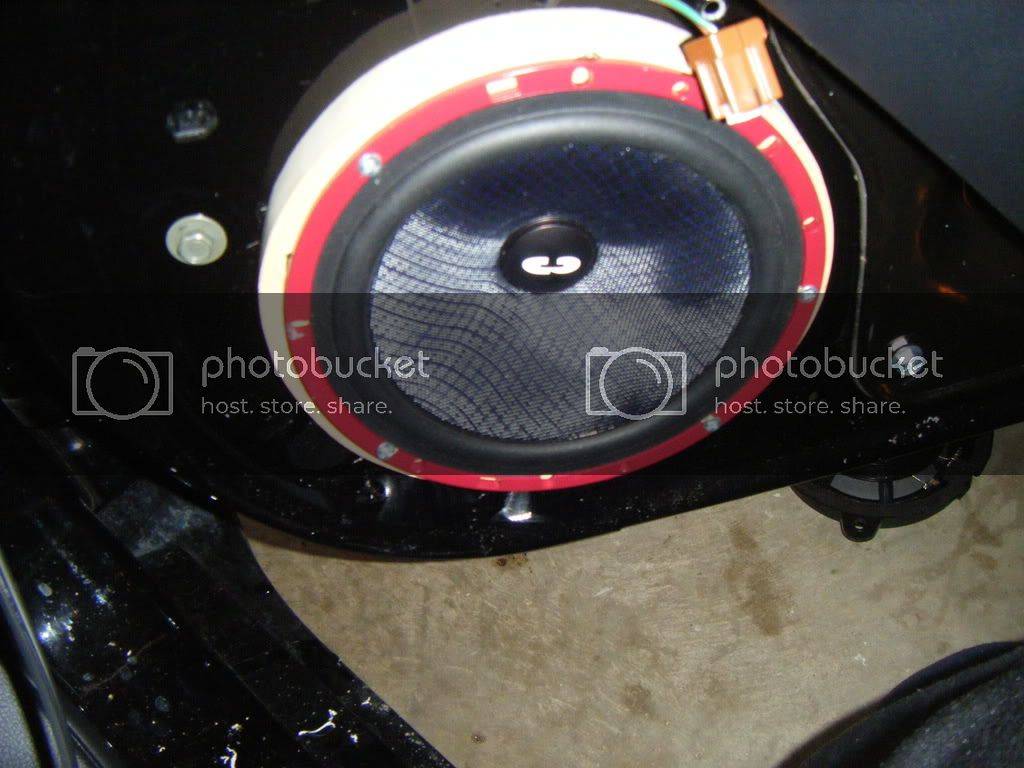

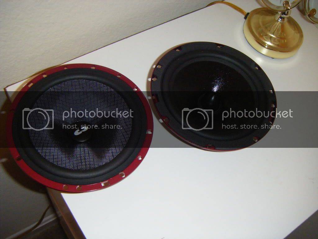

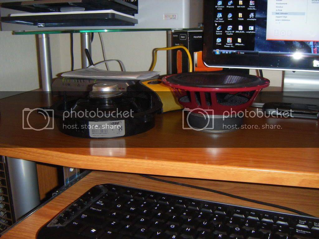

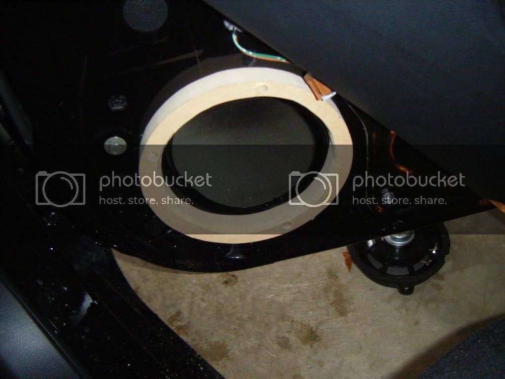

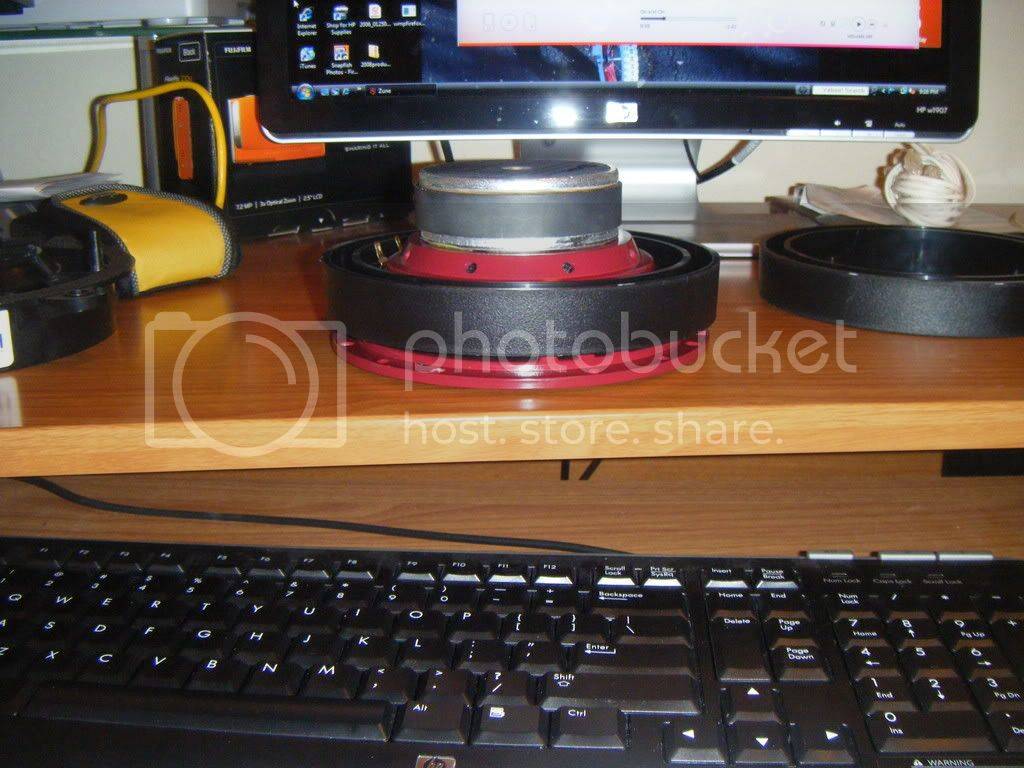

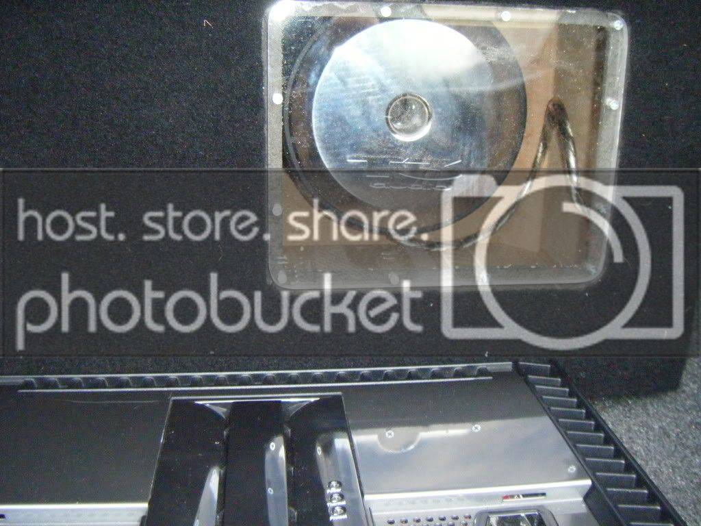

huge set back, I got the stock bose speaker out and found that the mounting depth was way to much for the car and the bose had neo magnets. But I had spacer rings laying around from year back and they were for 6.5's but the cdt's are to big for the rings as you can see in the second pick. Oh well guess I will make them out of mdf tomorrow.

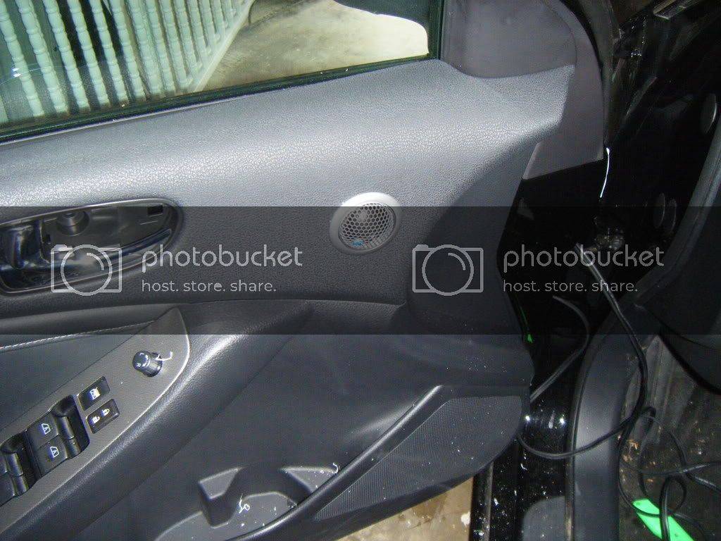

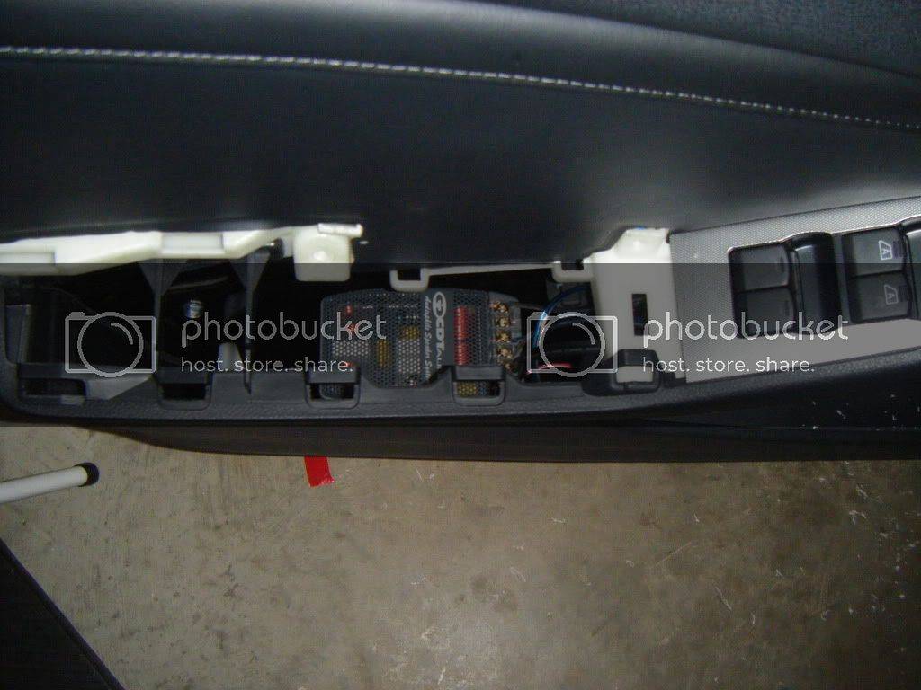

Doors all finished up everything looks good, but the driver side dash sticks out a little further than the passenger so the tweeters look different but if you open doors they are the same.
Looks good man I would move those crossovers though to inside the car just in case water gets in there. I've known people that had it happen to them, just a thought. Subscribed.
