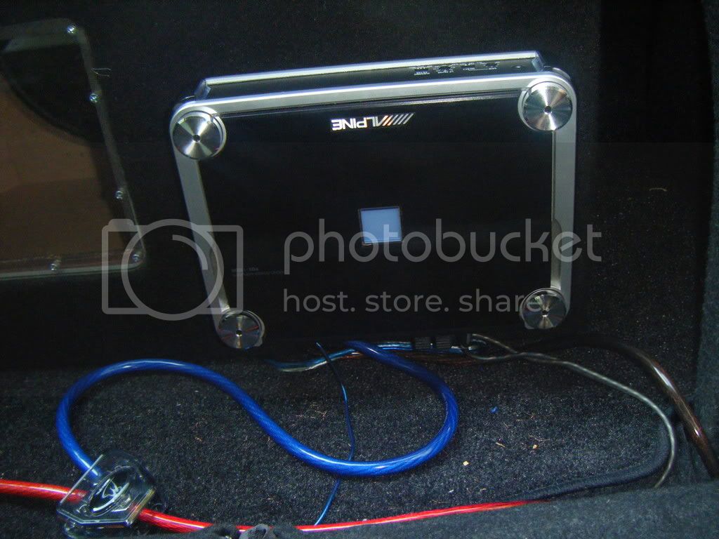

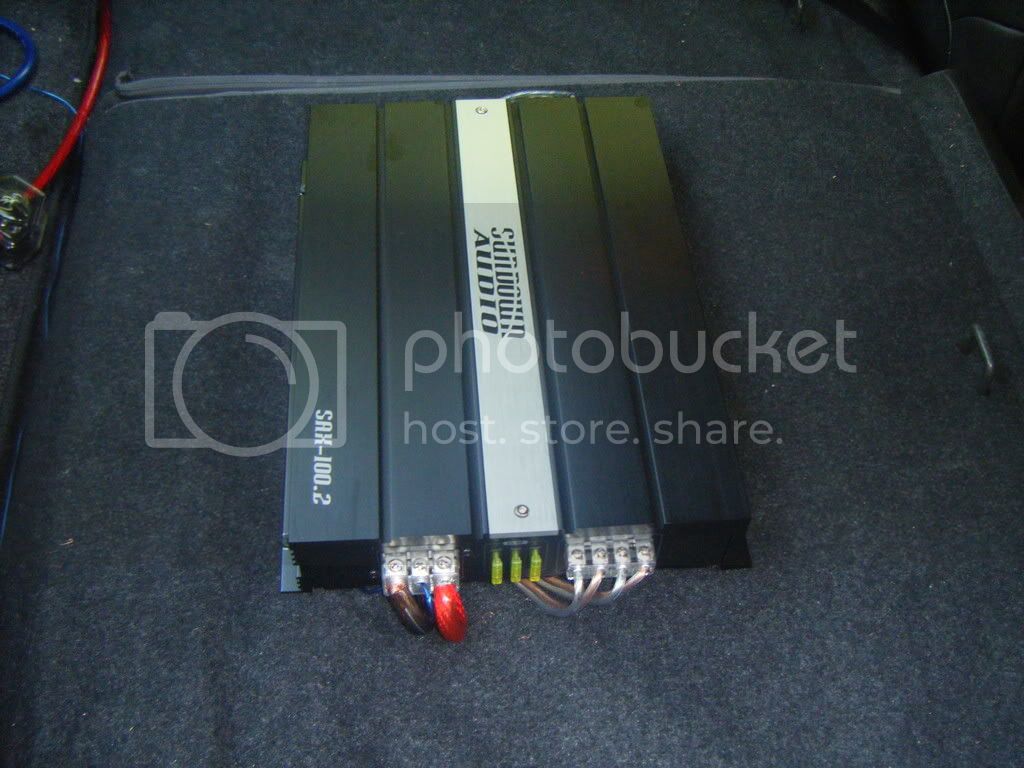

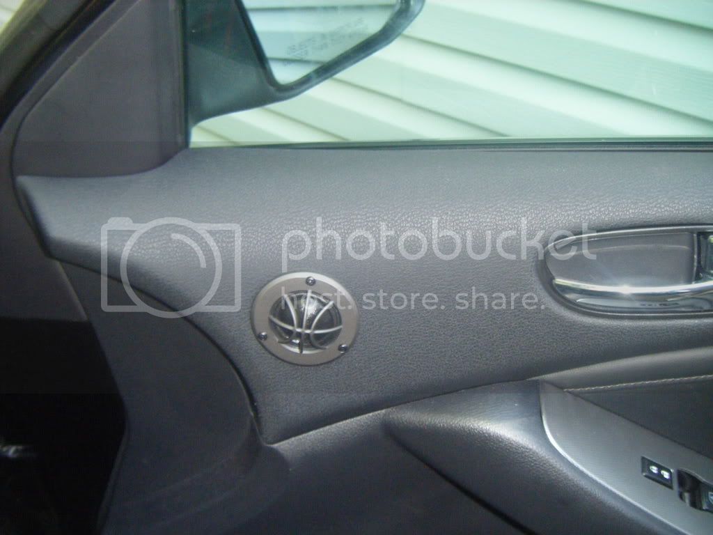

Got around to installing new substage and compponents today. Running a Arc Audio Flatline off of a PDX1.000 , I love this sub I believe it sounds just as good as IDMAX but get louder and handles more power. Also installed DLS Iridium 6.2i's running off my sax 100.2 passive which they sound amazing. Pics below but forgot to take pics of the dls install besides tweeter.
