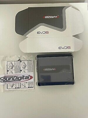

I personally would keep the 3 way in the doors as they are with a newer set of speakers. CDT has a nice HD set to look at,and you can still do the rears as well to fill the Cavity space. And maybe replace the sub with something a little bit better maybe in a small ported enclosure or a sealed with a decent 5 ch? or go with a nice 4 ch and id do a min. of a 600 rms substage to keep up with the rest of the system and on its own power and tune accordingly. The center speaker can be omitted/more than likely not needed with a decent 3 way set up.. this 5 ch has a decent amount of power for the $ one to consider. I believe you have access to Sound Digital Evo X series 800.4and an Evo 800.1? Maybe look at the Evo series for compact design and space savings? A little pricey but compact.Shop around for better pricing. CT Sounds CT150.4 has some nice adjustments on it and fairly compact and the 700.1 mono amp if you have an option to get those? Ground Zero may be another to look into that you may be able to get within your location?
For $20 bucks more and If you give the space up.. Id pick up the 1k
Thats me though.Just a couple recommendations
