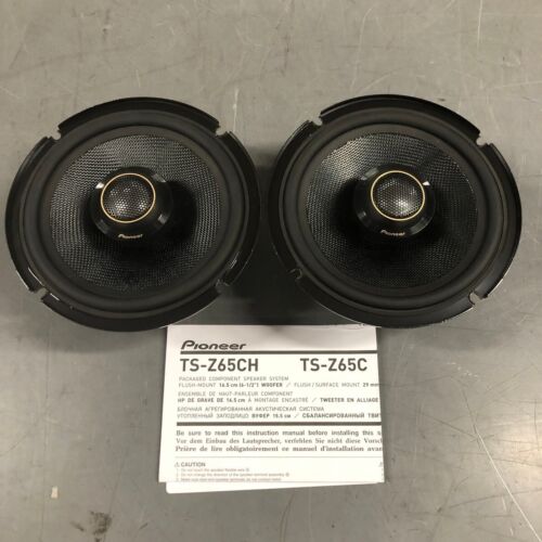

You don't really want coax and tweeters up front together. You can use the existing wire and run them from the crossovers on these upfront. I've used them and can honestly say they are really good comps, exceptional for the money. I'm not a fan of mixing and matching and this allows you to keep them the same back and front and they are about half off. Use both sets front and back or use the woofers as full range fill:
$99 for one or two sets depending on if you prefer to go this way for the rear (recommended if available) $99 a pair either way

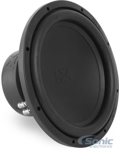

For the SUB:
The other option is to use the coax and comps with this:
$280.00
You will need this either way:
Amazon product ASIN B0C8V972Z7

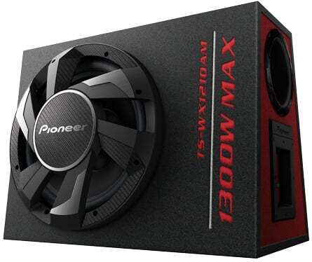

Then this would be a great option for sub:
Amazon product ASIN B0007XV5HW
$80
and this to go in it:
$90
This leaves plenty in the budget to run wire, fuses to the trunk for the powered sub, and speaker wire for the passive should you go that route.

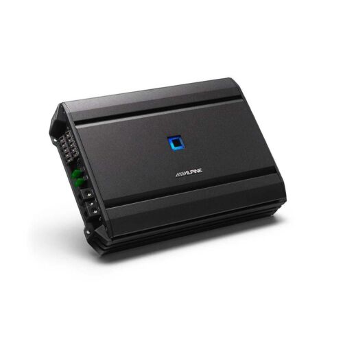

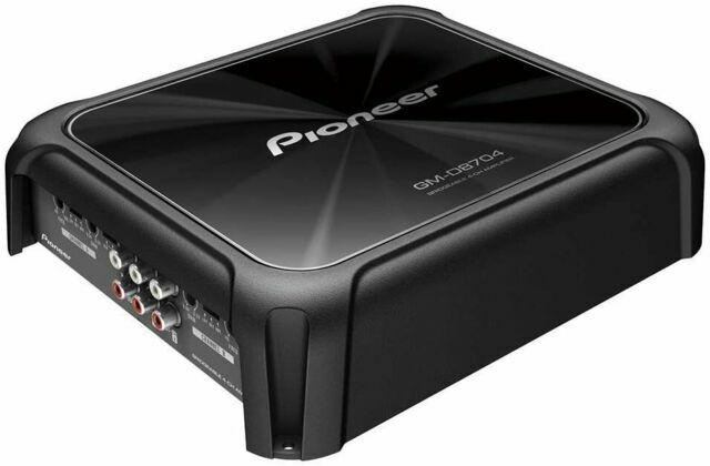

One other question. The Pioneer speakers are 4 ohm and 100W RMS rated. The Recoil amp does 80W @ 4 ohm, and the alpine does 40W @ 4 ohm. Wouldn't both amps be underpowering the Pioneer speakers?
No. Speaker ratings while important are more indicative of their capabilities. Having a rating of 100 watts, generally speaking, puts them in a better class of speakers. If anything, and if you can afford it and if it fits, this would be an even better amp at 100 x 4 (not thinking that you will hear a whole lot of difference but I like these amps and use them often).
What you wouldn't want is a speaker that was rated at 40 watts getting 80, that is an actual problem, the scenario I configured is a win/win with either the Pio amp or the Recoil.
The only reason that I suggested this option is the price/performance. IMHO, right now, they are miles ahead of anything in that price range as they routinely cost 2 to 2.5 times the selling price. There is never any harm in getting something that is much better than what you need if the price is the same or better than what you would usually get, You will not be unhappy with those in the car. I run the 110-watt RMS per side version in my car with about 3500 watts of equipment and let me tell you, they are fantastic. If these were priced normally, we would be over the budget as we would be close to $450 for the speakers alone.
If you go out and shop pretty much any other brand that will take 100 watts RMS, they start around $200-$250 and go up from there. the link to the coaxial speakers I listed is the key. If you can snag those the comps are a no-brainer. $450 worth of speakers for $200, that's easy.
