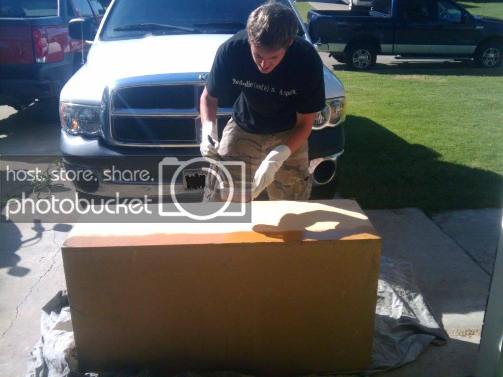

Yeah we put the water hose over the bed and it comes right it. Box has 1 layer or resin on. Do we have to sand it when it drys to make it not so sticky?
Just set it out in the sun and it should dry real fast. Did you use a good amount of MEKP? Even if you went really easy on it, it will harden eventually. Just wait for a hot sunny day and leave it out in direct sunlight.
Also instead of a tupperware container and a huge paint brush, just use a 2 1/2 qt bucket from Home Depot or Lowes. Its like $2 and is reusable forever. Just leave the brush in it to harden then pull the brush out and the entire bucket mold pops out and the bucket is like new every time. They also have a smaller size thats good for smaller jobs.
