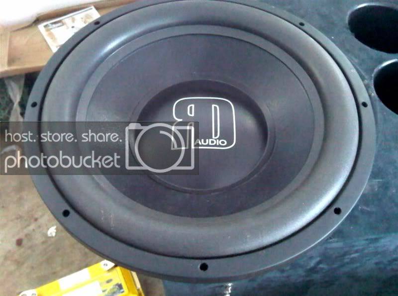

- (2) RD Alpha Max 15s with HW softparts

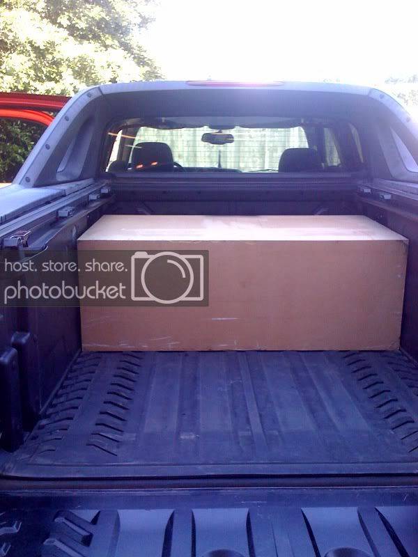

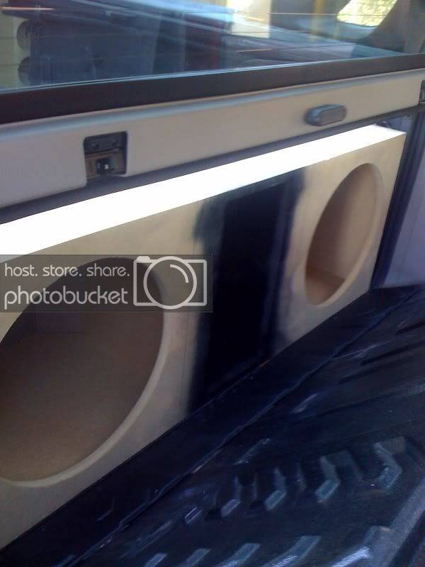

- Box is a blowthough, thorough the midgate. Tuned to 32hz, 45s in corners, and resined. It's being build by a local world record holder box builder //content.invisioncic.com/y282845/emoticons/biggrin.gif.d71a5d36fcbab170f2364c9f2e3946cb.gif

Later on he'll probably get another AQ2200 and strap 'em. Should be loud! Everything is basically in the mail, so more pics as it happens.
May be adding a double baffle later on. There is about a 2'' gap from the top of the box, will expanding foam work for that?
Thats going to be a bitch to seal. The box in my Avalanche is 49.75" wide by 21.5" tall and after the first foaming it still leaked like crazy. I have about 1/8-1/4" gap all the way around and it took me 4 cans of foam to seal it completely. Good luck with that one.

Yeah the guy doesn't ever do double baffles on his boxes, dunno why. As long as its not flexing it's fine.
We'll just add some trim panels with expanding foam probably.

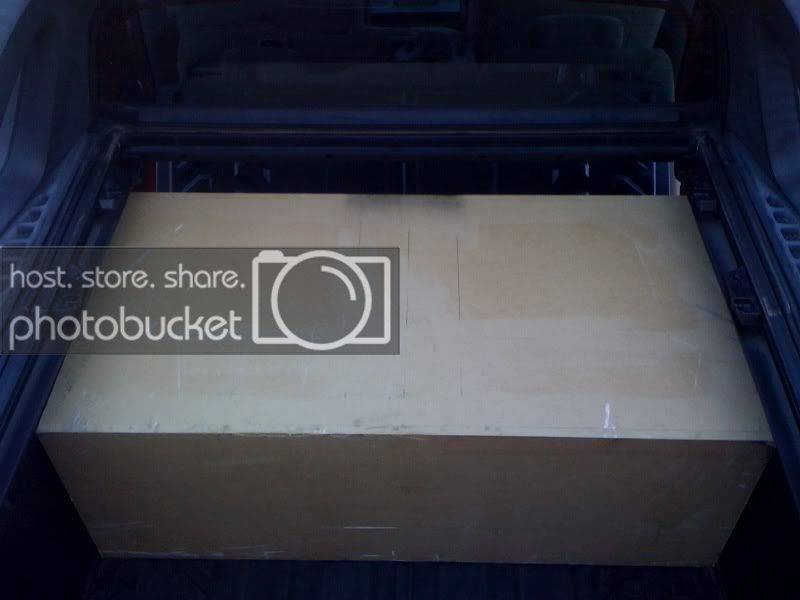

Lol well your box was literally 3 times bigger, but still. The box looks to be a pretty tight fit other than the top part. But my friend is a total noob to this stuff so maybe its user error haha! Ill go look at the box in person later today or tomorrow.

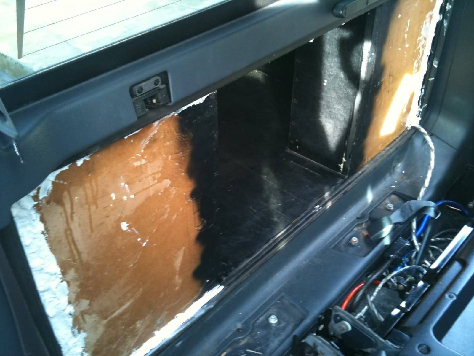

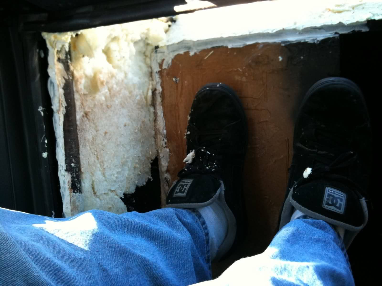

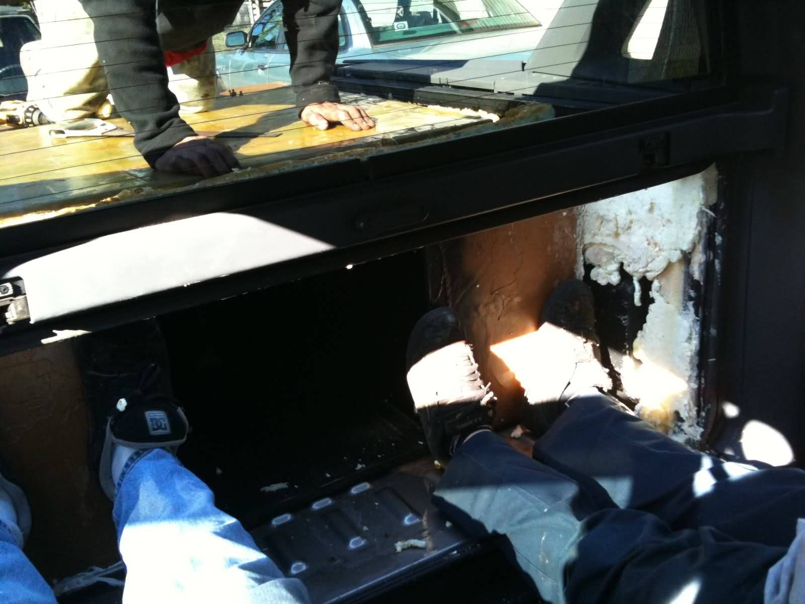

This is my first blowthrough, 2 18s in a 4th order. Was 49 x 21.5. You can see the amount of foam I used to seal it. This is when I was taking it back out. Had to saw through the foam with a handsaw. The really white stuff over the foam is actually some silicone. I went over the foam with a ton of silicone to help make sure it was sealed well. Then I glassed over it on the outside. It was sealed great.

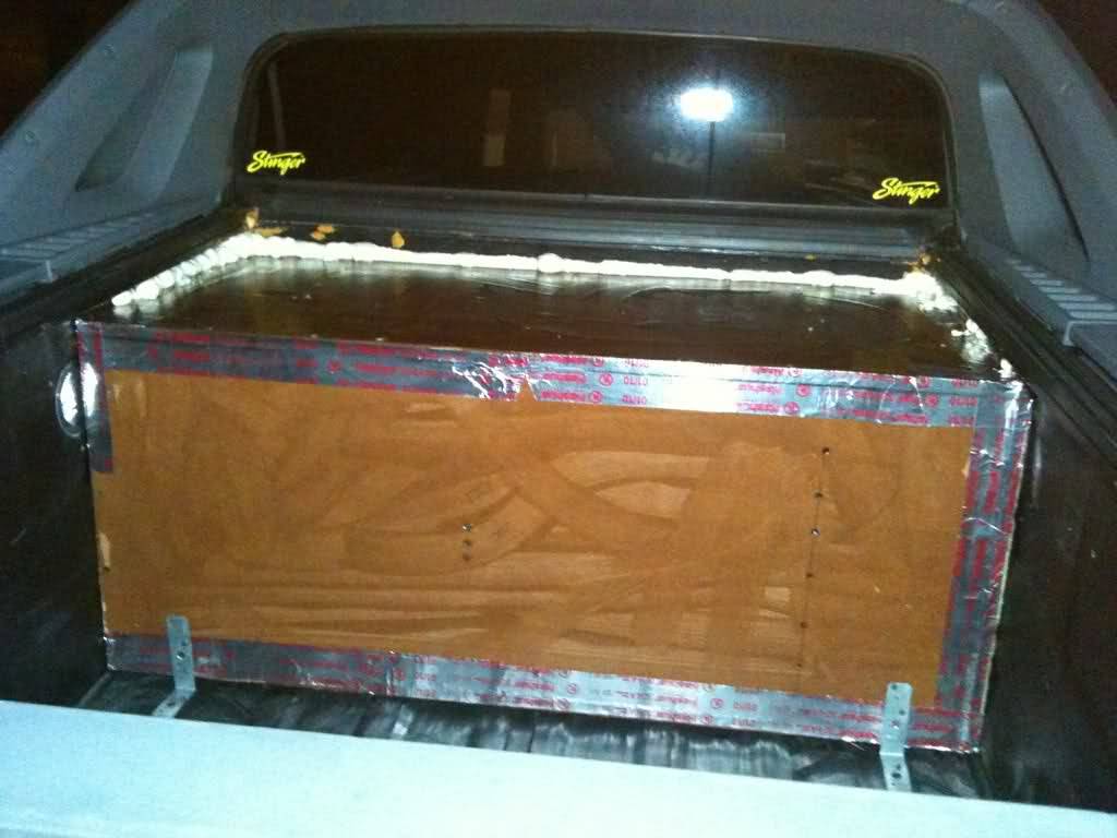

This is the one I have now... Single 15. Box is .75" wider. This was the first can of foam. Went back and used another 3 cans to finally seal it. Still think I might go back and put some resin where the foam meets the truck to really seal it like my 2 18 box was.
i would build a rectangle piece out of angle iron to screw/bolt in the truck, sealing the outside of the frame with thick beads of silicone.
then i would slide the box into it with a big bead of silicone inbetween the two. and screw/bolt the box to the metal frame, then bolt the box to the bed of the truck.
