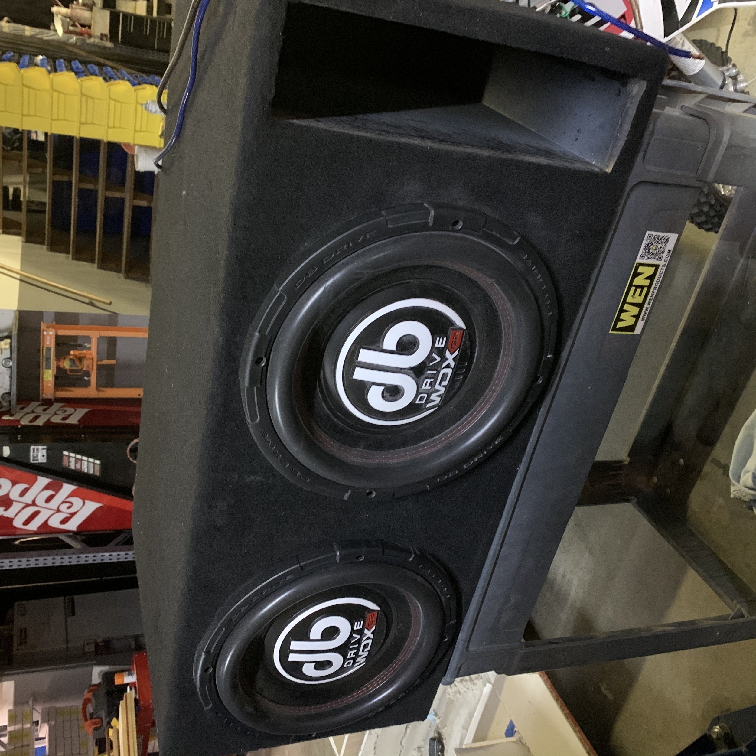

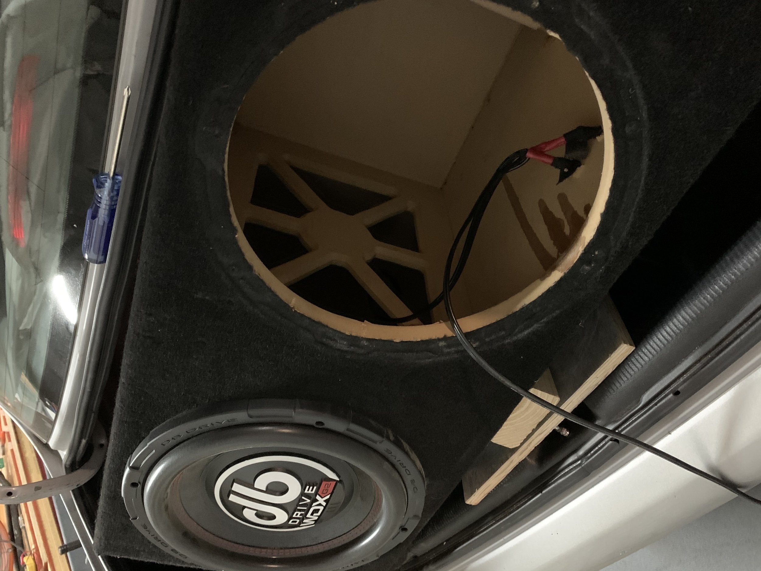

I wanted to add this after rereading everyone's suggestions here's my current box not sure what's it tuned to as I bought it with the wdx's from someone. seems like a solid box?? What I've gathered is basically invest in taramp or equivalent which will get me to where I'm trying to go, along with electrical upgrade big 3 ect ect.. Also I'm currently running a pioneer 4300bt and a sound stream eq. Forgot to mention that.
