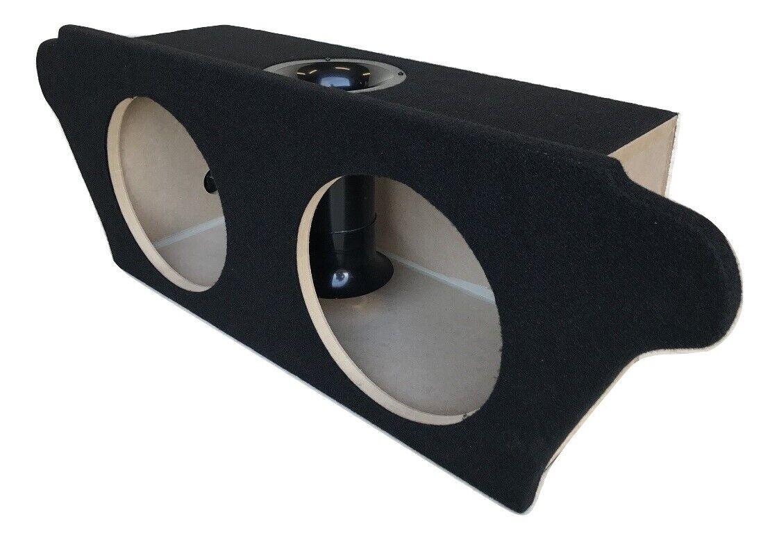

This is what I really wanted. But if I’m going ported I would probably have to extend it out toward the metal holders right there which isn’t an issue. Just wondering if I’d offset the woofers and slot to the right or slot through the center and two separate chambers.
Or aeroport towards the top so it kind of aligns with the original sub opening?
See how this one is ported for the IS lexus’

Gee... I wonder if a pair of 10s in a 4th would work? Plenty loud in my experience with punchiness and a sealed type response. A decent designer could ratio the peak giving a smoother response. Also that skipass is the perfect size.
Another option is to do a trunk baffle instead of a box.
If you keep the skars I'd go ported. They don't make anything that'd do great sealed so you'd just be sacrificing output for nothing imo

Sooo still between sealed and ported... Ported requires a lot more room. I feel like I could be able to fit a bigger sealed box that may play flat and lower, just afraid to loose any sound that is mainly prefered with ported since I've never heard a sealed box before.
If it's possible man...try to find somewhere where you can listen to different setups before buying.
