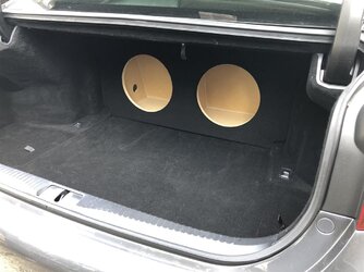

Yes I currently have the ski pass open and there is a 9/10” opening where the factory sub used to be.

That’s what I’m thinking if I should just build a custom ported box. However the subs I was looking at require a lot of air space 2-2.25 ft3 each and the box would be quite large and I can’t shape it to my trunk quite how I’d like. Wondering if I should stick with a higher model Skar instead of the American Bass XR’s I was looking at.
This is what I really wanted. But if I’m going ported I would probably have to extend it out toward the metal holders right there which isn’t an issue. Just wondering if I’d offset the woofers and slot to the right or slot through the center and two separate chambers.
Or aeroport towards the top so it kind of aligns with the original sub opening?
