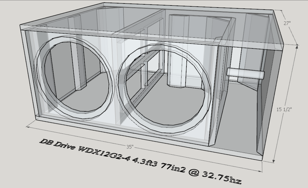

I just finished a design for what are exactly identical to your subs Op. After modeling em up I feel your Wdx aren't all that bad anyway. I mean hell... I recommended a legit 3-3.5k for an upgrade to the guy it's for. Anything that can use a box like this isn't half bad imo.
