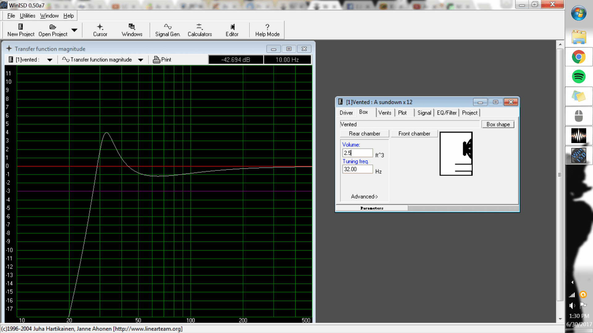

Thanks... I had to sleep at some point... OK... I changed the option I missed and managed a complete screenshot then came up with this...
I was driving my self crazy at first until I realized it was only for 1 driver... I was thinking it was 2... anyways as I started to get closer I was seeing a slight bump at tuning but saw no REAL low frequency extension... Then I remembered the these older CV Strokers only went so low and were peaky at tuning anyways... but I'm sure that a better curve is easily attainable... I had 2 15's in 8 ft3 net with about 90 in2 tuned to 36hz in 1997 and it sounded smooth and went lower than anyone I met... but this WAS 1997... I guess it is all subjective... I did try to EQ the darned thing with an RTA but went by ear after all as it sounded terrible. OK... this is the rear port velocity graph...
What am I looking at exactly?
Thanks... I had to sleep at some point... OK... I changed the option I missed and managed a complete screenshot then came up with this...[/img]What am I looking at exactly?
so the gist of the rear air velocity is to be under 30 meters per second. In the options your range only goes up to 18... you arent gonna read anything like that. Go back to my options and copy it properly.
You'll have to go to the input power and enter in a number and see how that changes air velocity along with your port figures.
