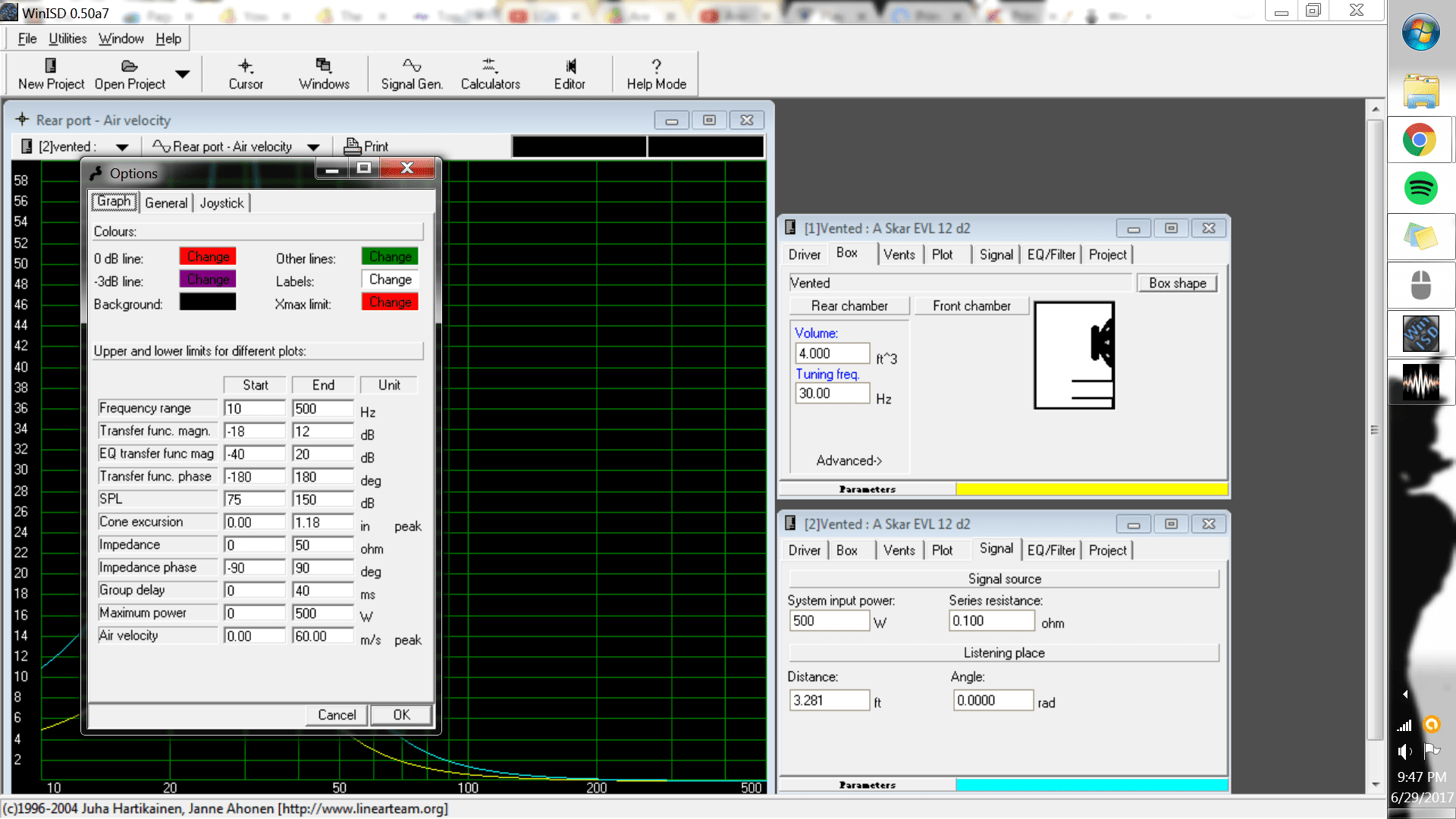

now to optimize your ranges, go to your options and set it up like mines. so you can actually see your sh*T where it says m/s you can click the m/s and it'll change to ft/s you can do the same with any of the values. when entering in ts specs make sure you have the proper value in meters or liters or cubic feet or N/A
I think I got the options to take... I tried to screenshot all of it together like you did but only got this...
... I was looking at a transfer magnitude graph with driver,box,vent... etc all together when I tried but got only the options as you saw... how do you get the box and vent sections to display in separate windows at the same time?.. and get a screenshot of it all together like you did... I tried 5 times BTW... Yeah.. I almost forgot... I did carefully enter parameters using the proper measurements and changing the type of value when needed...
go to options again and where it says air velocity. CLICK the FT/S yes click the tiny words. It'll turn to meters per second.
You can do this with ALL the tiny words values. even in the TS specs.
