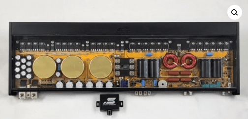

I’d never buy that rebadged Chinese amp. Don’t care what small changes were done that thing isn’t worth it . I’d 100.% rather buy a Korean class A/B or a true high end class A/B.
Edited to add: I get it though, I know that amp looks delicious, gives that old school quality feeling, seeing T03 (these are old and most are actually fake, TO-264 is what is considered better now, T03 is obsolete to be honest), but don’t be fooled.

Nothing wrong with running at 1 ohm, you will gain it way down anyway to limit the output. Amp will run cool and never even break a sweat. The wolfram amp Is the best deal on the best Korean offering. $699 compared to $850+ from others who are selling the same thing.
I'm pretty sure the si amps are Korean amps and they test incredibly well.
There is a copy cat china made though that looks very similar
Those China “copy cat” amps were out before Si. I don’t know of any of the top two build houses in Korea (S&I and Zenon) that make something like that. The Chinese amps test perfectly fine just they overrate them. Not hard to rebadge and underrate or rate them accurately. Soon as those amps were being released damage control was put forward to get some YouTube dudes to talk trash about the Chinese unbranded version. Si doesn’t buy amps from Korea, I know this as I can see every single shipping container that every brand imports here.

Here is all you need to know about that chinese knockoff, it's not even close.
