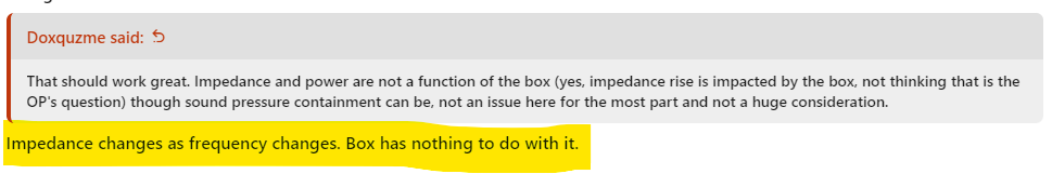

That should work great. Impedance and power are not a function of the box (yes, impedance rise is impacted by the box, not thinking that is the OP's question) though sound pressure containment can be, not an issue here for the most part and not a huge consideration.
Impedance changes as frequency changes. Box has nothing to do with it.

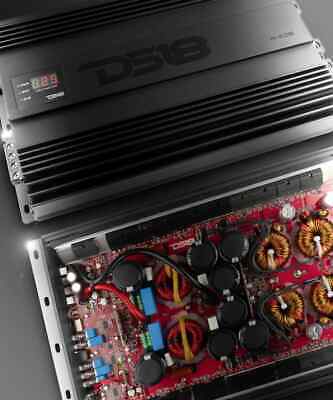

Do you think this will be underpowered for my subs? Rated 1500w @ 4 ohms:
RF makes amazing products (minus their cheap prime and punch garbage), and they are consistently underrated. Has your budget changed? If you can afford it and don't plan to ever go bigger subs, this amp will serve you well.

Correct me (again) if I'm wrong but the impedance shift is highly dependent upon the enclosure and how the enclosure interacts with the vehicle it's in which means that there's no way to really calculate what level of rise you will see before the system is installed. So while yes, rise is a function/reaction to frequency, the box you put it in is part and partial to that equation. I suppose it would have simpler to explain that the first time around, there is that...
