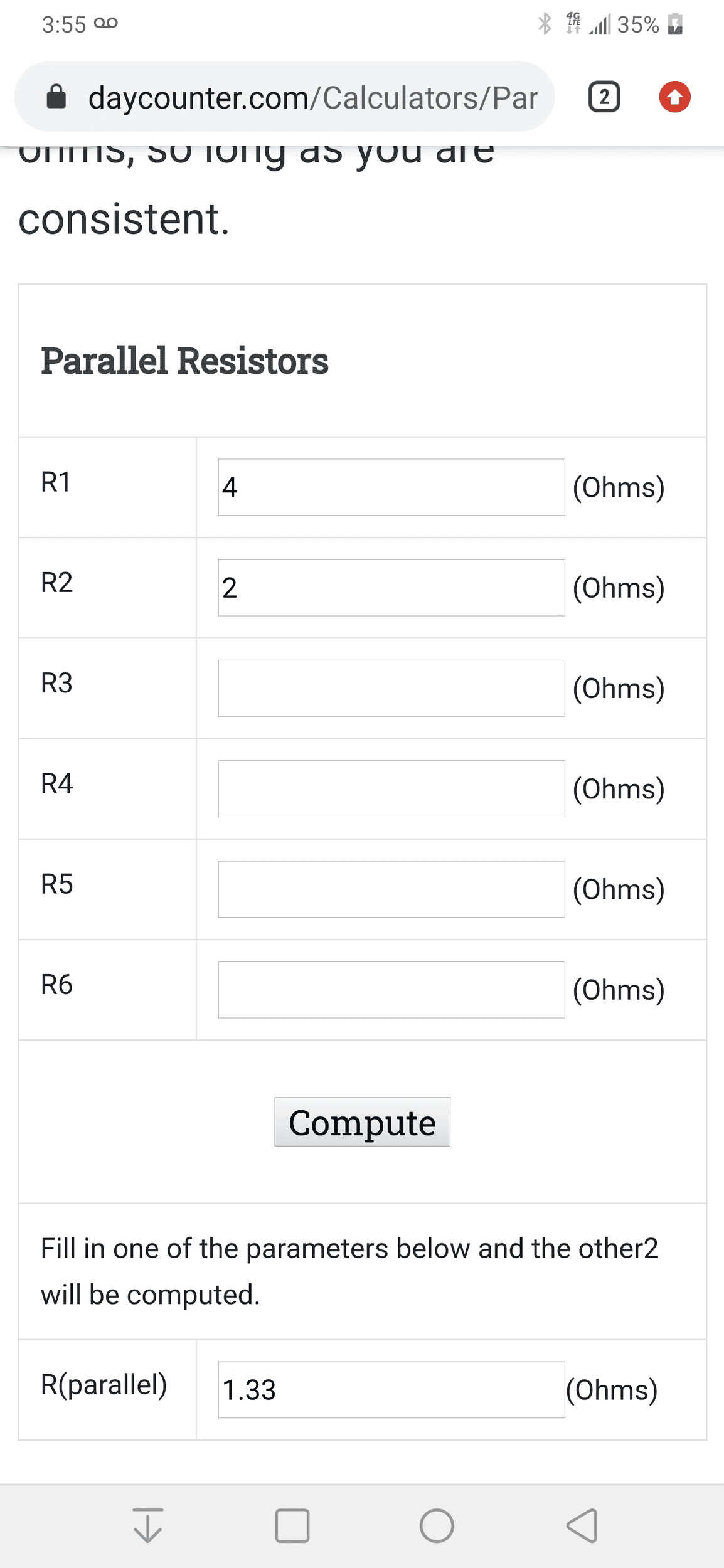

Light bulb. 2 and 4 Ohms parallel gives you 1.33 Ohms, not 3 Ohms.

so since my subs are not in the same box and are far apart, I wired up my L7S 4ohm to a 2ohm load and my ls7 r 2ohm to a 4ohm load. That will give me 3ohms? So I have the right idea then?
If you wire them parallel you'll end up with 1.666 ohms. Wire the Ls7 2 ohm to 1 ohm and run the subs in series for a 3 ohm load. Actually the best solution (IMHO) is to wire the 4 ohm sub to 8 ohms and wire the 2 ohm sub to 4 ohms and run the subs in parallel for a 2.666 ohm load at the amp.
