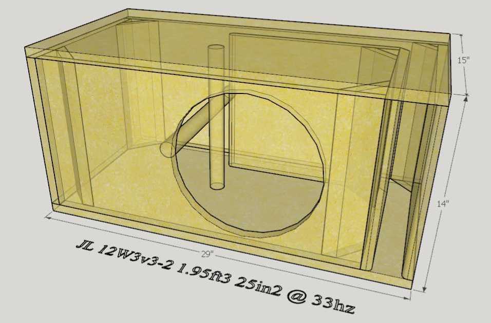

Once you get your signal chain set, from the brief look at that enclosure I got... lol... I'm pretty sure the airspace and port area/tuning can be improved upon.
A enclosure around 2ft3 tuned low 30's with proper port area ought to be a little larger imo.
Something along these lines should make a pretty big difference...

Now for the paid solutions. Your box is trash no wonder you arent getting anything out of it. You need a box literally double that size, the port needs to be double that size as well. Its CHOKING the sub to death. you are literally getting at best 20% of the sub's capabilities right now.

The sub box is 20% the problem - fix this you will smile with teeth showing
