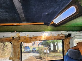

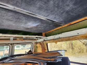

I didn't have this section at first, but now I think it's pertinent. The wiring is going. Most of it is bodged lamp cord. Like literal frigging brown lamp cord, twisty tied into crappy smashed butt connectors. Recommend anything here?
Substrate:
back speakers go into a red oak fascia, super heavy and 3/4" thick, that is constrained only by size and heating ducts.
Mid speakers go into thin wooden wall with house insulation behind.
Front speakers are in the doors, but due to excessive water infiltration could go above driver and passenger head.
There are little 3" in the dash, but they can be eliminated as they sound awful anyway.
Background: 23 years mechanic. Excellent with wiring. Audio skills and possibly ears lacking.
Time: couple weeks, need to take van for a road trip mid March. Interior is out of van, it is literally a blank canvas.

Hey sorry man, should've included more info. I am trying to make a decent stereo from what I have. I have no desire for a radio, so I'll probably use the USBC to RCA to amp that carlcam mentioned.
Cabinet is more of a facia. It has holes but will need to be widened to accommodate the 6x9s. There are heating ducts next to it.
