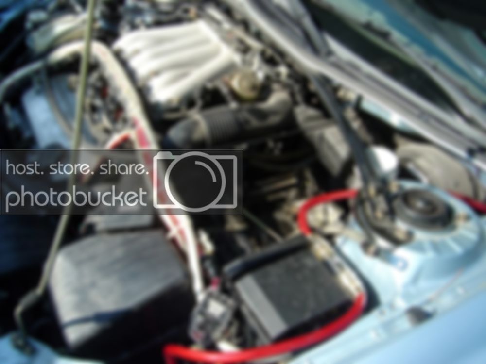

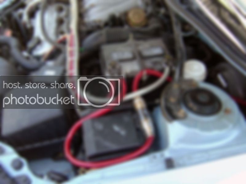

Alternators turn on at like 1.5k=-2k rpms, when they charge their output can very some have 16v, some have 14.4, batteries are normally around 12-13.8v without the alternator charging, the low rpms could be associated with voltage drops when they system is going, I once kept a cylinder or two from firing while playing and idling on a weak electrical setup.
Fixes include separating the engine electrical from the amp power batteries using a isolation relay. Try a different engine block ground, make sure all connections are sanded shiny and cleaned + tight.
here is my big three before I had a kinetik battery
